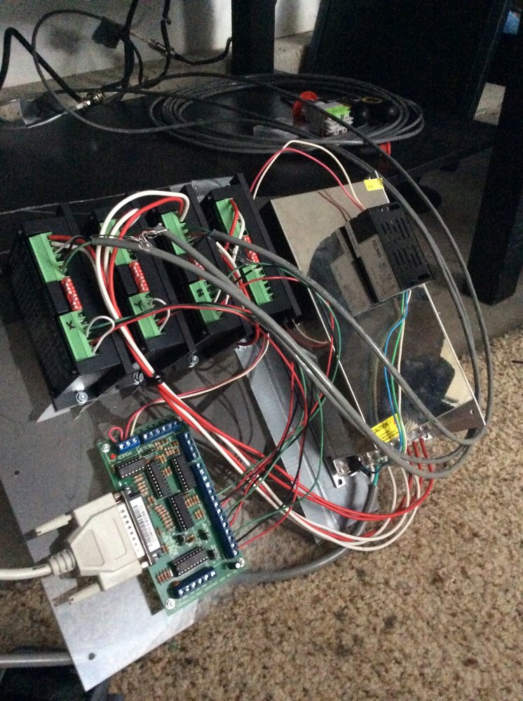

    Hey guys,
    Need some help. I've been trying to get my machine running. I've been having problems with my computer and controller. I'm wanting to run Mach3 but I can't get the ports and pins setup for my parallel port (LPT1). Here is my setup.
    24V power supply, 5volt converter box, kl4030 drivers, C10 controller.
    My computer is running Windows 7 32 bit.
    Not sure why the parallel port is not working correctly, but I think I might just take out the C10 controller and buy a different motion controller that has a USB port. They vary in many different sizes and prices. Would anybody have a recommendation on a good controller that would work for mach3 and my current setup.
    Any help would be greatly appreciated

    check the port settings in device manager, its been a while since I used a lpt port, disconnect the steppers from the controller and check the voltages and current draw of the 5v

    Why am I still seeing parallel ports in use. They have not been standard equipment in computers for ten years or more. And USB is so much more powerful. Just asking no flames please. Lol

    Because the industrial cnc machines still use it as a standard - new machines are network based and usb for local control - we where binning parallel printers 16-17 years ago and those HP printers that could take it got a upgrade card or a JetDirect card until they died completely with 8-900 k pagers through them
    saying that there are companies out there using dot matrix printers with usb to parallel adapters
    edit, a Arduino uno with grbl will pin out directly to the stepper drivers (5v logic) - a really low cost upgrade
    I run a Dm524 for the 2 y axis motors on my c-beam this way
