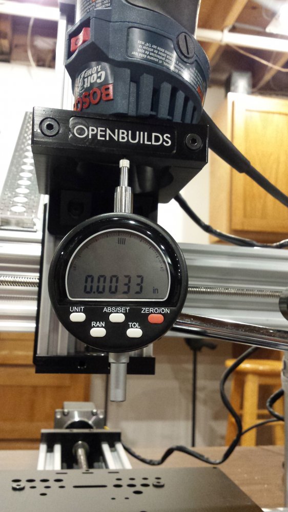

    I was doing a test on my C-beam machine to check how much it deflects/rotates due to the weight of the router/spindle. I have the Bosch Colt. (I also purchased a 65 mm diameter 1.5 kW spindle but it's too heavy in the C-beams current state.)
    I'm using a dial indicator to check deflection. www.amazon.com/gp/product/B004E8E5PK
    I've removed the router and tighten the clamp all the way so it's not loose. I've placed the dial indicator under the front of the clamp. I zeroed it with no router, then placed the router upside down to sit on the clamp. The back side of the Colt is flat so it makes it easy to rest on the clamp. The Z and X axis were in the middle of their travels for this test. The dial indicator shows it moves 0.0033". If anyone else has the tools to do this test with the Colt (same weight as I'm testing) I would like to know your results.

    I completely agree with you. I was hoping someone else could perform this test so I could compare it to what I got in case I've incorrectly tensioned the extreme wheels or have some other issue. Either way I can track it down and as you say can make my own improvements.

    Was wondering if you had tried that test anywhere else? For example under the x cross member, or under the z gantry plate. Just to see where the flex may start from and then work your way backwards?

    As a matter of a fact yes. I put an extra temporary beam on the gantry to have the same cantilever as the spindle mount, but all forces are directly on the gantry (x-axis c-beam). The weight of the motor was placed on the temporary beam, but I still measured under the mount. This removes the effect of the extreme wheels and all that related coupling. Instead of getting 0.0033 I got 0.0010. The temporary beam was not on center because that's where the z-axis assemble was during the test. So it's right up next to it about 1 mm away from its side. Also I placed the weight on the gantry directly and the change was in the range of 0.0001 which is very small.
    A good chunk of the 0.0033 change is probably coming from the extreme wheels. About 0.001 is coming from torsional twisting (not deflection) of the x-axis c-beam. Maybe more since the temporary beam was not on center, so like maybe 0.0015. I'd have to go through the math. That's twisting, not deflecting. Something very different. I've been busy with other projects so haven't spent further time to prove/isolate down the rest of the z-axis assembly, but my guess is it's mostly the wheels.

    Thanks Bob. I have thought a few times how the z plate does seem like it could use a few more wheels...and maybe the y plate as well. Thanks for the feedback.
