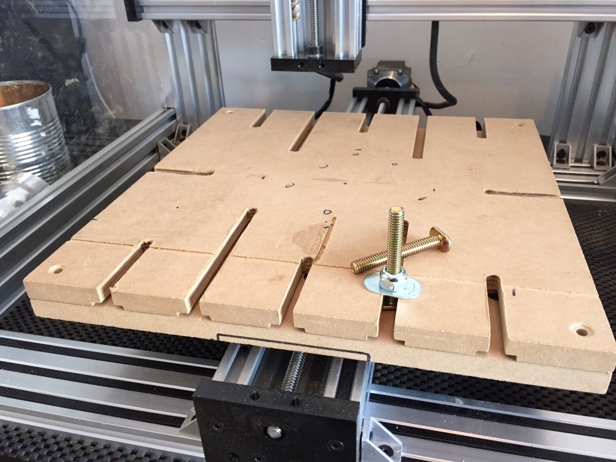

    So far I am loving the C-beam machine. It's a handy little guy. I've learned so much so far about how to mill parts. It's a great first machine.
    My first real cut was on the actual spoil board. I bought some toilet flange bolts and ended up milling a t slot for my tooling table. One thing I couldn't figure out was how to hold things down. I tried clamps and they just get in the way. So I designed this.
    I haven't actually put it to use yet but I think it'll work pretty good. I do however, have to cut the flange bolt smaller. I believe it's 2 1/4" tall. If I cut a quarter of an inch off, the Y Beam should clear all my hold down bolts. Hoping it works, if not, it was a great first project regardless and I learned a lot.

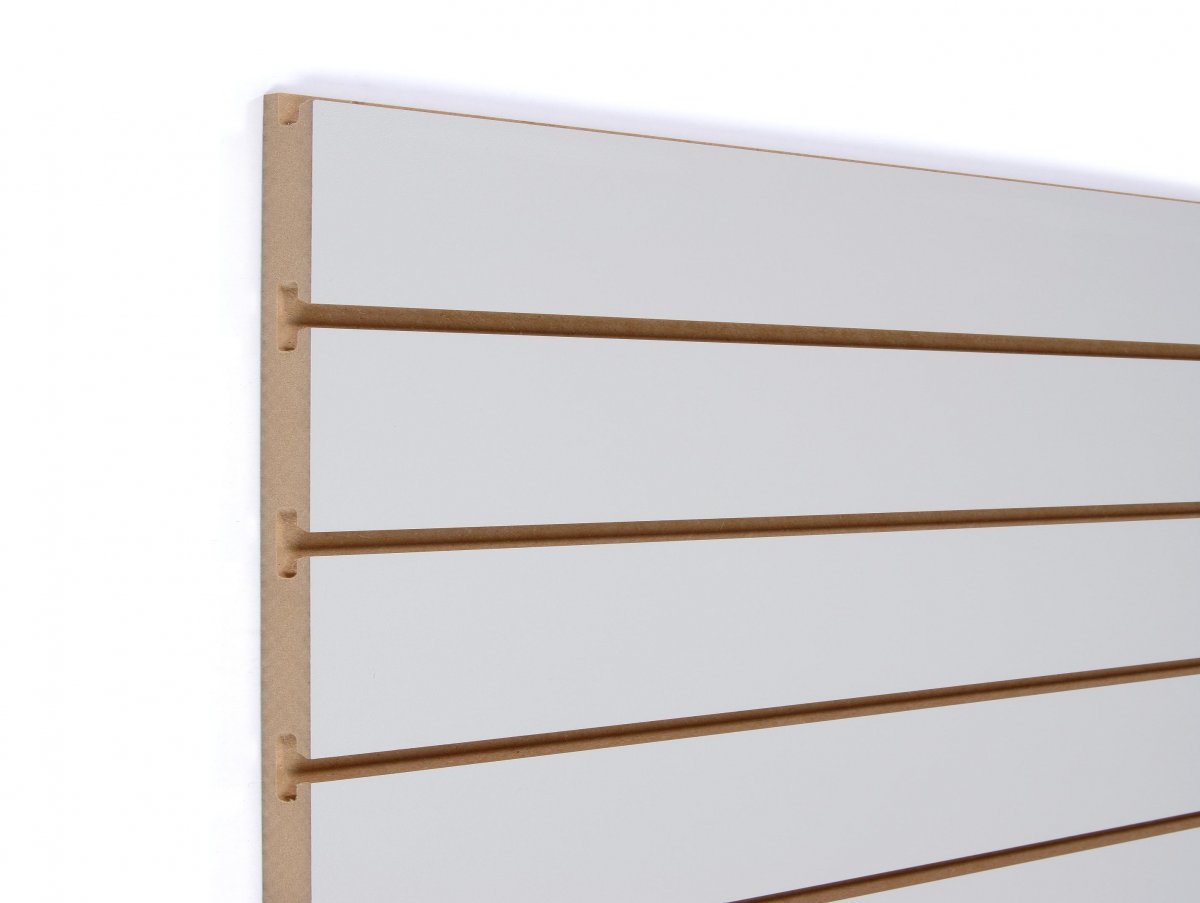

    I have found this product which I might try, called slatwall in the uk, its used for shop displays. Image16_4b54c227b9522.jpg
    Anyone used it already?

    Looks good. Only thing you will want to do is make sure your bolts are lower than you bits rapid travel heights. Otherwise you may crash your z, spindle or bit.

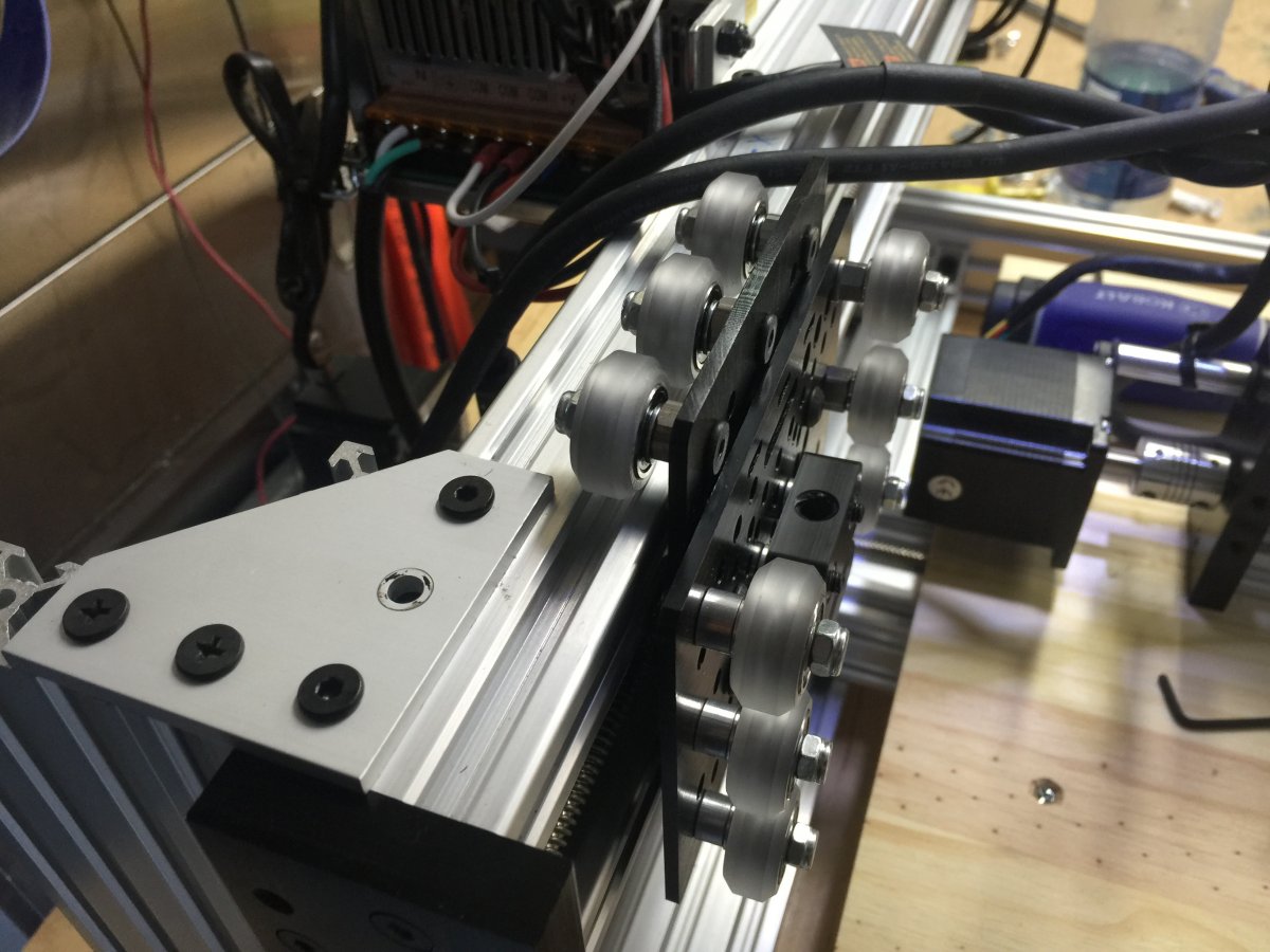

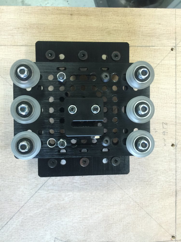

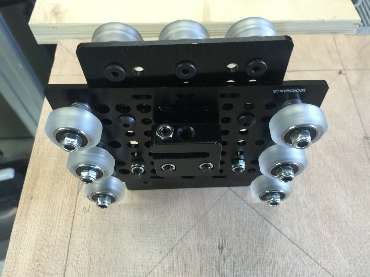

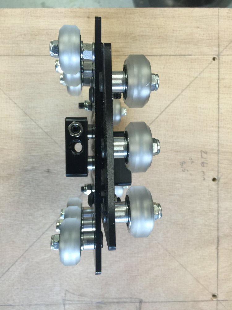

    Finally getting around to building my C-beam machine bundle I picked up a little while back.. So far everything seems to be going together smooth. I got the Z-axis done before dinner today.
    Having everything bagged and labeled by each axis really helps in getting what you need for the next step.
    Getting ready for assembly.
    This is how far I was able to get today. I know not much, I plan to do some more on the X-axis after dinner. The Y-axis will need to wait in tell I can get to HD to grab the mdf sheets.
    I had no problem with the lead screw to bearing fitment. I did not even need to sand down the screw!
    The Z- axis gantry plate seemed to move up and down a little rough when moved by hand during the preloading wheels stage. Otherwise everything seems smooth when turning by the leadscrew. ( hoping I did not get to much preloading, I tried to match the Vid. )

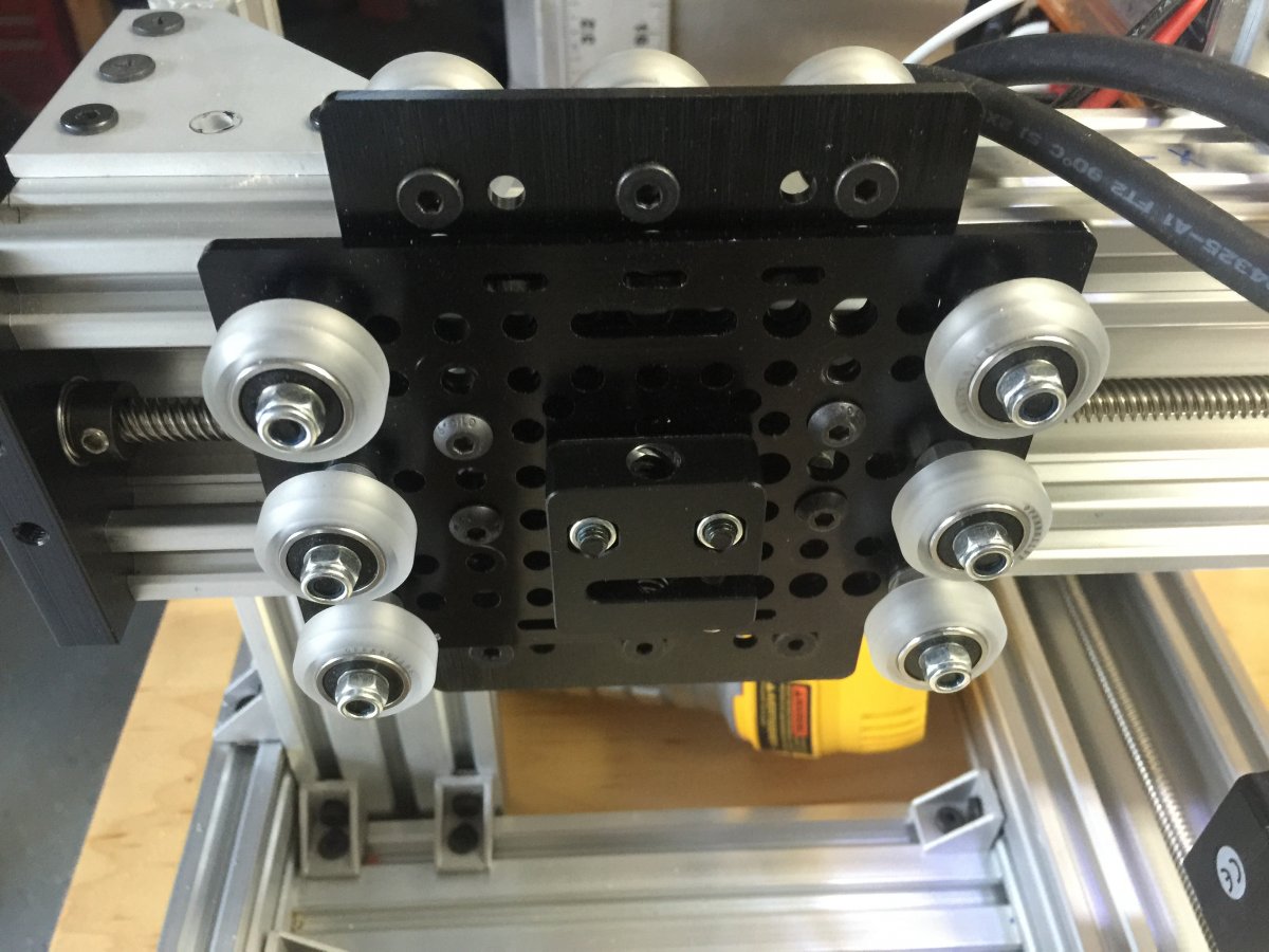

    It is going together really well! I changed a few things today. Mainly I lowered the X-axis gantry plate to be level with the Z-axis cbeam plate vs level with the cbeam itself. This should net me a 1/2" more clearance.
    I also had to rethink how to install the router mount. Pulling it down while tightening the bolts did not keep it very square for me. What I ended up doing was using a spare piece of V-slot and the Z-axis as a vise and soft jaw to keep the router mount in line and square to the z-axis. Here is a little video explaining what I mean.

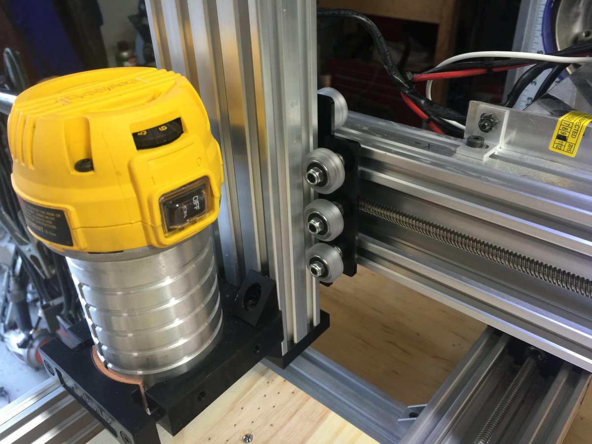

    Printed the required shim in order to mount my Dewalt 611. Thanks to JimmyBuckets..
    Assembly is complete! This has been a really easy fun build between Marks videos and how well the store crew packages and labels everything. Everything has gone very smooth.. :thumbsup:
    Note: The shim will sit flush on the mount. It seems the 90 brackets interfere with the shim top ring just enough on my print to prevent this. Does not seems to bother anything..
