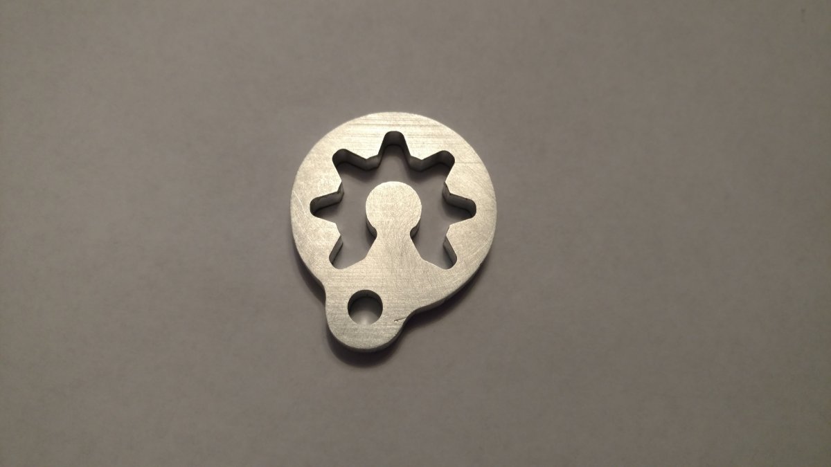

    Chomping away on some 1/4" 6061 Aluminium plate. :thumbsup: @Mark Carew and the crew hit the nail on the head with this little c-beam machine. I now really need to build a enclosure and print my case for the power supply and electronics. For the enclosure, I think I am going to do something along the lines of what Winston Moy setup for his S3.

  11. Kyo
    Kyo Veteran
    Feb 27, 2014
    674
    707
    Thanks guys, Here is the Sketchup file I made for the key chain as well as a exported dxf.
    Cut settings were.
    16,000rpm
    40ipm
    0.015" depth of cut
    40% Step over
    Endmill used was.
    1/8" flat nose single flute upcut carbide.
    Sadly, while it started off great. towards the end it decided to veer off course and ruin the piece and break my endmill. Not sure if g-code issue ( sketchup file and sketchucam ) or hardware / communication. ( X-pro / GRBL Panel )
    #911 Kyo, Mar 2, 2016
    inhan and eddiejr like this.

  19. Kyo
    Kyo Veteran
    Feb 27, 2014
    674
    707
    Yes, well another version of the keychain. It seems to have helped a great deal. I adjusted my settings slightly and this time I held a vacuum hose close to the cut to help clear the chips. After a really quick sanding top and bottom to remove the scratches that came on the plate.
    I am as happy as a kid in a candy store. On free candy day! :D I have a feeling this is going to be just as if not more addicting then my 3d printers...
    New video. Towards the end of the clip I panic for a sec. I forgot to include the tabs to hold the part in when cutting so the part almost got flung right out by the endmill :eek:. The attempt below the one I am cutting in the shot, was with lubrication, It got all sorts of gummy.
    eddiejr likes this.
  20. David the swarfer
    3,604
    1,977
    the Gcode is good, but you do need to turn on ramping when cutting aluminum. this greatly reduces the stress on the bit. eyeball the angle on the end of the bit and ramp at a little less.
    (oh, just watched the last video and see you do have ramping on now, but without limit. you will need a limit angle if you switch to a plunge hole as I mention below)
    and for the hole, use a plunge hole. if a plunge hole is larger than the bit diameter, and ramping is on, it will cut as a helical spiral and never plunge straight down. one big advantage is that it will cut faster than an inside cut in a circle since it will maintain the ramp angle rather than strictly obey the multipass depth.

  21. Kyo
    Kyo Veteran
    Feb 27, 2014
    674
    707
    Thank you for the advice, I measured the angle as best I could and did a plunge cut. It definitely helped. This time it came out! A Little bit of hand file / sanding to clean up the tabs left after cutting.
    I added it to the resource tab if anyone else wants to give it a try in the future. ( I figured after a few pages pass having it on the resource tab would be easier to find then digging for the file here )
