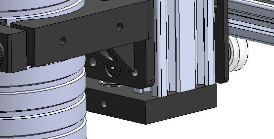

  22. Brandon Raineri
    Dec 16, 2015
    Here are my actually measure values, I'm not sure what you are using for your steppers so I will give both dimensions to the end of the 40mm spacers and to the end of my steppers. I am using 179ozin steppers. I do not have plexiglass side shields installed. I would add a 1/4" to 1/2" to my measurements to be on the safe side:
    X-Direction --> 22 1/4" to end of 40mm spacers --> 24 1/2" to end of stepper
    Y-Direction --> 22" to end of 40mm spacers --> 24 1/4" to end of stepper
    Z-Direction --> 17 3/4" to end of 40mm spacers --> 20" to end of stepper (my z-axis is mounting like image below)
