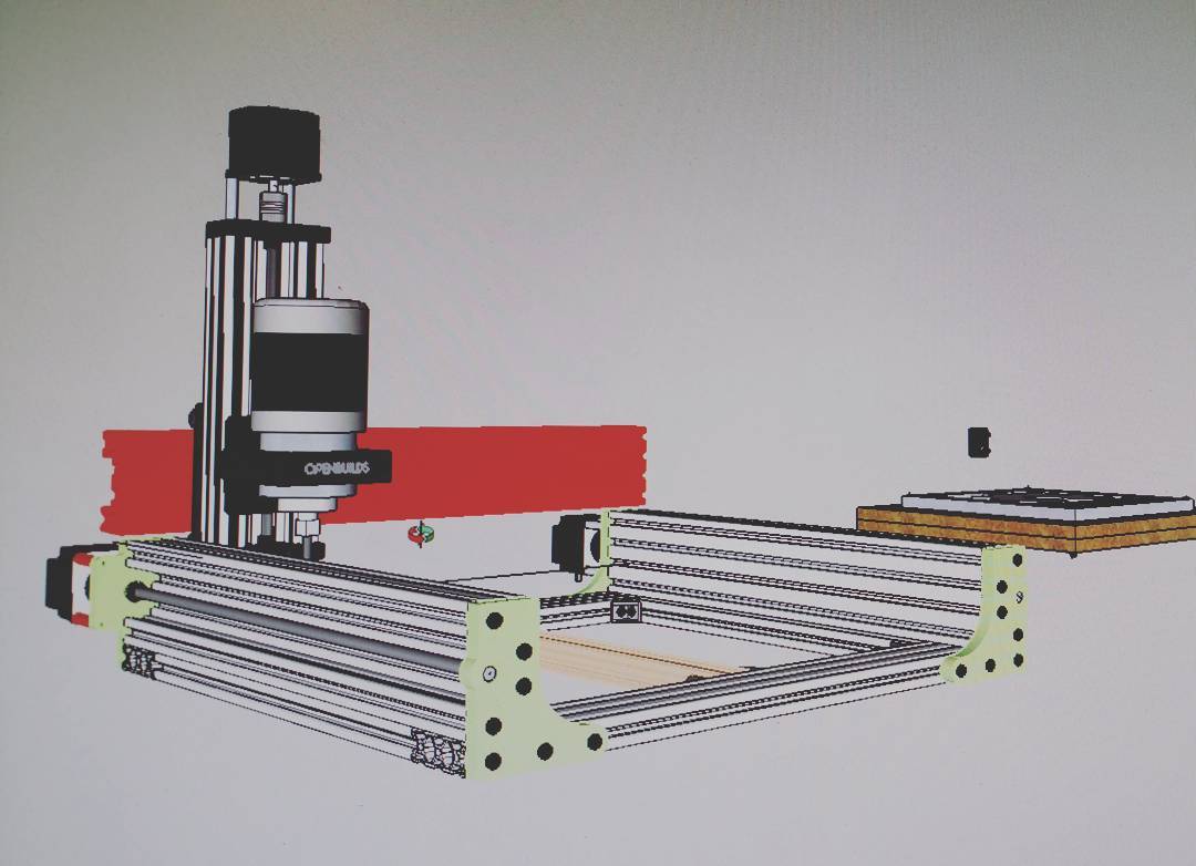

    It is on my youtube "Here" I am extremely happy with my c-beam it has been cutting 1/4" aluminium and wood almost non stop since I have built it. Check out my gallery! The two problems I am tackling with this remodel are bed deflection on the outside edges when cutting larger thicker aluminum plates then the machine was meant for and increasing the cutting area as much as possible. Both have been approached in different ways already and all seem to work really well. Such as Teflon4's build and Fred Quarles..
    I am taking a more Ox / R7 inspired approach and going with a fixed bed. I am also going to use the C-beam machine it self to make the needed parts and provide the needed components so the remodel will require few to no additional purchases.
    Not shown in the above images / youtube video. The Z-axis will be getting upgraded as well with the cool new parts OB is putting out. :thumbsup: Just waiting for the files for all the new plates to come out so I can model it up first.
    #1102 Kyo, May 20, 2016

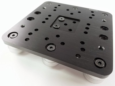

  23. Mark Carew
    2,785
    2,490
    This is going to be a really nice strong Build @Kyo looking forward to seeing it all come together. :thumbsup:
    Example Build files have been removed (we want to make sure everything is right) to allow us time to release this new amazing router as a Bundle Build soon! :thumbsup:
