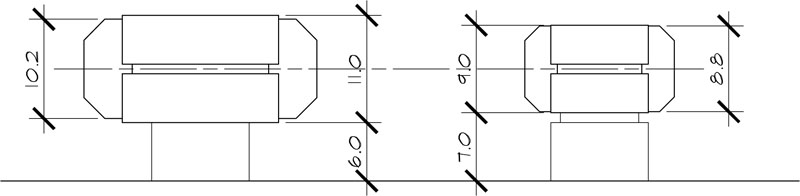

  7. Chris Laidlaw
    Chris Laidlaw Well-Known
    Mar 1, 2014
    77
    27
    Where do you get this 1mm shim?
  8. Kyo
    Kyo Veteran
    Feb 27, 2014
    674
    707
    The OB parts store carries them. "Here"
    #1118 Kyo, May 24, 2016
  9. Ronald van Arkel
    May 7, 2014
    472
    245
    It comes with the wheel kits, or can be bought at the OpenBuilds shops.
    -Ronald
  10. Rick 2.0
    2,912
    1,578

    Just to clarify...the only time you need the extra shim is when you are using the mini and the larger v-wheel together. It may seem obvious but I just figured it out after thinking I might have not put my z axis together correctly :)
