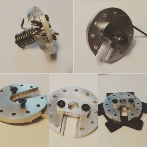

  15. Kyo
    Kyo Veteran
    Feb 27, 2014
    674
    707
    @Darathy Definitely capable of cutting aluminium! I run a Plate Maker with a Dewalt 611 and precisebits collet set. 80% of what I cut is 1/4" 6061 plate.
    To give you a idea of what I use mine to make; here are some examples.
    #1215 Kyo, Jul 13, 2016
