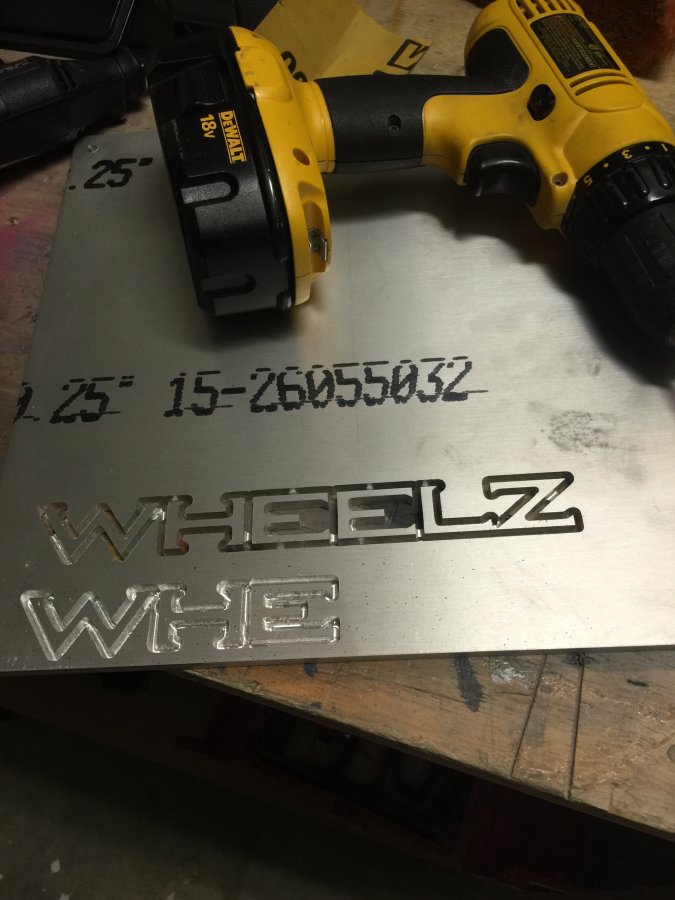

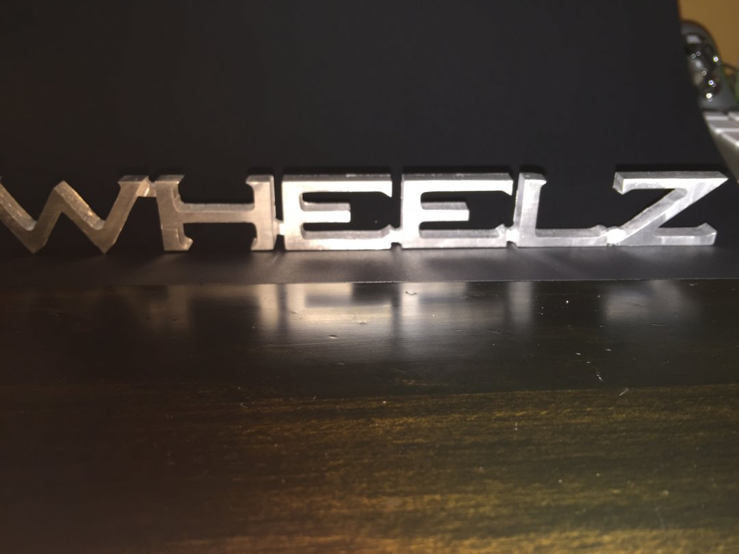

    My first time cutting 1/4 Aluminum (6061).
    Bit: Yonico 31011-SC O-Flute Up Cut Solid Carbide CNC Router Bit, 1/8 x 1/2 x 1/4 x 2"
    700mm feed rate
    0.20 per pass

  26. Kyo
    Kyo Veteran
    Feb 27, 2014
    674
    707
    Looking good Gilbert :thumbsup:
  27. Gilbert Mackall
    Jan 16, 2016
    21
    48
    Thanks!
    This forum is the main reason I was able to do this without breaking several bits before I got it right. Thanks everyone for posting detailed speeds and feeds, it helps.

    looks nice and I assume your DOC was .2mm not .2"
  29. Gilbert Mackall
    Jan 16, 2016
    21
    48
    Yup, 0.20mm :)
