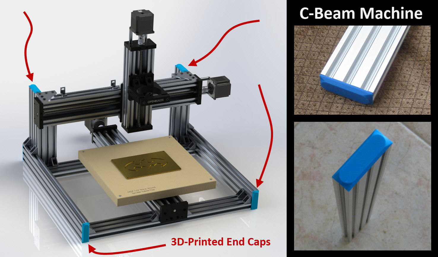

    Nice end caps! Nice and sexy LOL joking. Ironique how I got this CNC to help me cut the plates I need for my 3D printer. Ugh...trying to get it done after months of storing....
