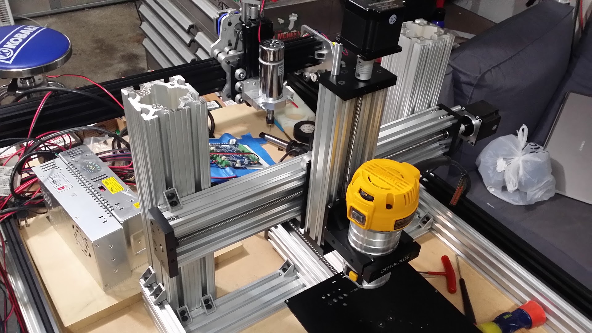

    First time poster here but I have been following openbuilds ever since I backed the OpenRail Kickstarter. When I received the announcement for the C-Beam "plate maker" it was spot-on what I had been looking for, i.e. an easy way to be able to make custom plates for other projects. That was a hurdle I was struggling with and exactly why I ordered the kit the minute I received the email.
    My goal is to be able to make small aluminum plates and brackets yet my shop space is limited to a 10' by 12' area that is already fairly packed. In the shop is a cold-cut metal chop saw, 12" **** sander, small drill press, manual mini-mill and tons of metal and woodworking tools gathered over the past 30 years. I am not limited in what I can do but more in what I have time to do, plus the mechanical is easy for me but the electronics I struggle with. The build video gave me the confidence that I would not run into a show stopper with the electronics.
    I watched the build video straight thru prior to receiving my kit, & then skipped thru it during the actual build. No issues whatsoever.
    Also have to say “Great Job”, the kit went together easily and I am hugely impressed by the pre-packaged components.. I did not have one missing screw (once I figured things out..) nor an extra one, really an awesome job putting the kit together.
    I have been sneaking up on a project like this for some time & had gathered up lots of electronics and components over time, when I got to digging around in the parts drawer it turned out I had everything necessary to bring the machine to life. I wired up an old grblshield 2.0 I purchased several years ago but never used, downloaded Universal G-Code Sender and in minutes I was moving all 3 axis.
    Couple of points of feedback, intended to be constructive:
    1. The 500mm extrusions I received were inconsistent, ranging from 498 to 504mm. Not a big deal for me as I have the metal chop saw and 12” disk grinder but it may be an issue for others.
    2. I was puzzled by needing to cut the 500mm extrusion in half for the 250mm x-axis posts, since the 250mm lengths of extrusion are available in the parts store. Again, not an issue for me but may be for others. It was also the only part of the kit that was not plug & play ready.
    3. I ended up grinding the 2 little tabs off the cast L-brackets so they sat flush on the extrusions. Would recommend this to others, simple to do & I think it provides a lot more bearing surface on the extrusions.
    Again, an awesome job on your part and the availability of the kit and the build video meant I could get a working unit in 5-6 hours with minimal hiccups – I’m very excited to put this to work.
    Here are a couple photos of the build so far, I have to add the waste board and tidy up the wiring but for all practical purposes the machine is functional.

    @Richard, yeah same thing with mine the beams weren't 500 mm so had to cut them and I also noted the thing about the 90 casts having the nubs removed, the ones on the spindle mount are much nicer. I've also been thinking about removing the 250 mm columns and using a single piece column instead.
    I've got a 1/4" 12x12" tool plate to use as a work plate instead of the 1/2" MDF since the Z clearance is a lot more limited than i thought, not sure how it'll work out though.
    here's my build
    https://hackaday.io/project/6921-openbuilds-c-beam-machine-build

    I'm using the DeWalt 611 which i'm basing that choice on on precise bits page about about the low quality of the bosch. It needs a small shim on the left/right sides , front to back it mates.

    the dewalt is 68 mm, i made a 55 mm mount for my "400w" quiet spindle, those are nice and quiet.

    i replaced the two 250mm 1x3's with some 30x30 profile. haven't finished bracketing it up yet.
