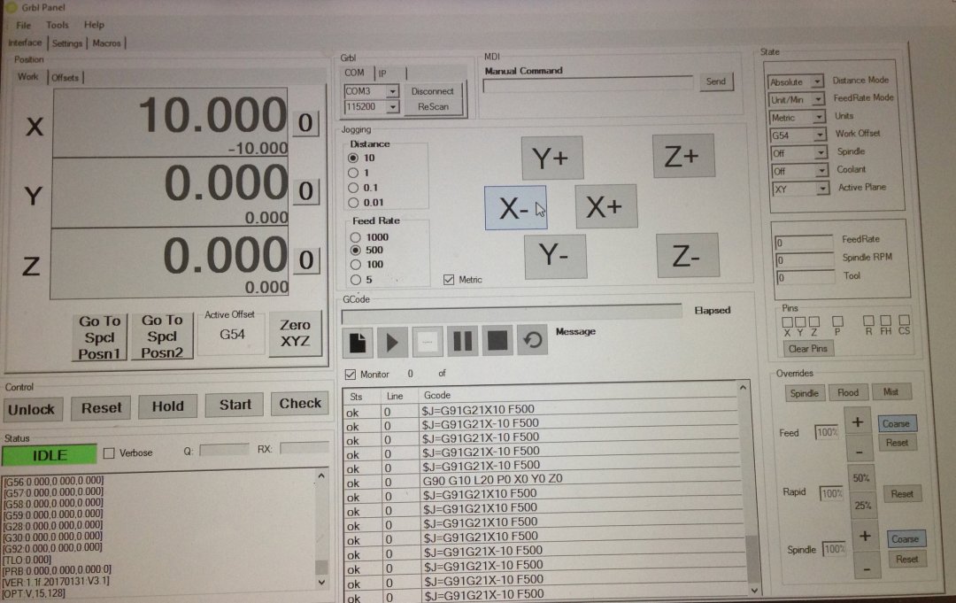

    Question/Problem: just completed C-Beam Machine build. Using grbl panel 1.0.9.15 to drive the xPro V3 board and NEMA 23 motors (standard bundle) On the initial JOG test everything worked fine, except it move 1mm instead of 10mm. Went and looked at settings and saw 200 not in the S100 field. Updated it and realized that the fields have to have a "return" in order to save the field to the board. Recall, seeing something about this in the past 50 pages herein. Updated all of the fields to match the supplied JPG listing of settings. Now nothing moves on JOG, servos stop making a hum, screen updates a new position, but the head stock is in the same location. I loosen the coupler to the servo and retry JOG and it doesn't spin without any load. I notice the servos hum when the power supply is on (I assume this is holding them in position). So where is my error or how to I get the xPro board back to the original settings it shipped with so I can try one field at a time to find the offending setting?

    new xPro V3s need to have to enable inverted - $4=1. Don't if that's your problem...

    Thanks Phil. Looking at the JPG list it shows $4 as zero, so that could be the erroneous field. I will give it a go in the morning when I get back to work. Appreciate the update. I suspect that somewhere all of these are posted for the latest versions? If so, OpenBuilds may need to update the software download folders.
  12. dekarate
    dekarate New
    Aug 9, 2017
    YES the $4 as 1 does the trick thanks again

    Anybody have a list of settings for the xPRO CNC V3 controller. Saw reference in another blog there was a magic sheet of paper sent with OX build kits that had it. I got no documentation with the C-BEAM kit aside of the packing list.
    Not getting DRO readouts, but do get work offsets. Disconnect and Reconnect does not zero the work offsets.
    Suspect its still a setting issue - running grbl panel 1.0.9.15 GRBL versions 1.1f20170131:V3.1
  14. dekarate
    dekarate New
    Aug 9, 2017
    GRBL v1.1 S10 documentation indicates there are only 2 reporting options work space or machine space, no longer both. Suspect grbl panel is behind in still trying to report both with setting value of 3 at S10. Maybe there is a better software driver than grbl?

    OK, at least I get to answer myself - RDO never reported using grbl panel under Windows 8.1 Tried loading under Windows 10 under VMWare Fusion on my MAC and it worked !!! Except I get skips on JOG commands (stepper don't move, RDO jumps forward or back and Workspace re-zeros all at once). I turned the acceleration down by half (to 50) and it seems somewhat better, but was never a problem before. Thinking it could be a lag in the USB passthru from MAC to Windows, I went back to Windows 8.1 and reinstalled GRBL Panel from same zip file as I did 2 days ago. Suddenly RDO is now working and I have a "PINS" window box on the right side that was never there under the prior Win 8.1 install. See below figure, it all looks good. However, the skip on the JOG continues to persist. This is under no load, not even a router in the tool holder. Wasn't there before and settings still the same. Tried GRBL Controller 3.6.1 but get an "error 22". 3.0 is not available for download. Mac version seems to only want connect via Bluetooth which I don't have the xPRO V3 board. Universal GCode Sender 1.0.9 seems to have Java issues. And Chilipeppr never seemed to connect to the xPRO. No jogs errors at 100 feed rate and seems to get more frequent at 1000 feed rate. Open to suggestions. Running 12V.
