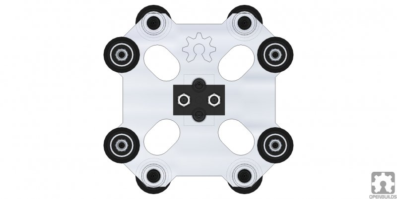

    We use 4 of the Xtreme Solid V Wheel Kit for the Y axis
    and 6 for the X axis
    We use 4 of the Xtreme Mini V Wheel Kits for the Z axis
