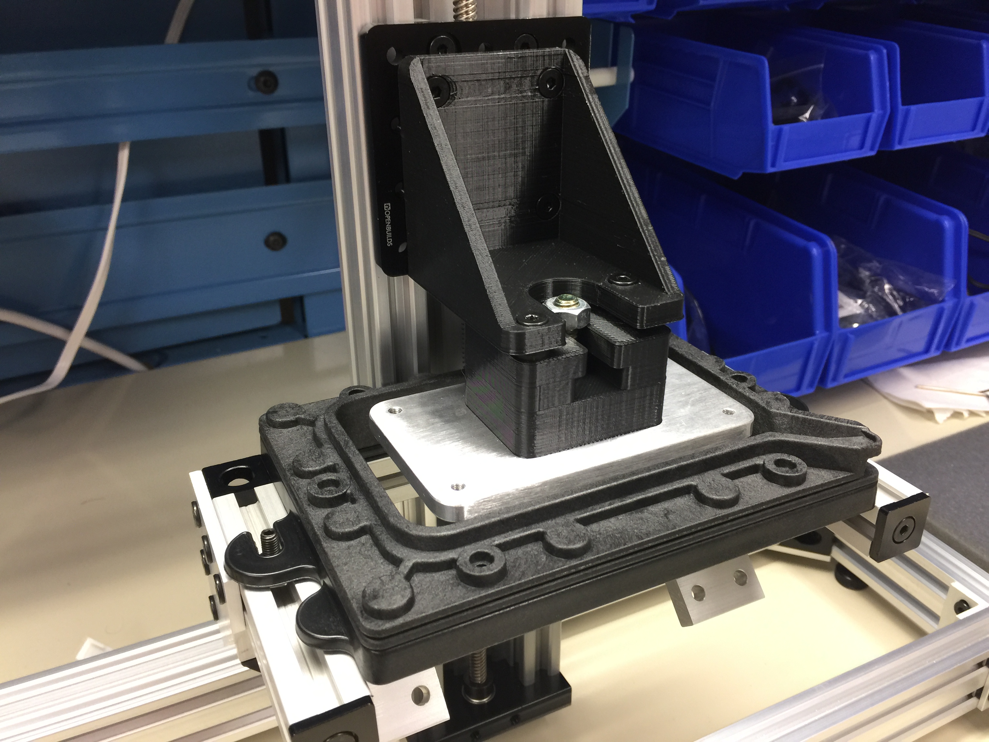

    Jan 2, 2016
    41
    37
    Things are starting to come together!
    Using the 40x40 beam for the vertical C-Beam mount works very well. It's much sturdier than the 20x40 that I was using before. There's 90% less wiggle on that part from the aluminum twisting now. I'm quite happy with it. Money well spent.
    I've got the carriage arm and leveling block installed. They're both my own design, but the dimensions of the leveling block and the block on the build plate are compatible with the stock LittleRP pieces, so I think there're some synergies there. A pair of rubber washers on each of the 3 mounting screws will squish enough to let me level the build plate. I've also designed a newer piece than what's in the picture to match the vent holes on the SeeMeCNC build plate (the LittleRP plate is what's pictured below).
    The projector mounts up as expected, so that's good. The mounting screws are an M5 thread, so I had to ream out the angle brackets just a touch to fit them, but that's no big deal. That part of the build will vary by projector on everybody else's build, so I don't think there's a need to go looking for a different part.
    Here's what the mounted build plate looks like, when it's dipped down into the build vat. It's really starting to look like a printer!
    Today's mission is to modify the projector's lens so that it can zoom a little bit larger and focus a little bit closer. That part of the build will also vary depending on what projector the next builder throws at the project, but it should be pretty easy for me. It's an all aluminum, fully threaded lens so I'll probably just have to remove some stop screws. I may even get the motorized part of the lens to work still. Heck, maybe it'll even be motorized and let me index it still!
    After that, it's all about the electronics. I'm thinking about making a single sleeve to hold the Raspberry Pi and Arduino + Shield. If I get that all mounted, it's time to learn the ins and outs of NanoDLP. Luckily, there's plenty of room on the back of the C-Beam to mount it all.
    Wish me luck, I'm trying to finish the build this week!

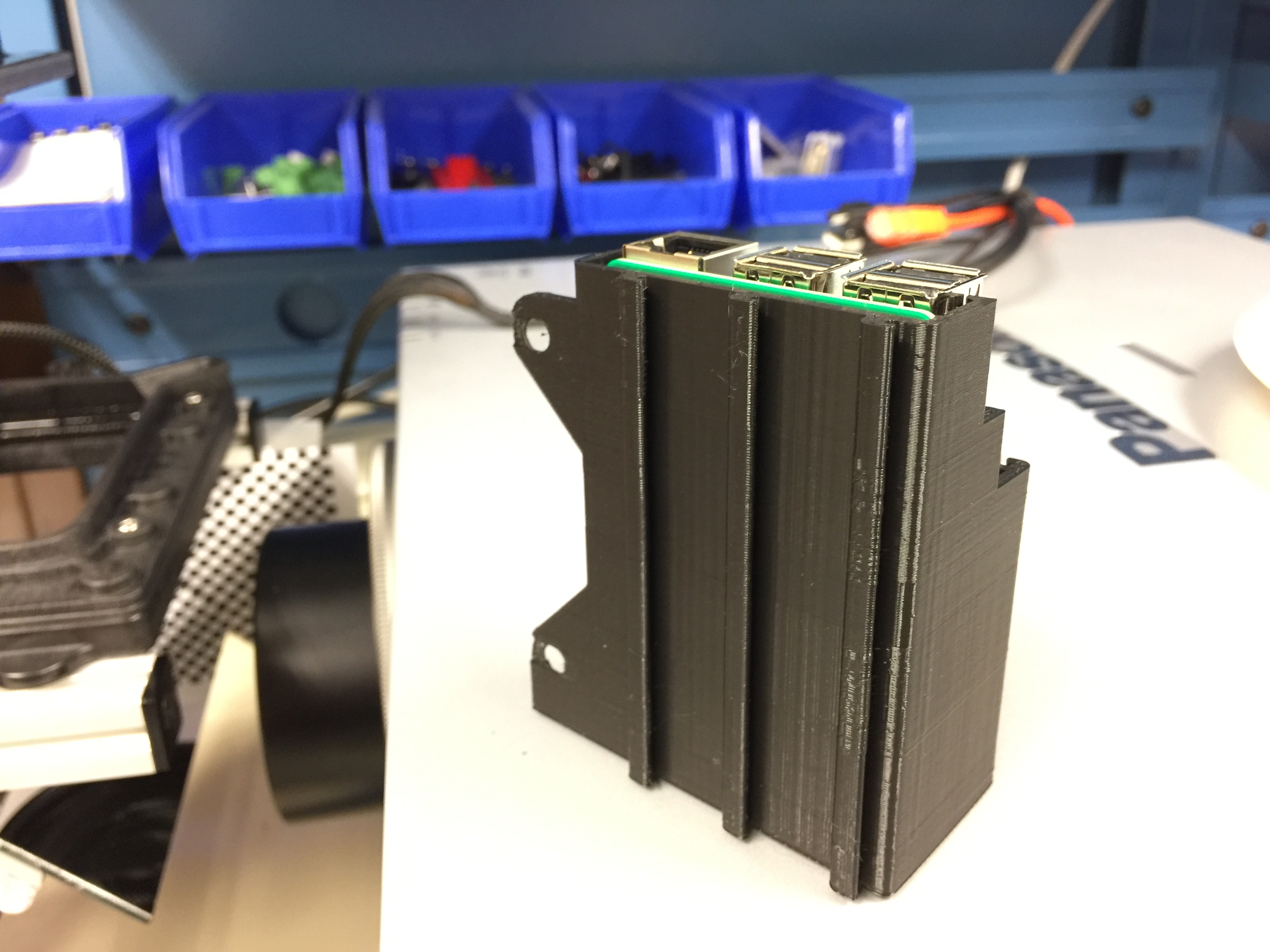

  19. Jim S
    Jim S Well-Known
    Jan 2, 2016
    41
    37
    I made a Gerbil Tube for the electronics (raspberry pi for NanoDLP, and an arduino running GRBL plus a motor driver shield) ... Still need to add mounting holes for the C-Beam, but at least it all fits!
    I should have the machine moving that afternoon.
