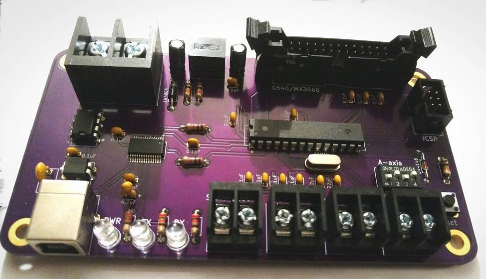

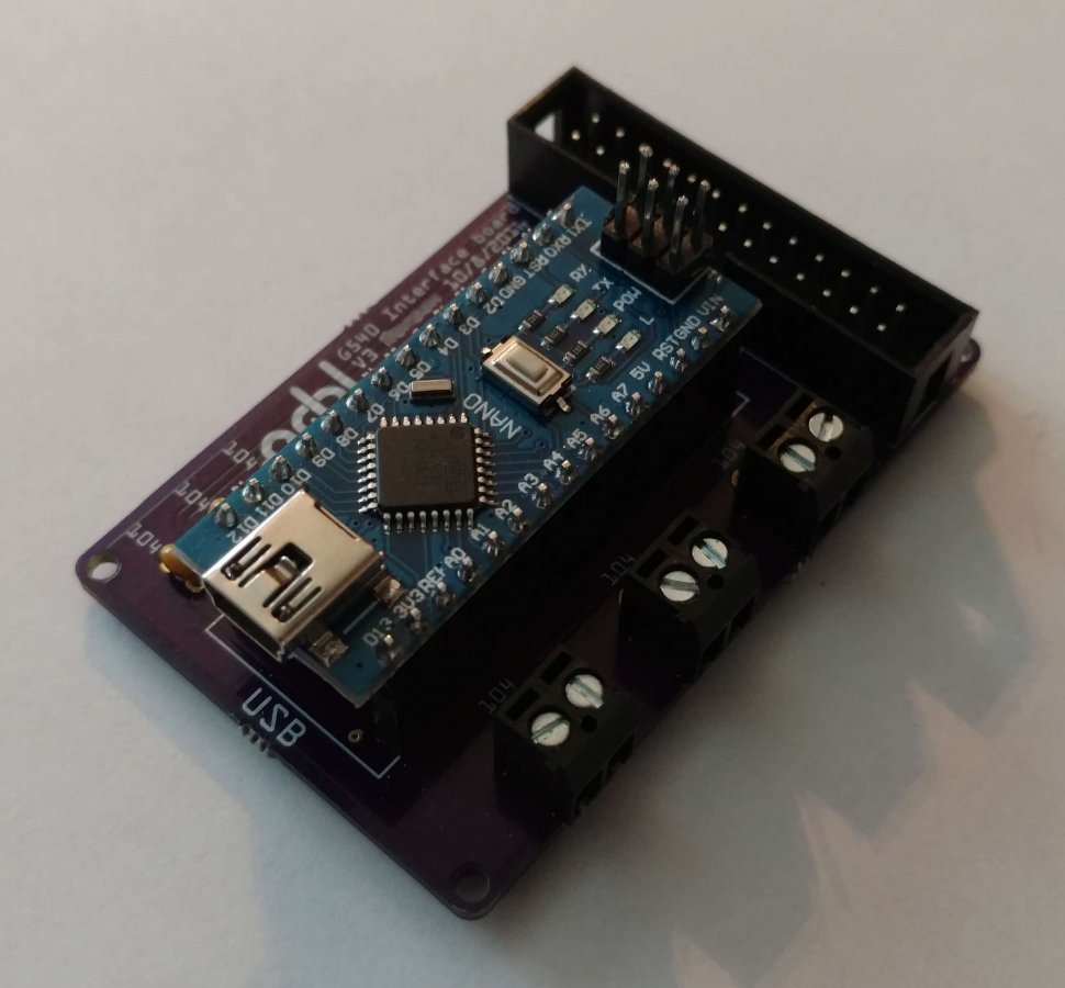

    Hi Kyo - I would like to know more about your GRBL / Estlcam controller. I really like Estlcam and have run into problems with TinyG / Chilipeppr when trying to run rather large G-Code files. I would like to get away from chillipeppr / web browser as control software interface. Are you selling your boards someplace?
