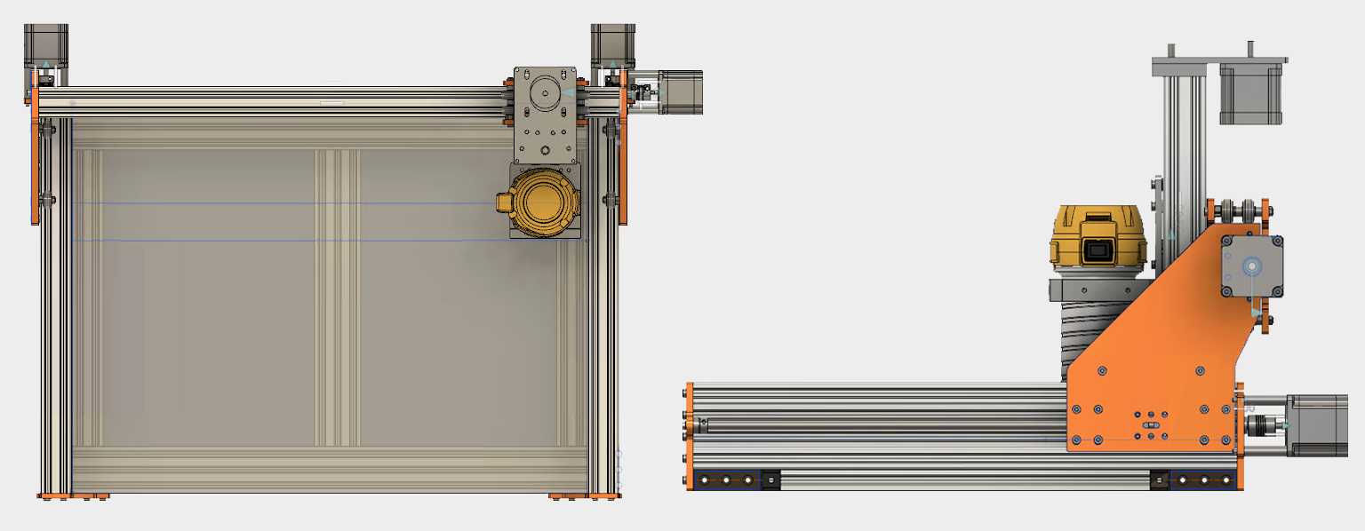

    I've been researching CNCs for a few months now for my first build, and instantly fell in love with the Sphinx. I'm in the final days of tweaking my design while I wait for stuff to float in from China, and had a few questions/concerns. Hopefully someone (especially Kyo) can offer some guidance.
    1. After putting everything together in F360, I noticed that there's at least 170mm of unusable space in the Y axis (possibly more with a larger spindle/mount). Is this consistent with the design? I've noticed that many linear-rails based designs mitigate this problem slightly by adding an offset to the gantry plates. Would this work for an openbuilds design design or would this put too much load on the wheels? See below for a modified gantry that adds 40mm to the Y and Z.
    2. I'd like to add homing switches (ideally inductive), but there don't seem to be designated places for them in the build and it doesn't look like many of the builds I've seen have them. Is anyone out there running homing switches on a Sphinx and if so, how/where did you put them.
    Thanks so much for any advice and thanks for the excellent build/community.

    Thank you kyo. If you don't think it would be outright disastrous, I think I'll give it a try. Here's a rendering of what it would look like and the difference in the cutting area (the blue line is stock).

    I think you'll actually lose a little rigidity since the endmill will have greater torque on the gantry. How much is the question.
    I should say that the torque is being applied differently.
  23. Rick 2.0
    2,912
    1,579
    Brian, can you give us a superimposed side view showing the router in relation to the side plate. While your spindle balance appears to have improved, overall the gantry may be a bit back heavy. You might consider adding another top row wheel near the rear of the plate.
    Also, you are overestimating the blue line area. The back blue line should be at the center line of the spindle which only makes for about a 40mm gain.
  24. Brian Popp
    Brian Popp Well-Known
    Feb 27, 2017
    33
    58
    Yeah, that blue line is at the center of the spindle, but I think the perspective may have just made the improvement look better than it actually is. Here's a better view that shows both the top and side profile with the modified plates:
    I've increased the width to 750mm and the length is roughly stock (550ish). I've considered three modifications to increase rigidity, but I'm not sure if they would actually do anything:
    1. Add a 20x40 vrail underneath the X axis cbeam. I would join it to the cbeam (likely with blind joints), and then modify the plates slightly to accommodate it. This seems like it would have two advantages. First, it would add rigidity to the longer X axis, and two, it would increase the distance between the wheels on the Z gantry which should (i think) reduce torque a little bit.
    2. Add two large wheels to each plate inline with the outer small wheels. I'm 3d printing my wheels in polycarbonate, so cost isn't an issue and it seems like it couldn't hurt.
    3. Finally, I've ordered a 12x12 3/8" plate to use for my side plates. It's only $12 more for the materials and the impact to the design is minimal.
    I'm not an engineer, though, and any assumptions I've made here are just instincts (likely misguided instincts) more than anything else.
    #354 Brian Popp, Apr 25, 2017
    Kyo and Rick 2.0 like this.

    From the side view it looks like you've got even better balance than the original design.

    Looks good Brian, give it a go. That is one of the great things about this site and the designs here. You are able to freely modify and update to suit your needs. Not being locked it by one set standard or lic. I learn more and more with each build my own and others. I look forward to seeing more of your build. :thumbsup:

    It looks good, but...now it doesn't utilize the entire cutting surface to the front. Unless, of course, you are using really large diameter cutters.;) If you bumped it back half the distance, the center of the spindle, where the cutter is, will be able to cut (approximately) all the way to the front edge.
  28. Giarc
    3,062
    1,716
    Although, either way I think you are going to get the max you can out of it without actually shrinking the width of the Y gantry plates. You can also clamp the front of your stock the way you have it now.

    You had me worried there for a minute, but there actually doesn't appear to be much waste in the front (at least with a large router):
  30. Giarc
    3,062
    1,716
    Basically, you loose the width of your Y plates. As long as the bit is cutting between the front and rear edges of these plates, you maximize your cutting area. I like your design. I did the same thing in my build. I may make a dremel mount that fits the front of my spindle mount so I can cut dovetails by mounting the boards vertically on the front of my machine. The dremel would extend over the front edge far enough to do so.
