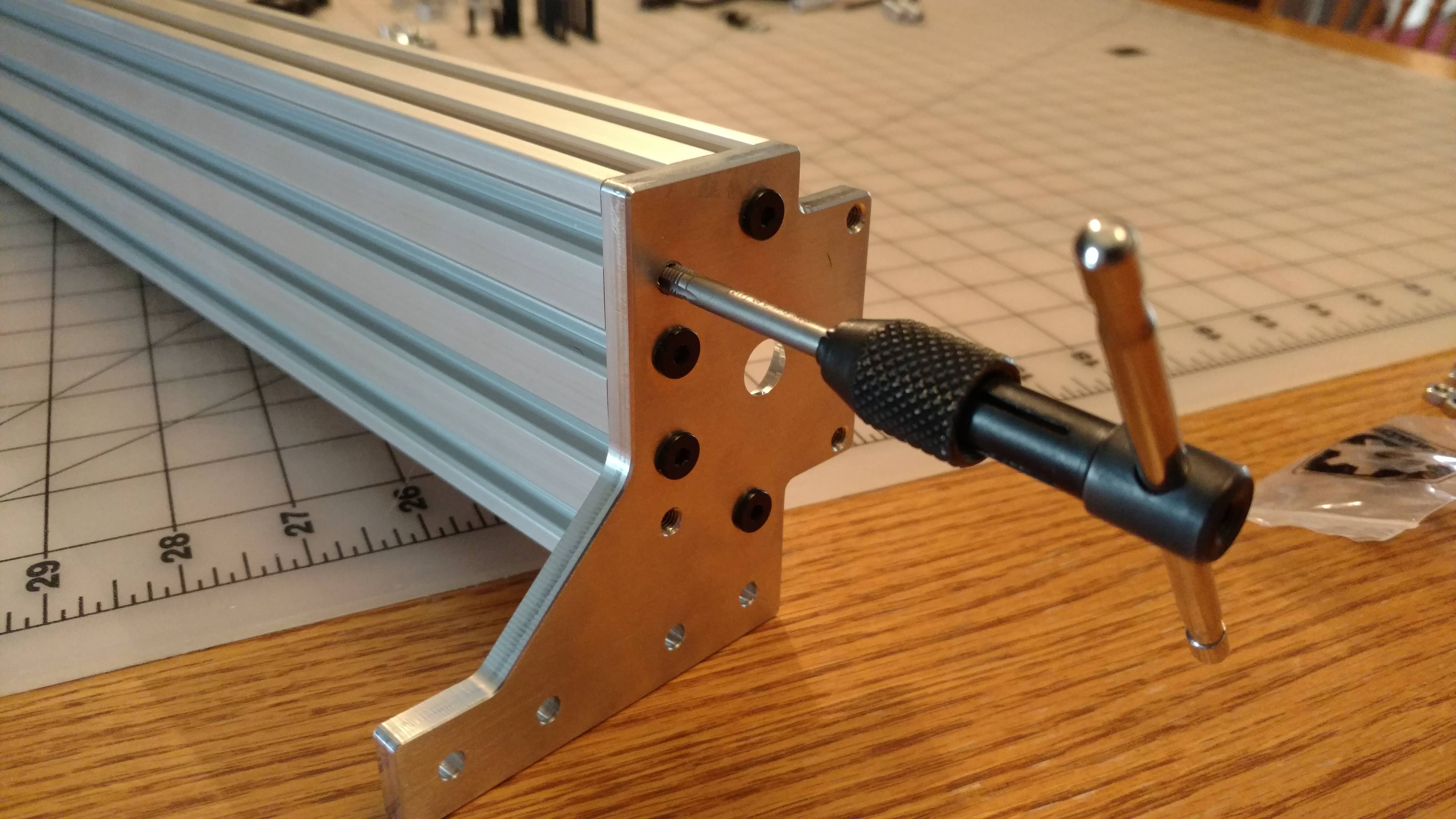

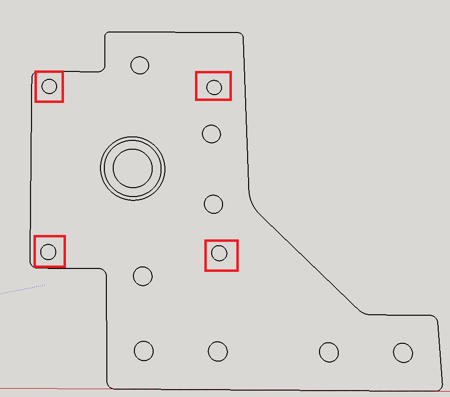

    Hi everyone,
    This is my first post :D
    I am trying to build the Sphinx CNC and when analizing the files a question comes to my mind concerning the y_axis motor mount plates,
    i downloaded the dxf and the stl files and looks like the size of the holes for the nema motors have 4.2mm of diameter instead of 5mm. Is that correct? Did I downloaded the wrong files?
    Thanks for your support

  9. Rick 2.0
    2,912
    1,577
    4.2mm would generally be indicative of an M5 tapped hole.
    (photo credit: Kyo)
    Steve Nall and Kyo like this.
  10. theivory
    theivory New
    Dec 9, 2016
    Wops Rick, of course you are right!!!
    Thank you very much!
