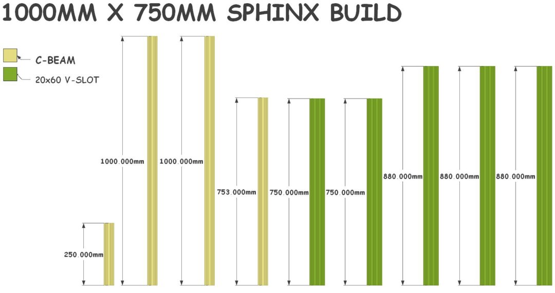

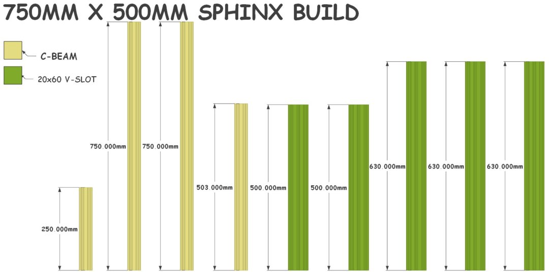

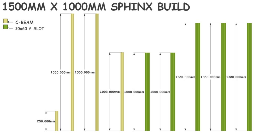

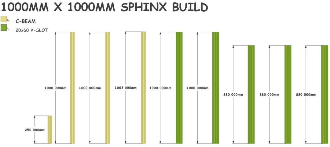

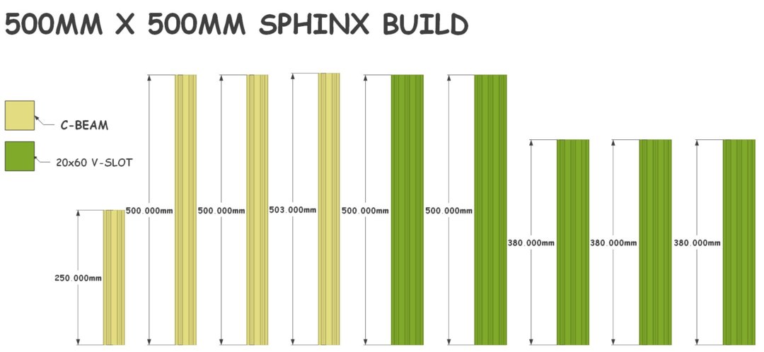

  18. Kyo
    Kyo Veteran
    Feb 27, 2014
    674
    707
    Here is a quick set of drawings going over the most common build sizes I think one would undertake. I believe for aluminum the ideal size is as per the original build at 500x500. I would probably chose either a 750x500 or 1000x750 if I was to start another build today, this would allow more flexibility with some projects / builds I have in the works. :D
    Besides extrusion length you will also need longer lead screws. A good rule of thumb is axis length + 40mm this gives you enough for bearing engagement and securing the stepper coupler. OpenBuilds part store has this extra built into there offerings. If you go with other screws / suppliers you will need to take it into account.
    All remaining fasteners , hardware, plates, electronics , ect. Remain the same for any given build size. This is great as it allows flexibility and growth. You can start with one size and expand as your needs or projects require at little cost ( extrusions and lead screws. )
    500 x 500
    750 x 500
    1000 x 750
    1000 x 1000
    1500 x 1000
    Joe Downard, Michael.M and GrayUK like this.
