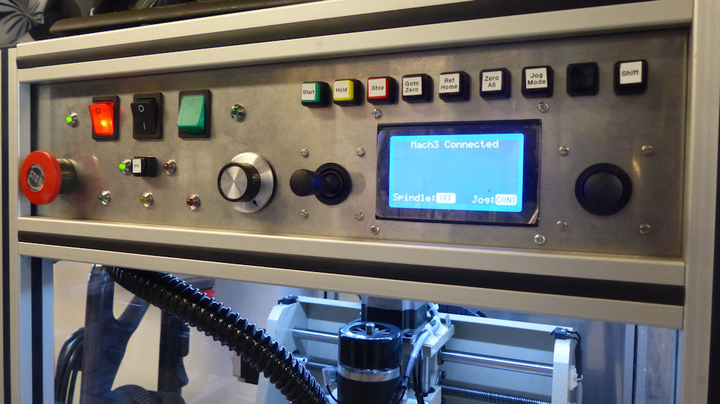

    Yeah the end caps are purely cosmetic, they can be 3d printed, machined on the cnc itself after the fact or completely left out. They only serve to close the exposed v-slot ends. When using the cast corners just file off the nubs with a file or belt / disc sander. It only takes a second and in a few orientations they can get in the way. Otherwise they are just as good as the milled ones and you will have no problem using them..
    Sweet electronics setup. Any more details on the lcd and how everything works? I do not think you will have any problem connecting your current electronic setup to a sphinx build. The sphinx makes use of four nema 23 motors and it sounds like your current machine uses three so you may need to add a driver if you don't already have one.
