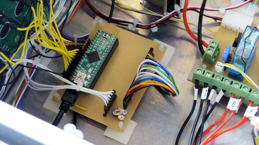

    I'll add the BOM as soon as I have made a couple more changes. I haven't had a chance to start playing with the skecthup file yet, but have a few ideas and tweaks in mind.
    I am actually thinking of just using the low profile M5 bolts. With a standard M5 washer they slide nicely in the slot. It's then a case of drilling a clearance hole for the allen key in the correct place, so they can be tightened up from the outside. The front slot can by tidied up with some slot cover.( I have used a similar method with Motedis profile and it works great)
    Yes I knew I would need at least one. Two of my current motors are 56mm long and the other is only 40mm. I am guessing the 2 bigger ones are similar specs to these basic Nema 23's. Not sure if the smaller one would be any good. I think the crappy stepper drivers I have only go up to 2.5A current, so it limits my motor choice for now.
    Well I don't want to hjack your thread with it too much, but if you can't sleep and want something to read you can find some details on my blog. The LCD is controlled by a Teensy 2++, which is connected to the PC via USB. A custom Mach3 plugin handles communications between the 2. (You can also see part of the charge pump circuit in the following pic, which shuts of the 24V to the motors and power to the spindle relay in case of a PC crash or Estop event)
