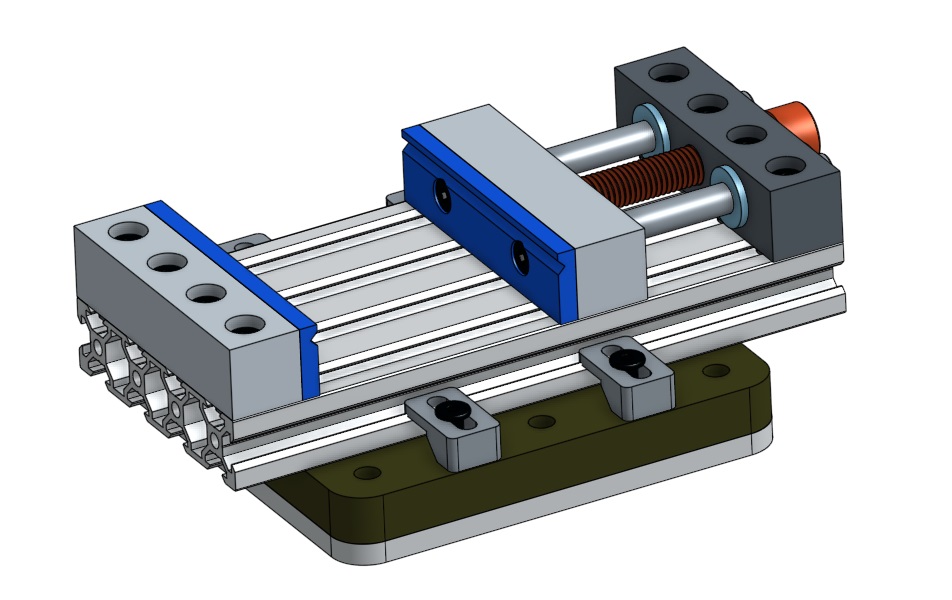

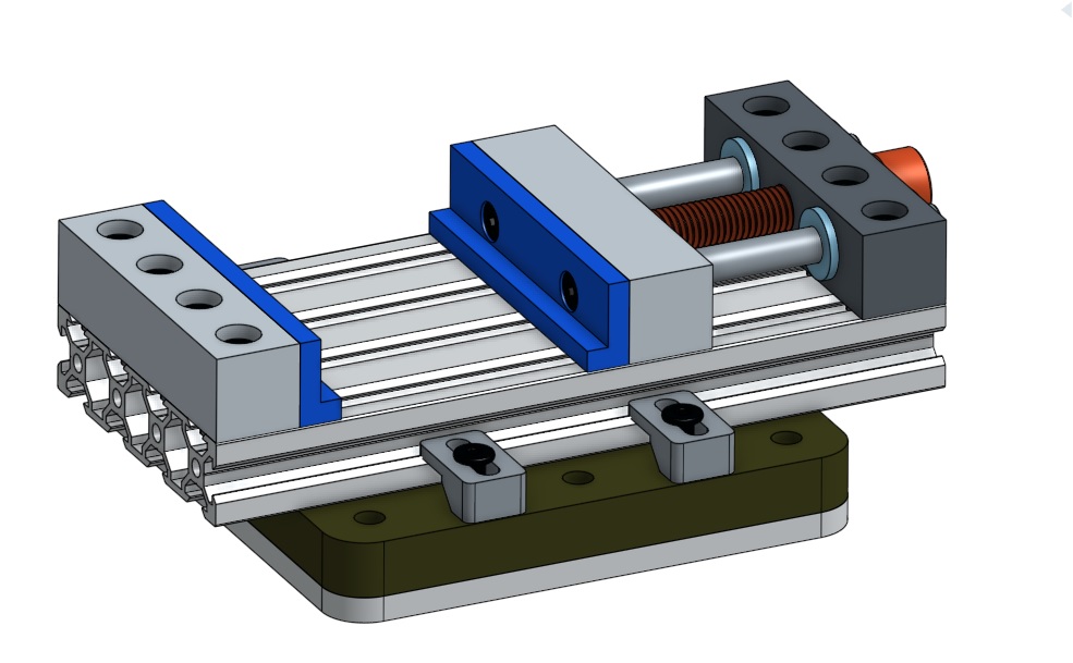

    And we can always have them anodised in different colours for different types :D

    I also bought 20mm by 20mm aluminium stock to make the vise sets. I will be making them together with new X and Y gantry plates until mid December to be ready for the upgrade when the rest of the part are here.

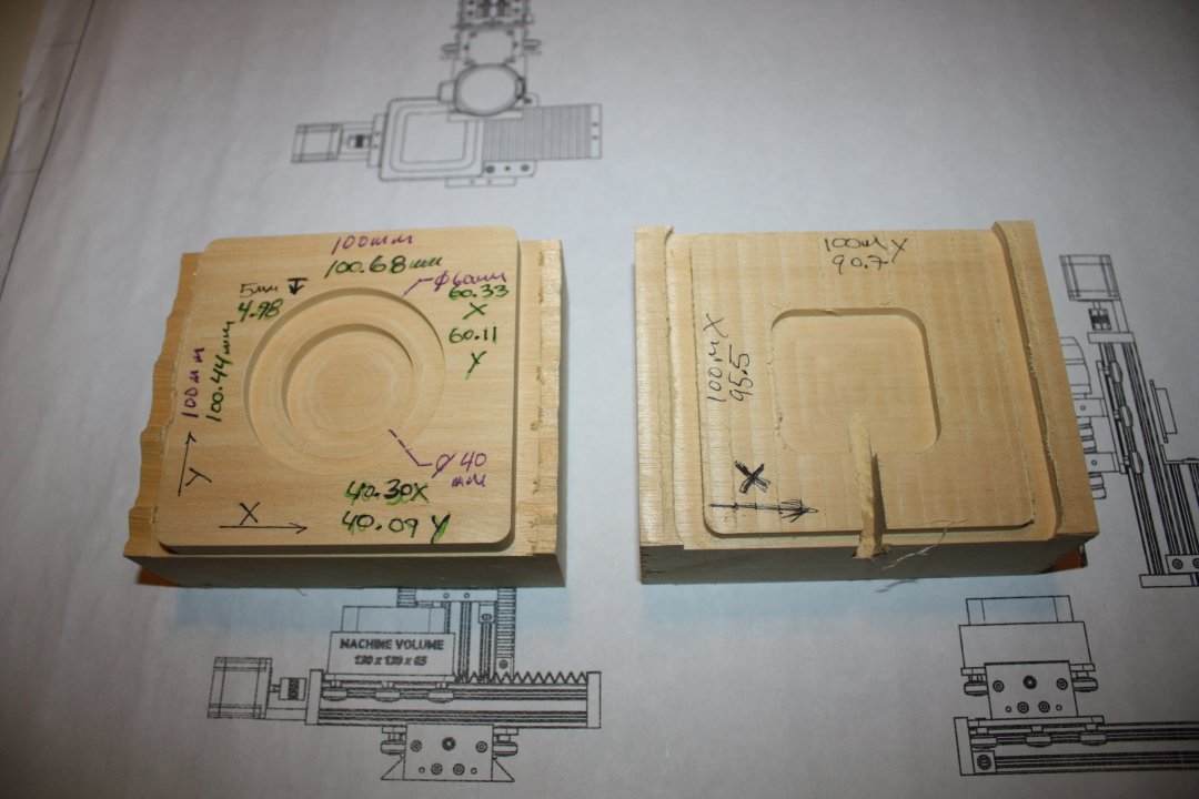

    I done some test cuts with 2mm alu today and realised my circles are not perfect circles. I am using fusion 360 for now to create my g-codes.
    Below is a part of the gcode for the circles;

    As you will see from the below photo, top circles (10 mm) are not exact circles. Below ones are 5mm so its less visible there. I am happy with the cut marks on the sides but they can be smoothed more somehow I believe. The pocketing (in the middle) is not so bad but now I hesitate to mill the gantries from 6mm alu as the circles can be a real problem. (at least cosmetic wise) o_O

    Gino,
    As I am calibrating my machine and also using Fusion 360 I find this interesting and hope to hear more comments. I'm sorry to say I can't help, at least not at this moment. I can tell you that a circle is one of the hardest thing to cut with a CNC as there is not a single straight line cut. It's our go to example when calibrating the machines at the shop. I hope to make a few more cuts tonight and see where I get as the first couple samples are so far off I can't believe machine is cutting so bad (Y 90mm instead of 100 and X 96mm instead of 100). I resist making any changes to the settings as again, this is so unbelievably out!?!?
    I also wonder why we run 1/8 steps and not 1/16 (or higher), it seem like the resolution would be better with 1/16 than 1/8...I'm sure this has been addressed and there is a **** good reason, I'd just like to understand!?!?

    Here ya go...
    Cut one (last night) a total mess...
    As you can see the cut was way off, 100mm in X was actually 90.7mm, and 100mm in Y was actually 95.5mm. I honestly think this was as much Fusion problem as anything, and not from the Fusion side of thing, but from my side of things. I think I just screwed up the programming!?!?
    Now to tonight cuts, a success considering no tuning has been done. I threw the circle in there for you Gino ;)
    Here you can see my cuts were far more accurate than the first example. With only being off fraction of a mm I am much happier with these results. I'll run this in HDPE next and see what I get, if the results are the same I'll adjust my GRBL settings :)
    Here they are side by side...
    BTW: I still need to make sure the center cuts out, I forgot to program that step in the process :banghead:

    Ha! Am glad you are getting there for the accuracy.. Now your circles DO look like circles to me.. Far better than mine for sure!
    When you select the correct tool in fusion CAM setup it is pretty accurate in my case. Are you actually selecting the tool that you are using for the cuts?. You know you need to do that for each setup instance (circular, pocketing etc.)

    Gino,
    Yes I select the proper tool, and even measure it to make sure it's on size (although I don't remember if I measured this tool!?!?). When I can I create a derived operation for the previous one (adaptive roughing) so I don't have to select tool again, unless I'm using a different tool for the next operation.
    For tonights cut I simply used the Adaptive Roughing and a Derived 2D Contour Operation, as I mentioned it missed a small are in the flat part of the first circle (60mm). It also missed the flat in small circle (40mm) but in this model it would have been a hole so it didn't matter. After further review I think a Derived Pocket Operation would have been better suited for this. I try that next :thumbsup:
