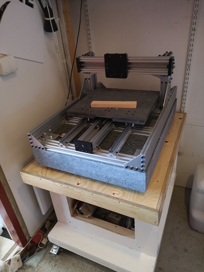

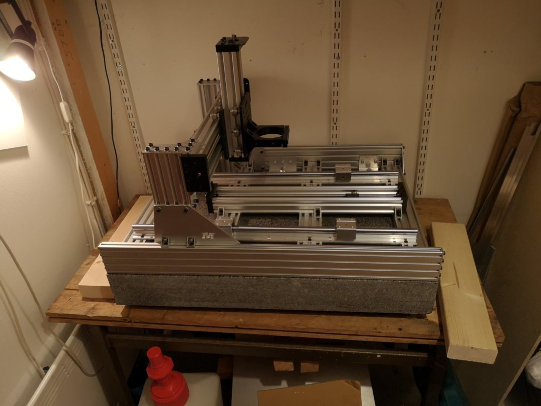

    Okay, I choosed to move my machine home where I have a small space to be able to continue my build. I will miss all the fancy tools, but will at least progress.
    During the move the stone was really heavy to lift, so I wheight it. 110 kg! Without the router on top...
    Here is a picture of the new location.

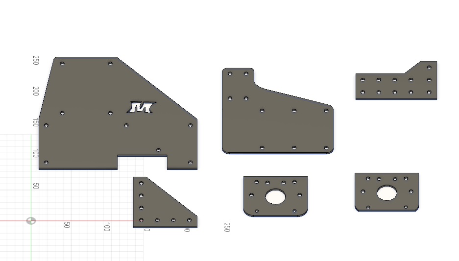

    I have uploaded a DXF with the extra plates that I waterJet cut to the files section.
    IF anyone would like to copy those I would double check if everything seems to be correct, sice I draw them in Inkscape and exported to dxf, and I would not trust that entirely (I did cut from that export though). I have tried and open the dxf in F360, and at least it opens :)
    The first three ones are for stiffening the gantry, the corner bracket a bit bigger since I use 20x80 in the sides in the frame. And then the enlarged stepper mounts (to be able to have 4 mounting screws on the steppers). You can see that one is a tad smaller, giving me a little more Z-height.

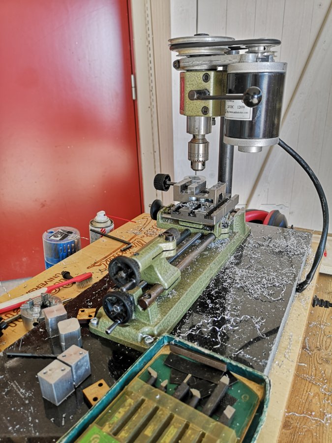

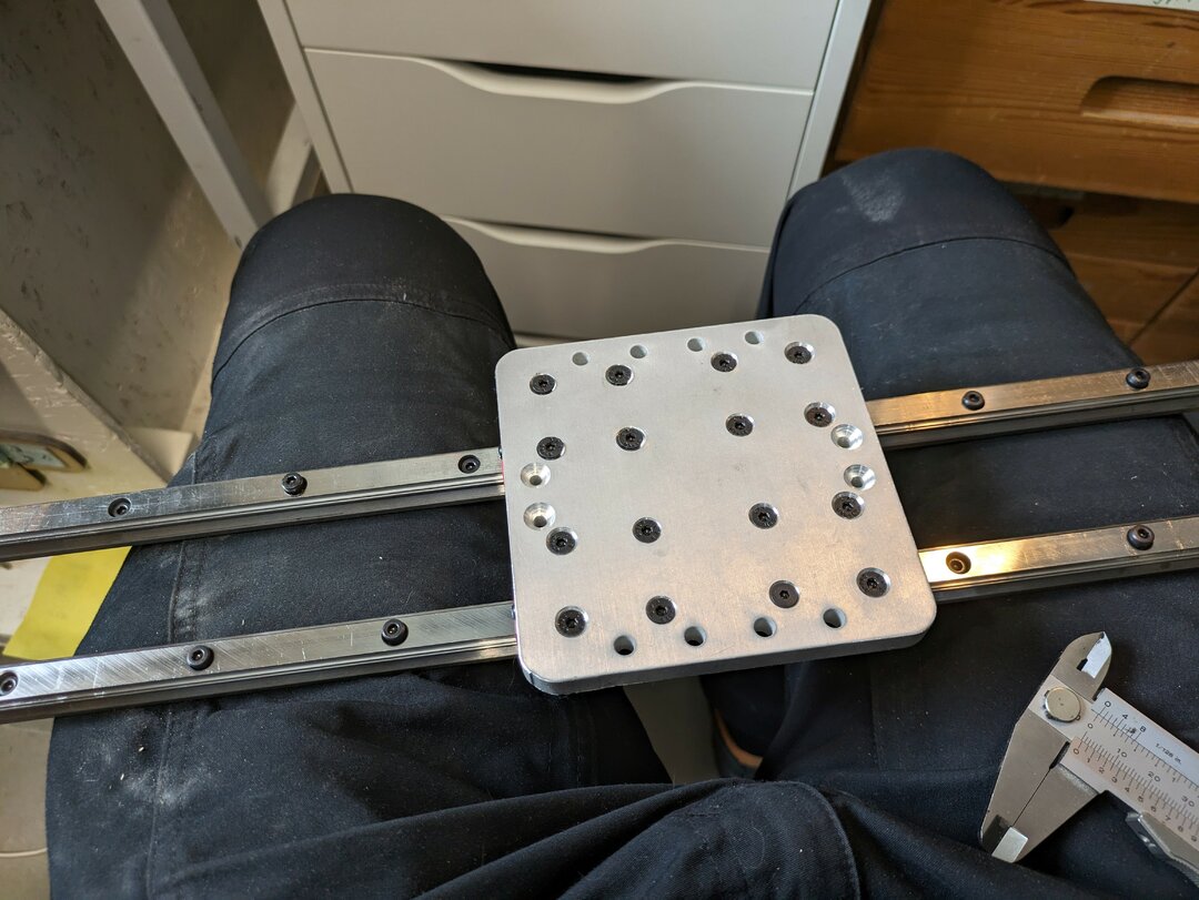

    So a little update on the machine build.
    I have been side stepping a bit, and needed to finish some other builds to be able to come further in this build.

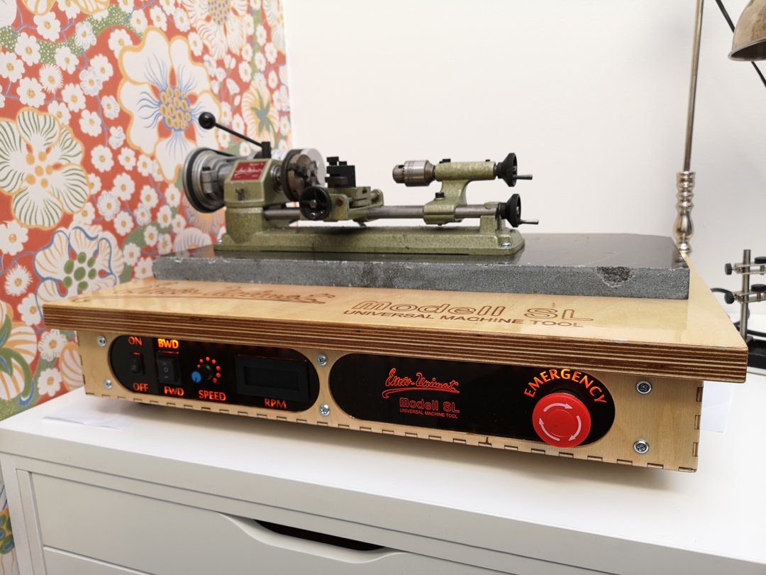

    First I have buildt a stable table for the machine to sit on as cen be seen in picture below.

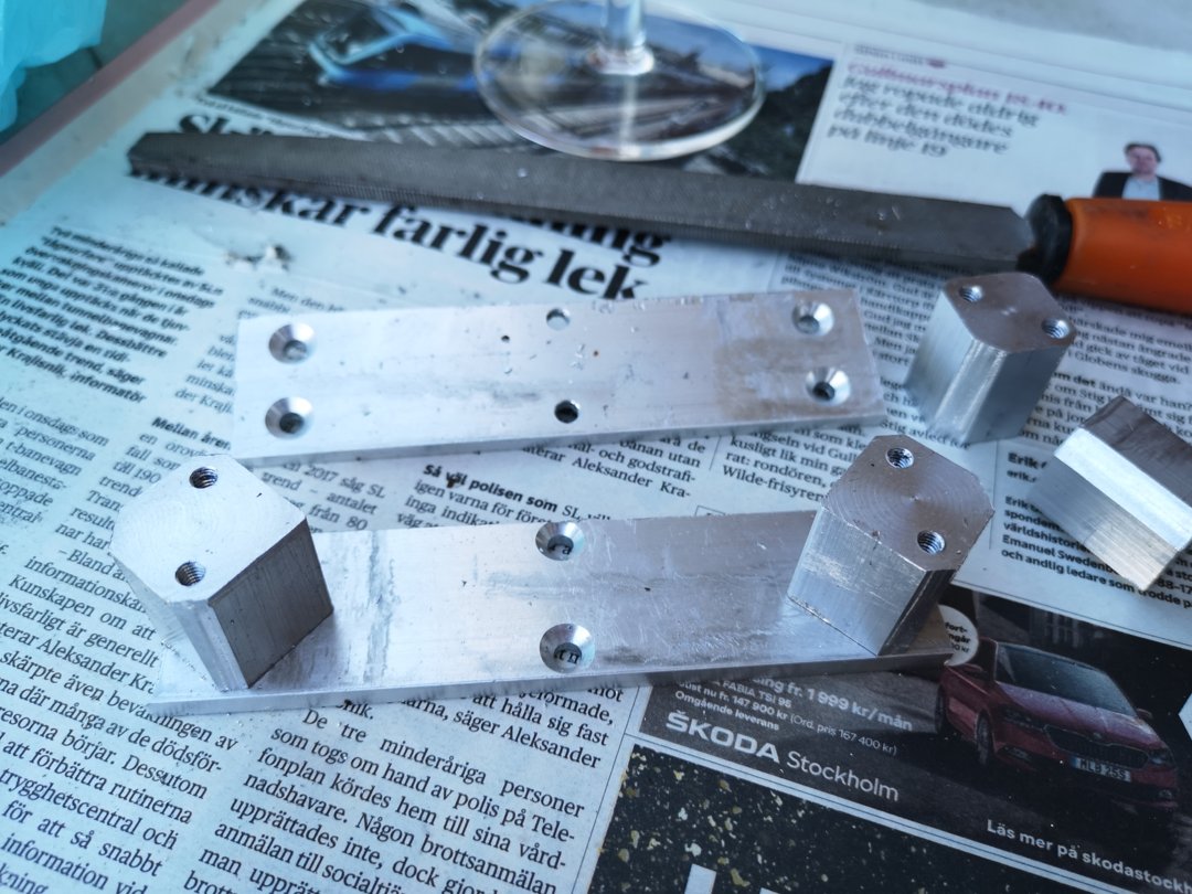

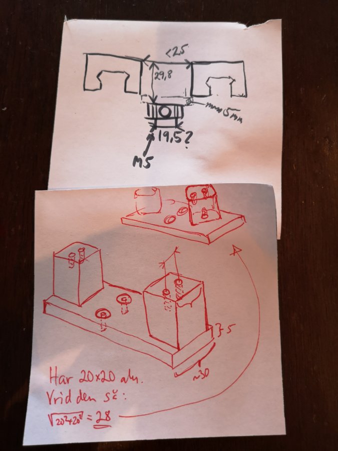

    Then I decided to buy square rail for X- and Z-axis, which made me to redesign how the lead screw nut should be attached.
    I saw the need for a mill or lathe, and I did finish my restoration of my old micro lath/mill combo (Unimat SL - picture below).
    Then I made the parts needed (I have made them so that I can easily get to the nut to adjust it if needed), as can be seen in the pictures of design schetch and finished part.

    I'm sorry my build has taken so long (mostly for my sake, but also if someone interested has waited for an update). Things has come in between (building a house and a garage), and I have not had time to finish my C-beam machine. But now I have a garage to house the machine in :)
    Hopefully I will be able to make some chips soon. I have to shim my linear rails a bit (have some binding at one end of X) and then start the electronics part of the build.

    41

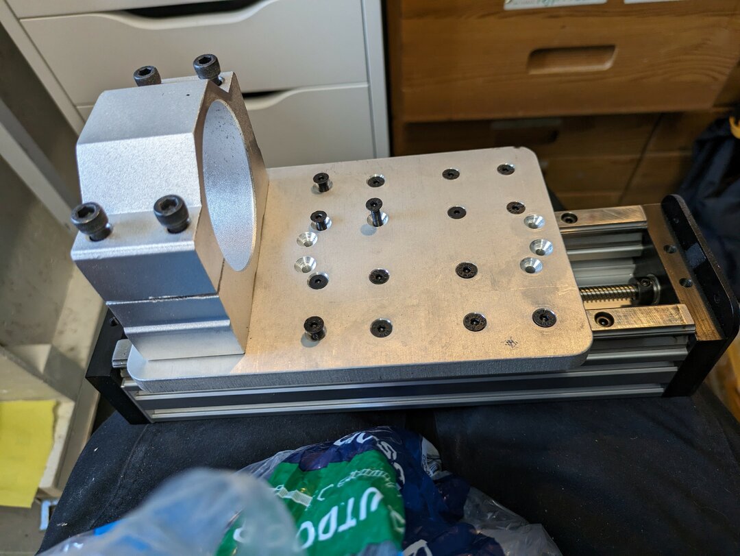

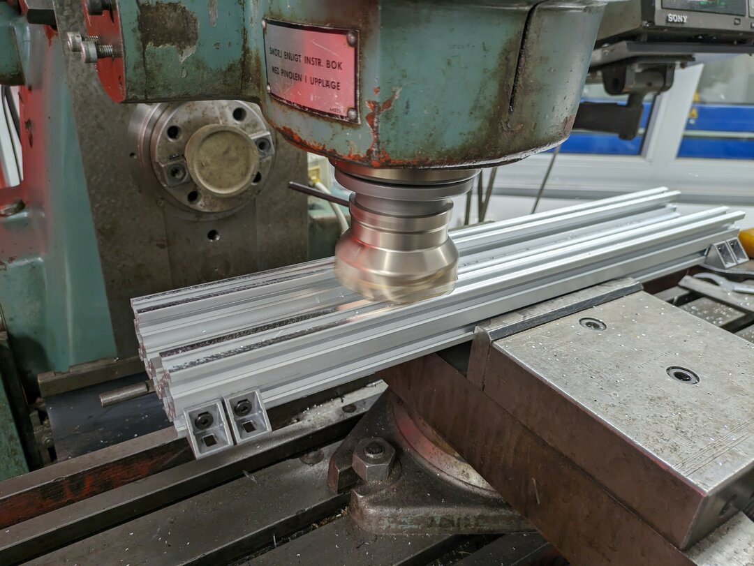

    This is a slow build, but I have done some progress. Since I had problem with the new linear rail binding I did disassemble the machine this weekend and got the c-beam milled flat. Hopefully the binding will go away now.
    And I also mounted new aluminum plates 10mm thick and a new router mount.
    I aim to assemble the machine and move on to electronics and control as soon as this binding issue has been solved.
