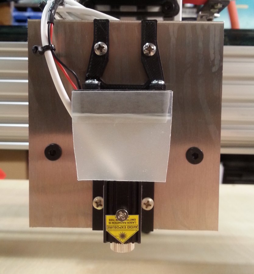

  9. Metalguru
    Metalguru Veteran
    Dec 29, 2015
    751
    549
    I put a laser on the front of the router mount. The aluminum plate acts as a heat sink. The two black screws are the same as the ones that hold the front bar of the router mount on. Top is a fan, not really needed as nothing even gets remotely warm. Controller is mounted on the front of the c-beam above the router mount.
    Note that this is a 2.8W engraving laser, not just a positioning laser.

  13. Metalguru
    Metalguru Veteran
    Dec 29, 2015
    751
    549
    Here is a pic of the whole assembly mounted on the Z axis. Laser and controller is from J-Tech Photonics. I really like the controller, it has great safety features. J-Tech also has the 3D printed mount to fit the controller to the C-Beam Z axis with holes that line up on the 20mm slot centers.
    I also bought some laser blocking acrylic from J-tech, and made a little rectangular shield to go around the laser. Of course, just after I bought the 2.8W, they came out with a 3.8W.
    Only requires 1 connection to PWM out from Arduino, you can control laser power from the g-code. I'm using GRBL 1.1F which has Laser Mode, it works like a dream.
