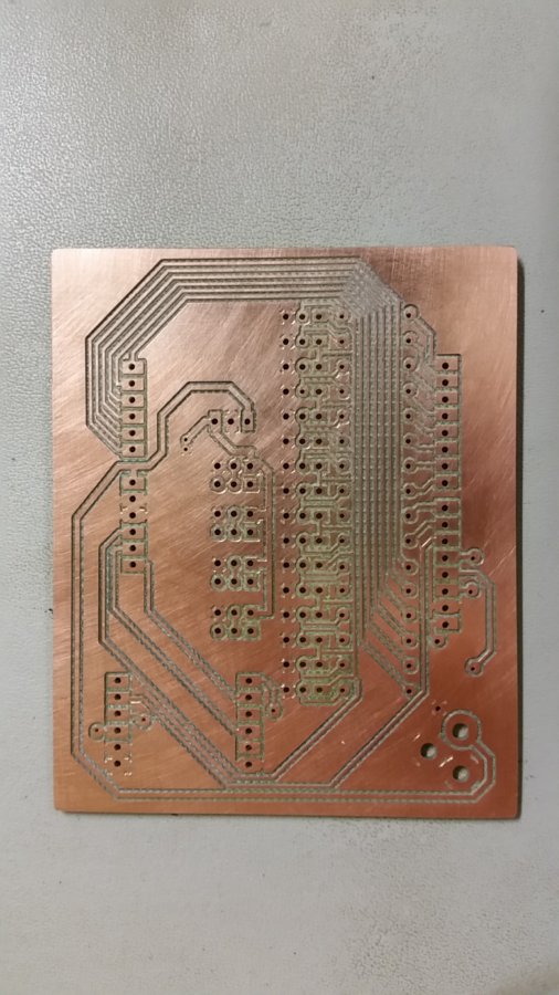

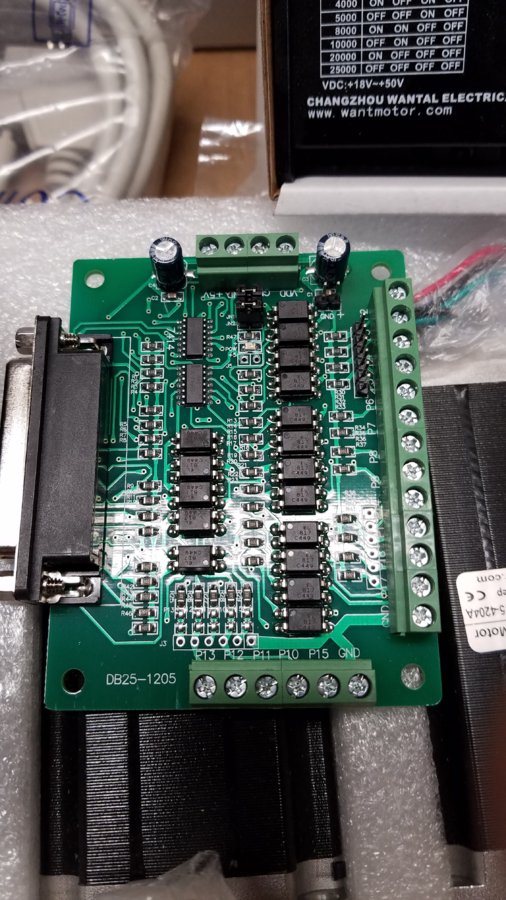

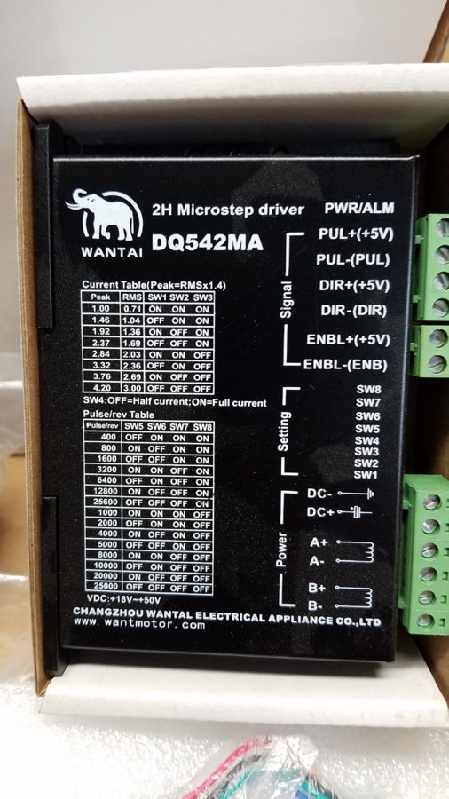

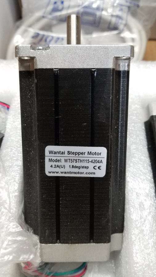

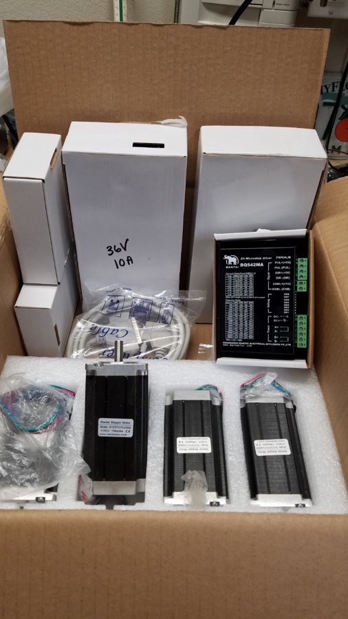

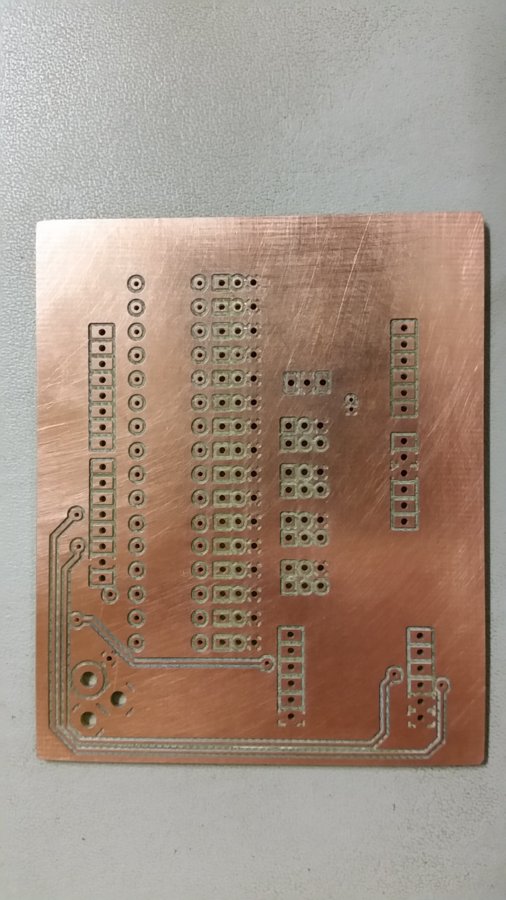

    Alright folks, just added a C-Beam XL to my shop. I have an OX with an XPro, which will be replaced the second it dies, and a couple 3d printer. Just pointing out that I'm not a total noob here. Anyway, I'm torn on which control method to go with on the C-Beam? I do like using GRBL and would prefer to not purchase special software. I have some 542 drivers, some 4.2A steppers and a couple 36V power supplies from another project that I could utilize as well.
    Metalguru, you seem to have extensive knowledge regarding this.
    20180616_192310.jpg 20180616_192319.jpg 20180616_192314.jpg 20180616_192352.jpg
    Josh
  28. Metalguru
    Metalguru Veteran
    Dec 29, 2015
    751
    548
    Hey Josh.
    Well, the Arduino running GRBL is a tried and true solution. I often use the Arduino Nano with a small screw terminal block "motherboard" that I get off of Ebay. Makes wiring simple. I use Xloader to load in the GRBL firmware. Works well. Been reliable, I have built close to 50 machines and only had one failure on the arduino side of things. And yes, please get rid of that Xpro at your earliest convenience. I think you would find a significant performance improvement on your Ox with something better in the driver department. I kind of like the Panucatt Gradus M1 Pro with Bigfoot drivers for an all in one solution.
    Looks like you have a breakout board designed for Mach3 there, you could use that instead of GRBL if you like Mach 3. Have to find a computer with a parallel port or use a motion controller like the UC100 or UC300 or ESS if you want to run that board. This will allow you to use USB or ethernet connectivity respectively and still run Mach 3. Be careful buying UC drivers off ebay and Ali Express, there are a lot of counterfit units out there. The ESS is a really nice board, and gives very smooth performance, but a bit spendy.
    Your 542 drivers should be fine, they work pretty well. 36V power should give a bit of extra kick in the torque department.
    The motors are a bit on the torquey side. I find that the high torque motors sometimes cause problems, simply because they have so much torque that you can't keep the lock collars and flex couplings tight, the motors can cause the lock collars to come loose or spin the flex couplings on the lead screw if you run into the end stops. Would definitely recommend limit switches on a machine using those motors.
