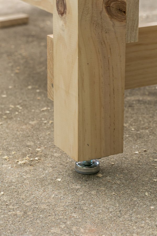

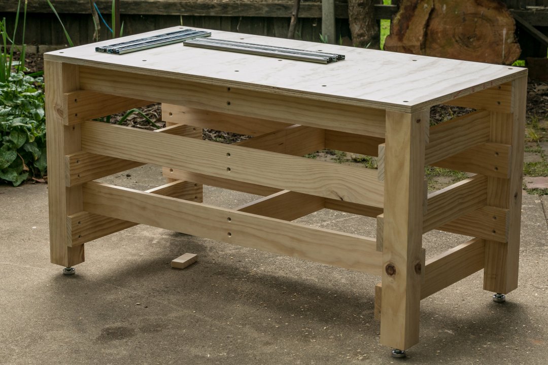

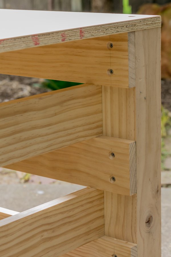

    @Traxxtar, can't see it being much of a problem, if you don't want put anything under there. Just attach it well to your bench, for added strength. Talking about bench this is what I'm planning, I will post up a pic, when built.
    Concrete filled C-Beam? Yes still playing around with stuff as designers do. "Will it ever end? Hope not";)
    As for the u channel, it works nicely but not a easy fitting job by hand, by a long shot. Lots of time, to get it to fit well.

    Nice bench. Looks extremely sturdy, perhaps more than you'll need. I'm actually in the process of designing and building one myself.
    For the C channel...instead of using a C channel brace, how about just using a flat bar 1/8" or whatever will fit along the inside of the Cbeam? (excuse the quick photoshop job, but wanted to show what i meant). Make it thin enough to not interfere with the screw, etc. Secure it with Tnuts, etc. I think this would strengthen and add rigidity to it.
