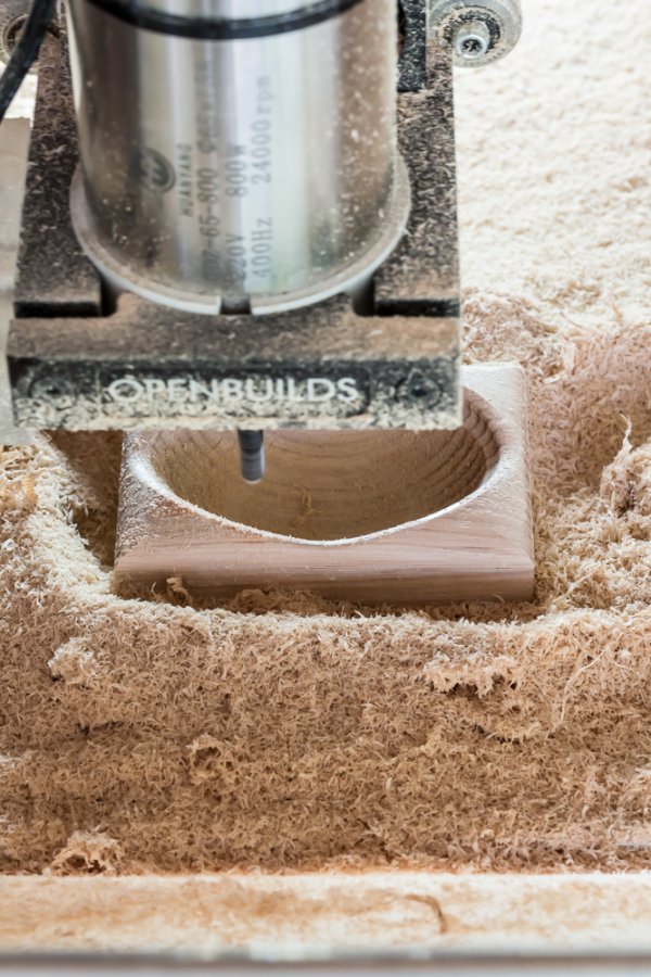

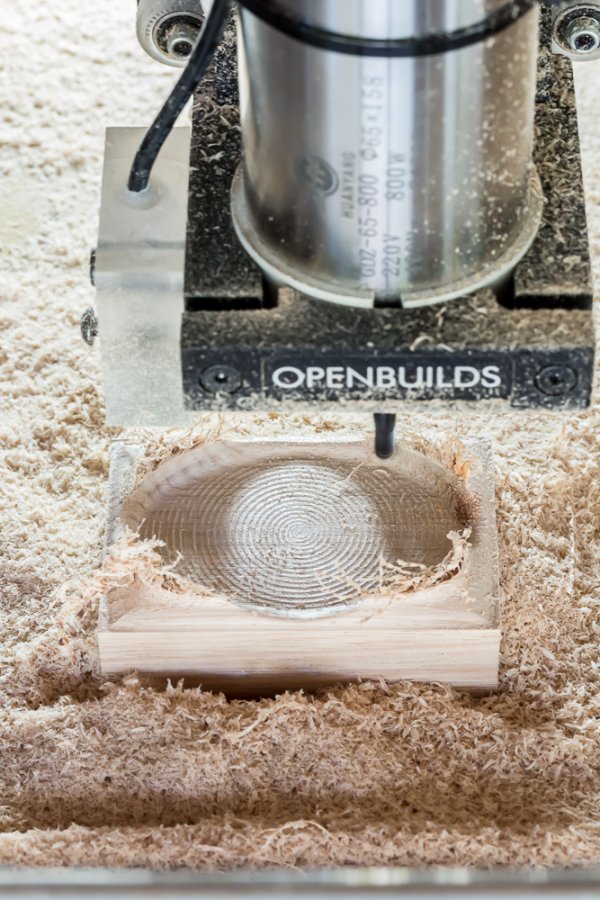

  1. Kyo
    Kyo Veteran
    Feb 27, 2014
    674
    707
    That looks awesome, just add some slots or holes to the bottom, seal it up and it would make a cool soap dish. :thumbsup:
    gwandad and Moag like this.

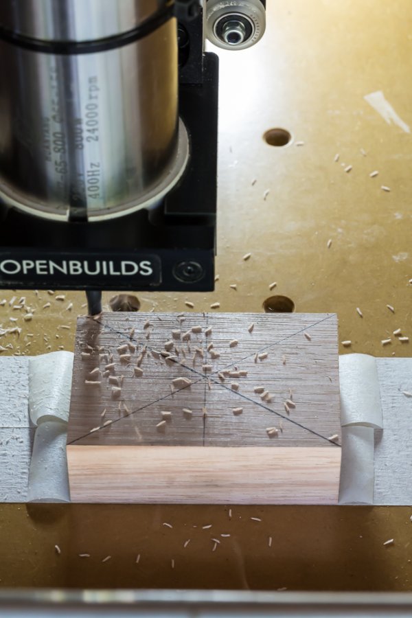

  2. Moag
    Moag Veteran
    Mar 16, 2016
    183
    295
    Just for us old/ish fellows that lose stuff;) I've added it to the Tutorials section Chinese Spindle & VFD Setup

  4. PhotoSgt85
    PhotoSgt85 Well-Known
    Jul 27, 2015
    54
    66
    If you flip the Y axis supports you will lower the rigidity due to lowering the moment of inertia of the part. Think of a 2x4 laid flat vs stood up on the short end. The vertical orientation provides a lot more moment of inertia. More than just lying on the table ( if thats the way you set it up) the machine will be producing bending forces from operation, so the more MoI the better.

  5. Moag
    Moag Veteran
    Mar 16, 2016
    183
    295
    Next thing is the vanity sink Kyo...:ROFL:

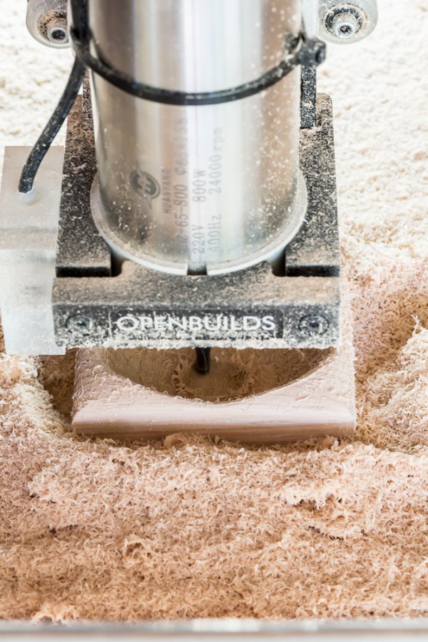

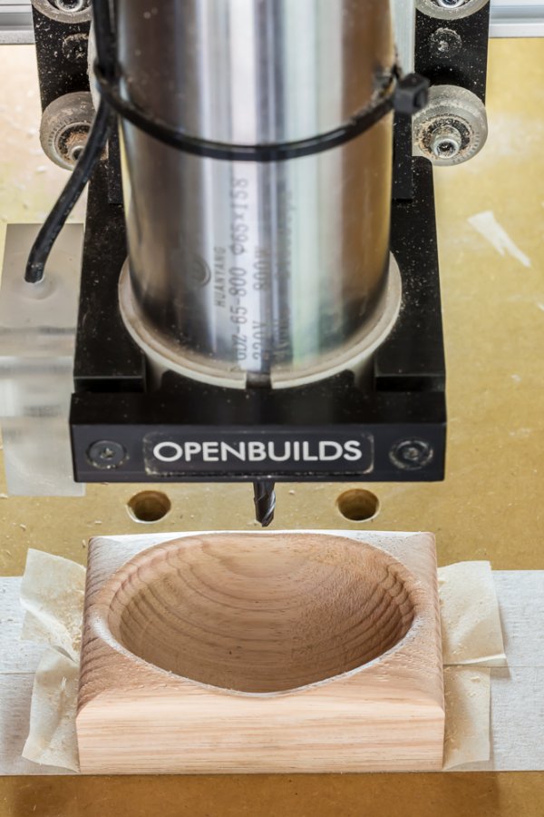

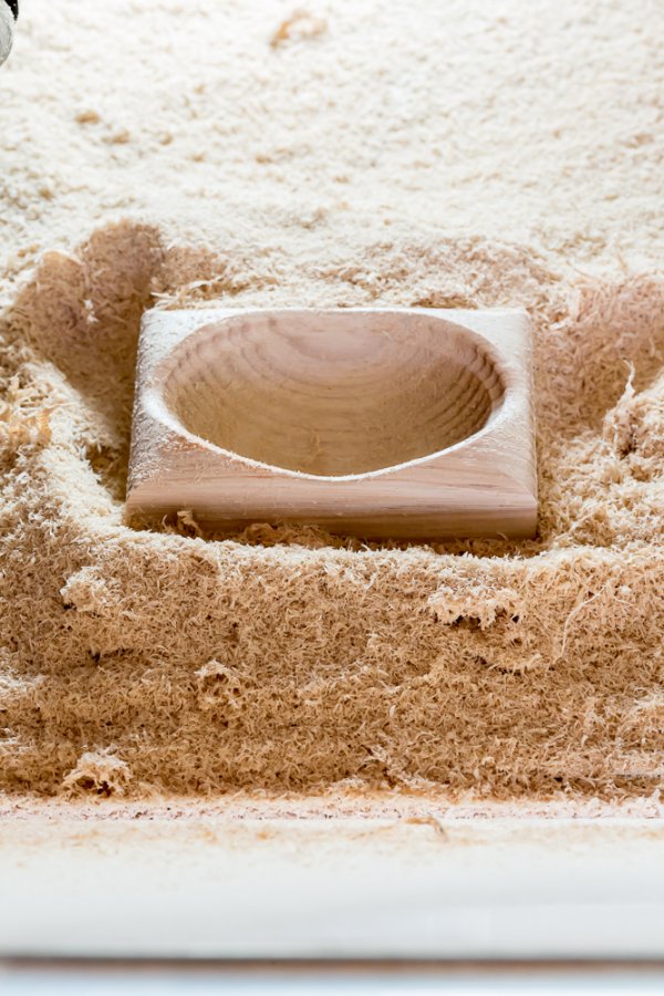

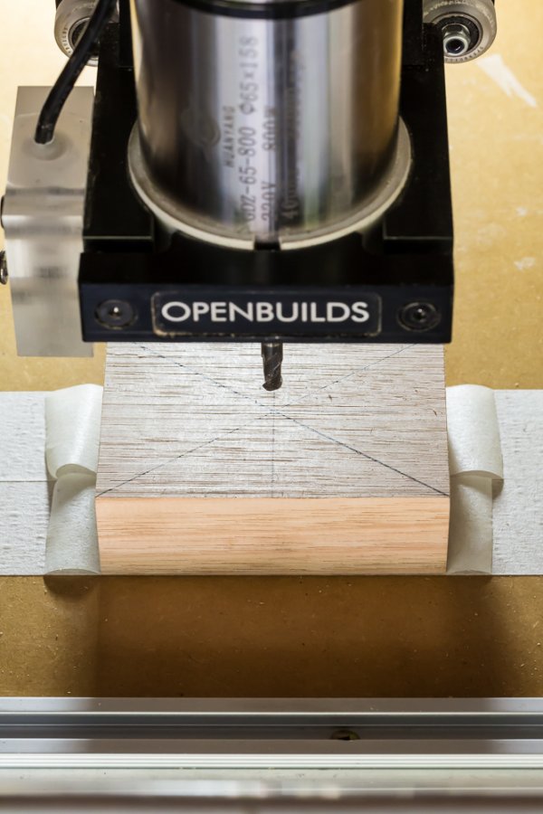

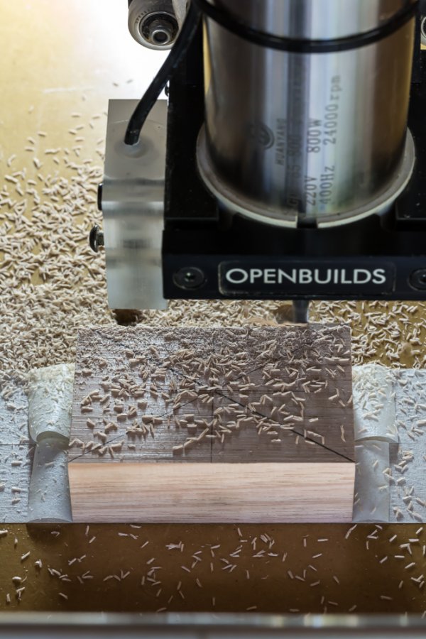

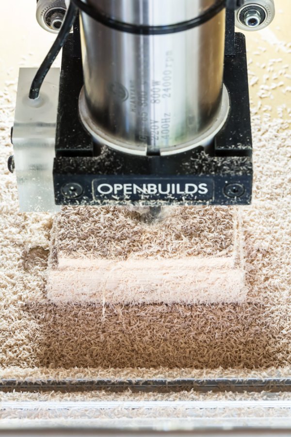

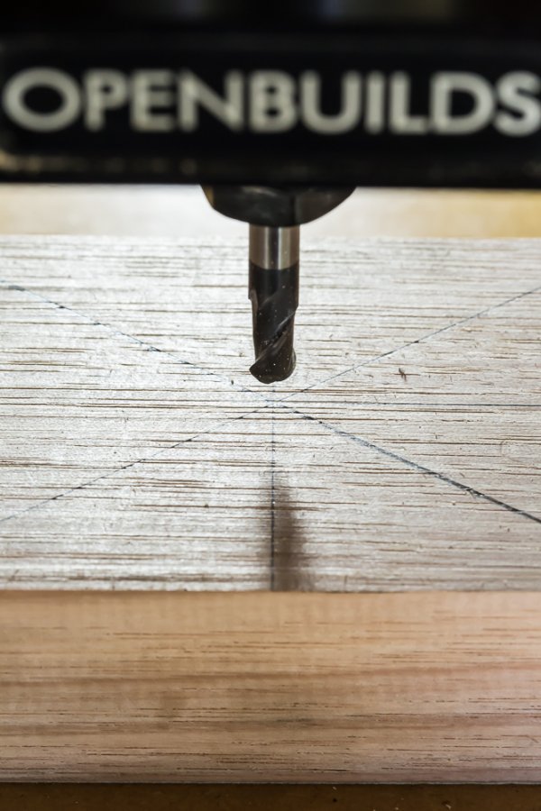

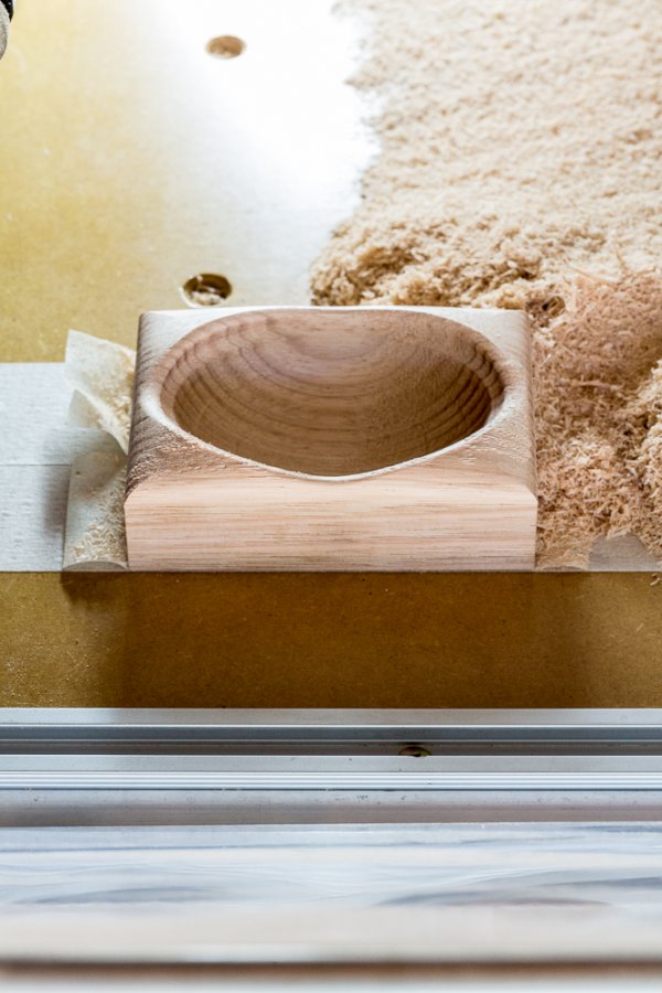

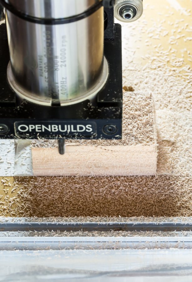

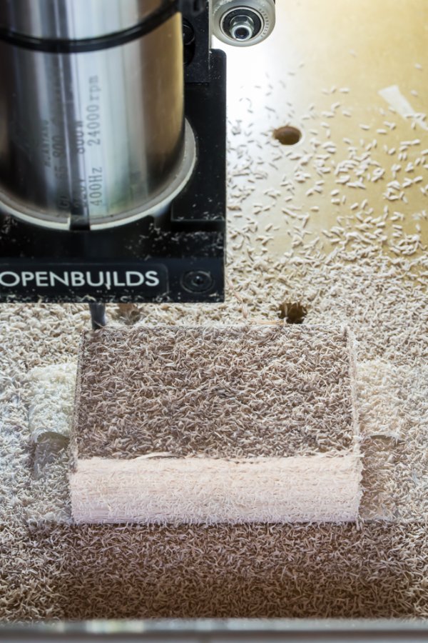

    Forgot to setup fusions G-code exporter and it homed at 100mm/sec, "swear I could here crickets Justin"... now changed to 1500mm/min, which is way better...;)
    Still splashing around in the kiddies pool, "so much to learn Giarc". Having fun when I'm not frustrated, but getting there mate. Longer term plan is to be able to carve out aluminium moulds, but I know I've got a ways to go yet. Some Hardy Heads I'm working on... Just got to work out how to carve it out.o_O
    In the meanwhile just playing around with easier stuff..., not that Mountain Ash is easy... more suited to friction fits for turning out Green Turned Bowl insides, I think.;)

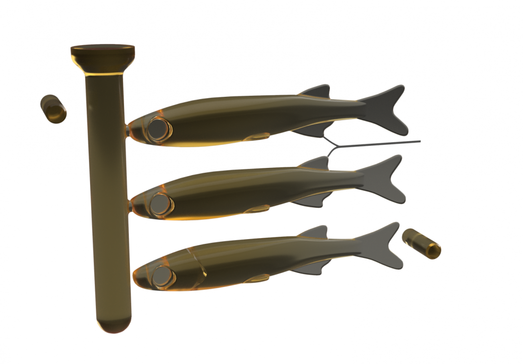

  7. Giarc
    3,062
    1,715
    You had me at fishing mold:). It is funny you mention this, because carving aluminum molds was one of the main reasons I wanted to build a CNC. That, and to make trophy plaques for the fishing derbies I help run.
