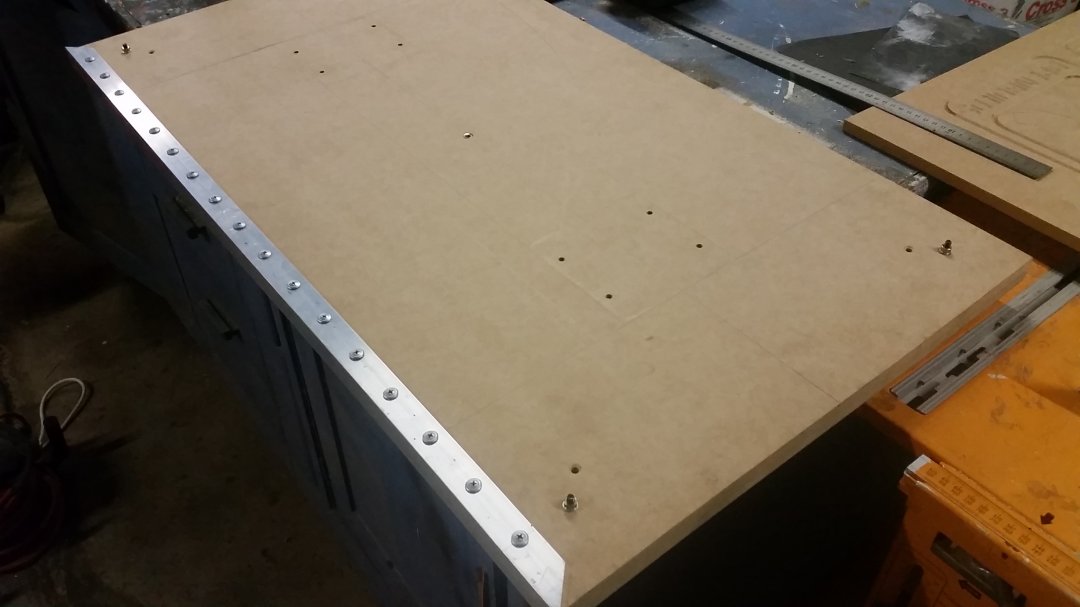

    Has anybody tried using an extra set of vertical supports either C-Beam or V-Slot in front of the X Axis Beam, I imagine this might help with the twisting as the X Axis then should no longer be able to twist at all but it will not help with the Flex due to the length, If anyone has a couple of extra 250mm Lengths of C-Beam it may be worth investigating.
    This was something that crossed my mind after the build and I will most likely try it but will have to order some extra Beam Lengths.
    On a another strengthening note.... I have not updated my log yet but over the Christmas break I pulled the Base Board off and fitted 20mm Aluminium Angle completely around the edge of the base board using screws every 50mm, This pulled the Base board into being very flat and no longer has a Visible sag between the two Y Gantry mounts, I suggest this should be something all XLarge builders do to there machines if using an MDF Base Plate as per the Build Manual.
    I was going to also route slots in the middle of the board to mount Angle inside there too but the strengthening on the outside edge has worked so well I really don't think it needs it now and the perimeter strengthening should be enough for most users, so I am going to stick with it as is.
    I will post some pictures tonight and provide a link.
    Cheers Glenn.

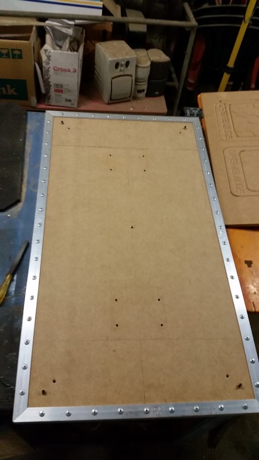

  5. Glenn Weston
    Glenn Weston Journeyman
    Aug 1, 2016
    91
    150
    Here are the pics of the Base Board Strengthening that I did using Aluminium Angle.....

    Looks sweet Glen, you went all the way with the neat mitred corners...:thumbsup: I went down a slightly different path; I will upload some picks in a little bit, so you can have a sticky beak.

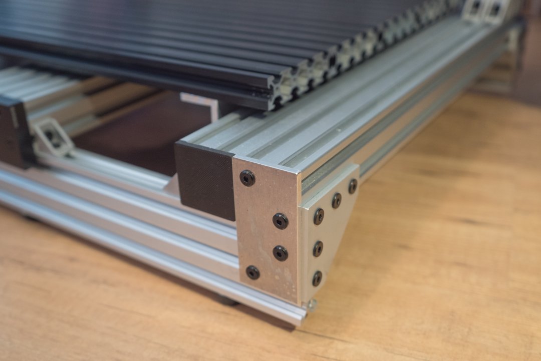

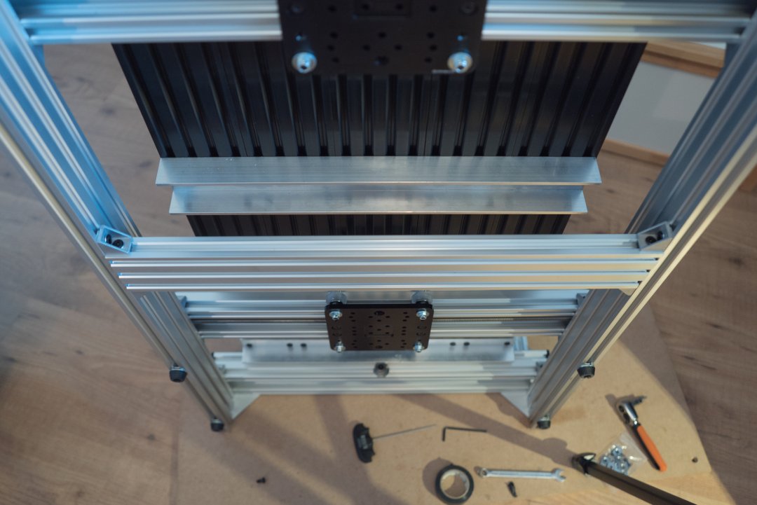

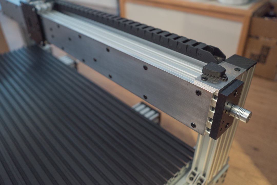

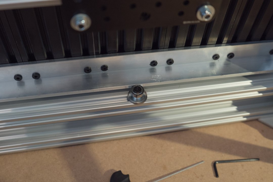

    I finally got the time (and parts) to work on my first round of upgrades:)
    Switched the 20x60 on the sides to C-beam. This gives me 20mm more Z-height and something sturdy to grab when I need to move the machine. You can also see the v-slot table =D
    Used one of the leftover 20x60s as a cross member. Feels good since the machine will be moved around a bit. To assembly the v-slot table I used a 30x40x30x4 u-channel in the middle and 30x30x5 angles for the sides.
    I could feel some deflection on the ends of the table. Luckily I was able to support the edge with a bearing :D. The aluminium will eventually wear a bit, but there is some room for adjustment when that happens.
    I also got this 6mm aluminium plate for cheap, so I thought why not test it. Just needed longer bolts and extra spacers for the X-gantry. So was it worth it? I think so... Sure there is still deflection, but there is not much difference between the ends of travel and the centre, which means I moved the problem to next weak link - the wheels, bolts etc...
