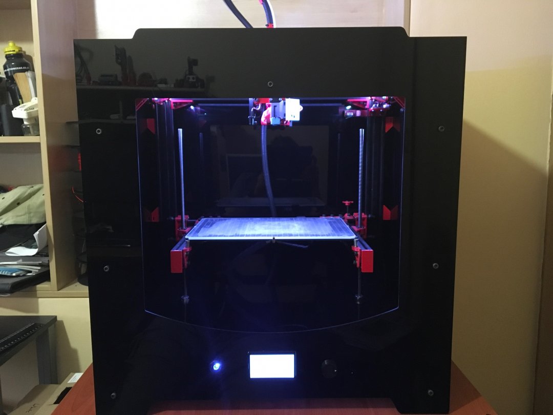

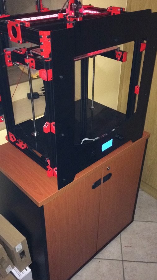

  5. markdoll01
    Jul 16, 2016
    21
    29

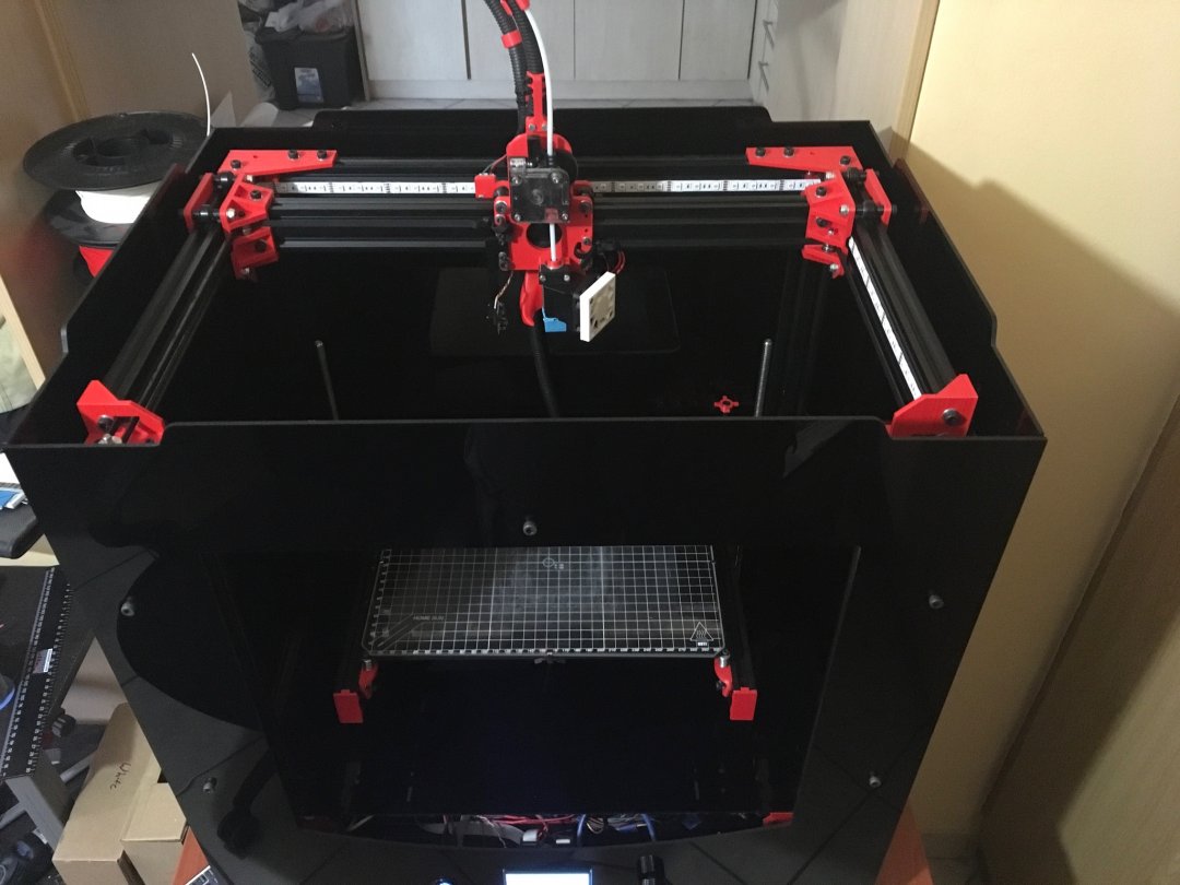

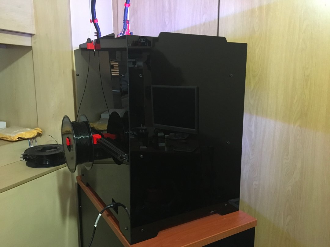

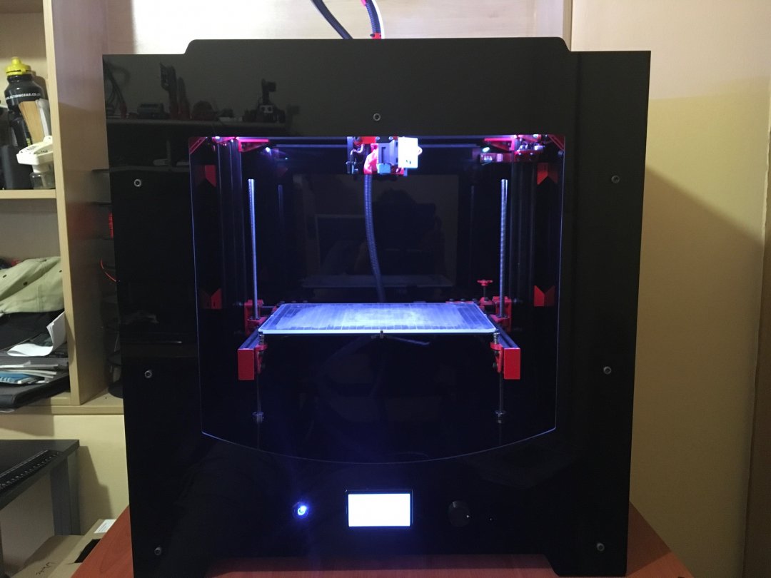

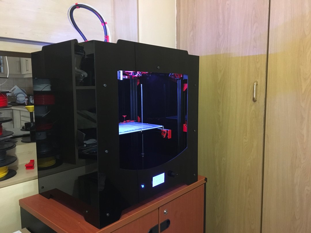

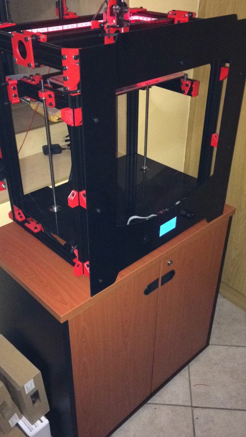

    Hi All,
    Just want to show off a little bit. I cut 3mm perspex panels for my D-Bot on my MPCNC machine from vicious1 and I think it came out very nice.

  7. markdoll01
    Jul 16, 2016
    21
    29
    Hi Carl,
    Thank you. I have not tried ABS yet, before I do I want to reprint some parts in PET-G just because I am afraid that some parts might warp when I start to print ABS. Just not easy getting PET-G here in Namibia and I have to order from overseas and costs are quite high. I hope to have PET-G in the next 3 to 4 weeks and then I will try ABS.
