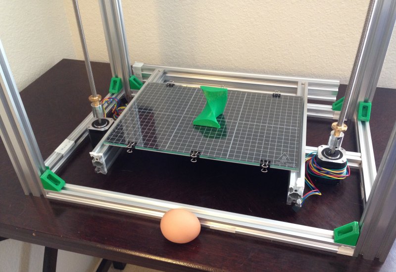

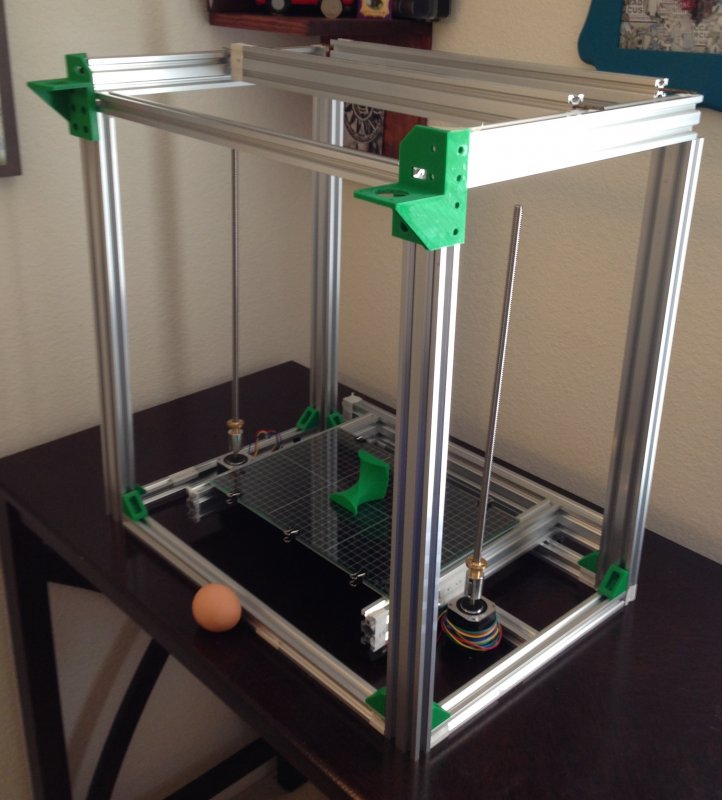

    Jun 10, 2015
    127
    65
    Thanks for the upload of the endstop files!
    I couldn't resist doing a preliminary dry fit build while I wait for my MrMetric hardware to arrive. I didn't have a banana for scale so I used an egg. Going with an 8"x12" bed with 12" build height. Parts are being printed on a Robo3D.
    For anyone looking for a good cutting method for the rails I had some great success with this $25 blade, it gave perfect burr free clean cuts of the v-slot with a miter saw:
    http://www.amazon.com/Concord-Blade...=1436882538&sr=8-3&keywords=non+ferrous+blade
    Carl Feniak and Mark Carew like this.

  21. Carl Feniak
    Carl Feniak Journeyman
    Mar 18, 2014
    654
    246
    Nice, what pitch lead screws are those? Looks more shallow than 8mm so should avoid the issue CapnBry had (but kinda hard to see in the pic).
  22. trublu832
    trublu832 Well-Known
    Jun 10, 2015
    127
    65
    8mm lead screws
  23. Carl Feniak
    Mar 18, 2014
    654
    246
    Well in theory you should be fine anyway as you will have the same Z force component as me and the wheels should take all the moment forces. Was just curious as it looked different in the pic,
