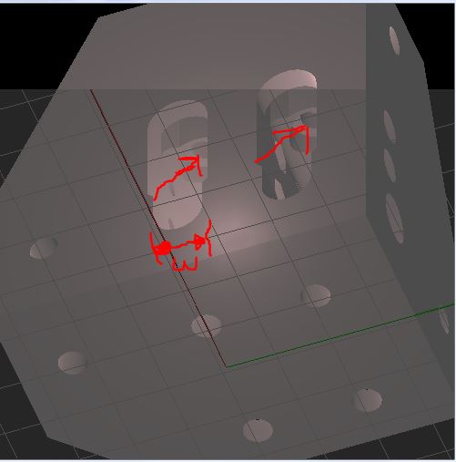

  13. JCPhlux
    JCPhlux Well-Known
    Apr 19, 2014
    209
    48
    ok @Carl Feniak
    I think this is my final design that I am going to print. I believe I have redesigned it with sloping overhands so the printer should handle it. Can you take a look and tell me what you think.

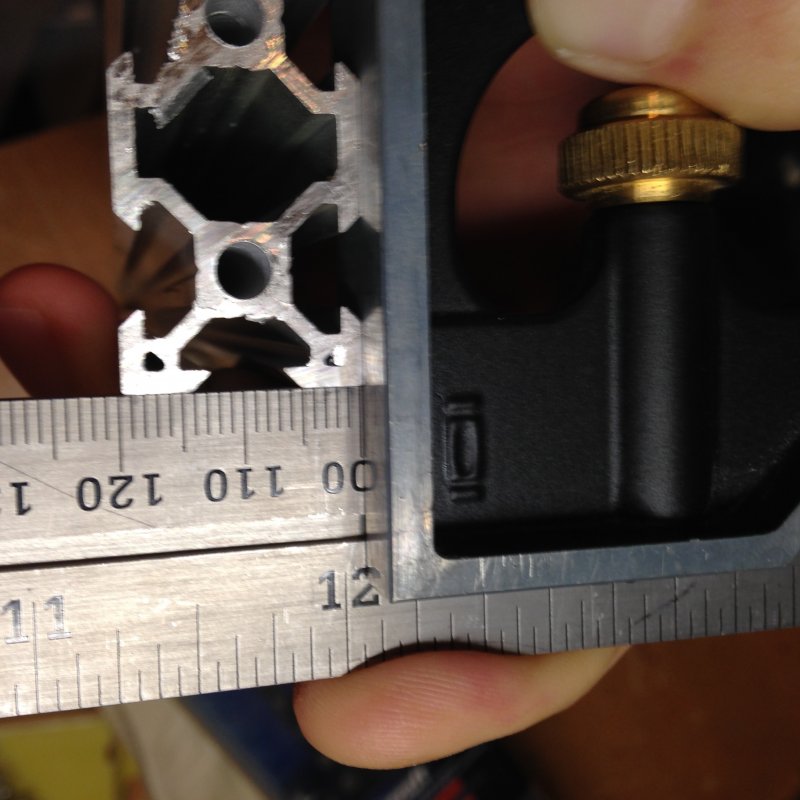

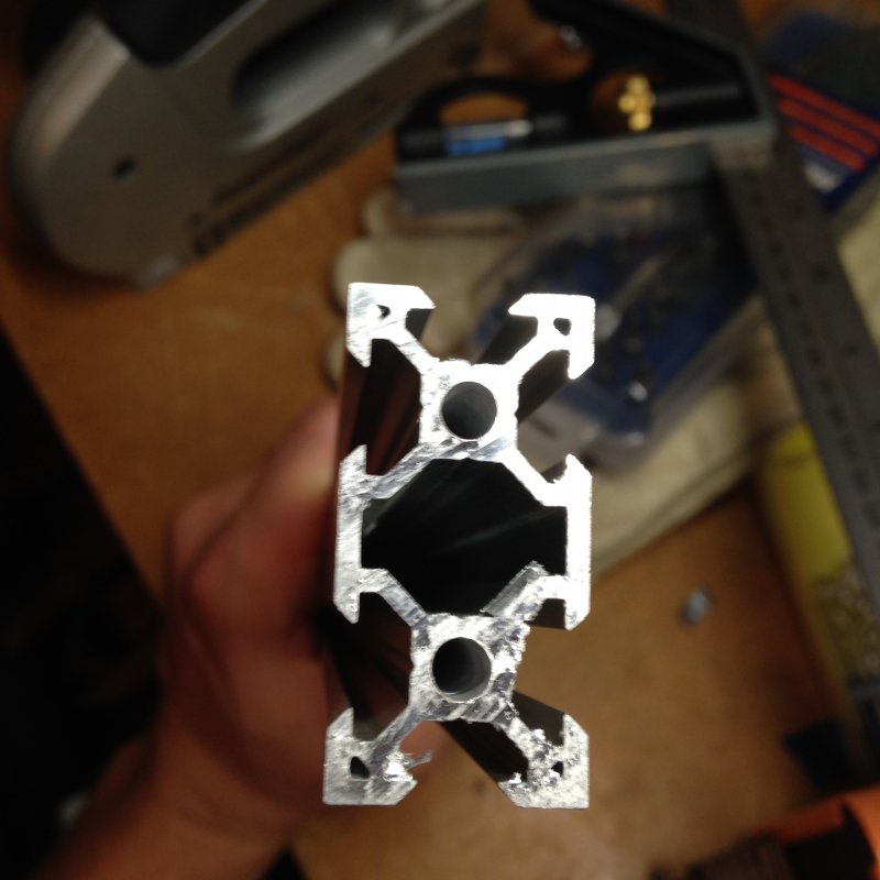

  14. Carl Feniak
    Carl Feniak Journeyman
    Mar 18, 2014
    654
    246
    I took a few pics of my extrusion for a visual. It may be an optical illusion, but I still think the extrusion inside corner fillet are too big a radius.
    Something I like to do to help my slicer (slic3r) print holes in a bridged section, is to put a 0.2mm layer at the bottom of the hole so that the first layer bridges right across the hole. You may want to consider doing this for the two holes shown below.
    What is the width "w" in the pic above? If the idlers clear this then no concern, but if not I wanted to make sure there was enough room for a M3 washer between the to idler bearings, a width of about 8.5mm.
  15. JCPhlux
    JCPhlux Well-Known
    Apr 19, 2014
    209
    48
    I wonder is the design for the extrusion has changed. looking at the screen shot that I built from the v-rail spec sheet it should clear. But you are right it does look sharper in real life.
    0.2mm layer bridge is a great idea.
    below is the measurements.

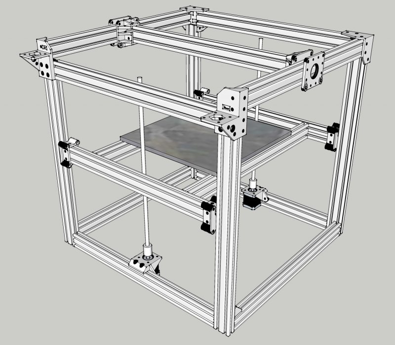

  27. Giuliano M
    Giuliano M Well-Known
    Apr 3, 2014
    193
    39
    I'm considering building one of these C-Bots, but I wanted to use one of these (heavy) basalt bed substrates in a 300x300mm size:
    http://store.quintessentialuniversalbuildingdevice.com/product.php?id_product=51
    However, since the plate is very heavy (8 pounds), what do you think of supporting the Z gantry at four points, like this (image attached) ?
    I am thinking you could put the two Z rods in the middle of the two left-to-right bars, the ones with the bearing supports. They'd still be out of the way of the XY gantry.
    Or do you think there could be binding?
  28. Giuliano M
    Apr 3, 2014
    193
    39
    Something along these lines is what I was thinking.
    Of course, with the rods being in the center of the front and back, accessing the build plate from the "front" where the motors are mounted could be awkward... but then you have plenty of access from the sides.
    The plate in the middle is 300 x 300 mm, and most of the 20x40 pieces are 500mm long, except for where they had to be cut shorter.
    The 8mm lead screw rods are about 425mm long, easy to cut a 1000mm rod in half.
    NeoGames76 likes this.
  29. Carl Feniak
    Mar 18, 2014
    654
    246
    I've seen others that have used a similar setup with smooth rod and linear bearings. It seems that they don't have any issues, but my concern is that there is a risk of slight teetering left and right. The actual forces involved would be quite small if everything is balanced, but an unbalance can also create a constant predictable force direction. You might get away with only eight V-wheels, either all inside or outside the extrusion.
    Only speculation.
    The alternative would he a heavy duty redesign of the current Z arrangement to full size solid V wheels, dual plate setup, and 20x60 or even 20X80 extrusion.
