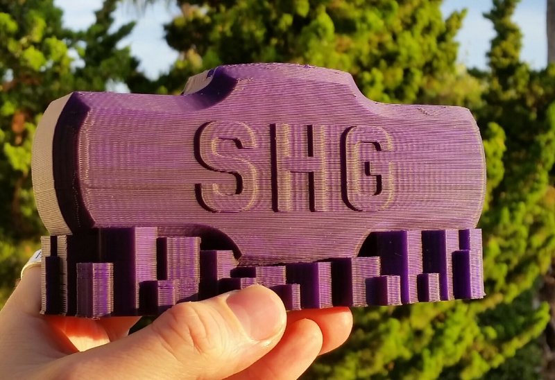

    Wow 8mm, I am currently using 1.2mm with a normal sized nozzle and MBI stlye hotend. Such a difference direct drive makes. What are your thoughts on the volcano? I got an eruptor pack in the mail this week, and a .8mm nozzle for my current setup. I am hoping to get it installed this week. I did manage to get my printer straightened out. It was the 6th attempt at rewiring steppers/endstops/inverting axis that finally did the trick. I did manage to get my printer to match a replicator. X=width,Y=depth and homing to min @ back right corner. My first try, and I'm not sure quite how I did this one, switched endstops and inverted XY axis settings, caused the Z to travel the wrong direction.
    If I remember that brisket was a 28# packer when it started, smoked for 30something hours, that cutting board is a jumbo from work and does no justice to the scale of that brisket. I had the heatermeter setup on a cheap akorn kamado, giving it oven like accuracy. It would hold whatever temp I set it to, indefinitely, I cooked bread, cookies, biscuits, cake and even lasagna on my grill. We are buying a new house here in NorCal, its coming with a Kamado Joe, I am super excited for that. Big ceramic grill like that should have a thermocouple.

    Just because I own one, Wanhao makes a duplicator i3, same price point, steel frame, super reliable direct drive extruder, enclosed electronics that are not mounted on top of your Z azis( makes the frame much less pendulous).
    Since I was again pleased with my printer, I decided to mess with it some more. it seems that a 1.2mm nozzle is just what the doctor ordered. I installed the volcano heaterblock and big nozzle onto my direct drive all metal stepped bore thermal barrier. printed my first cube and decided that i only needed to back down the extrusion multiplier a touch ( .05 ). WOW thats a fat nozzle.
    75mm/sec *1.2mm nozzle*.6 layer height = 54mm^3/sec Thats a lot of plastic. Watching the spool turn is almost hypnotic. I will post some more vids in TripleC thread.
