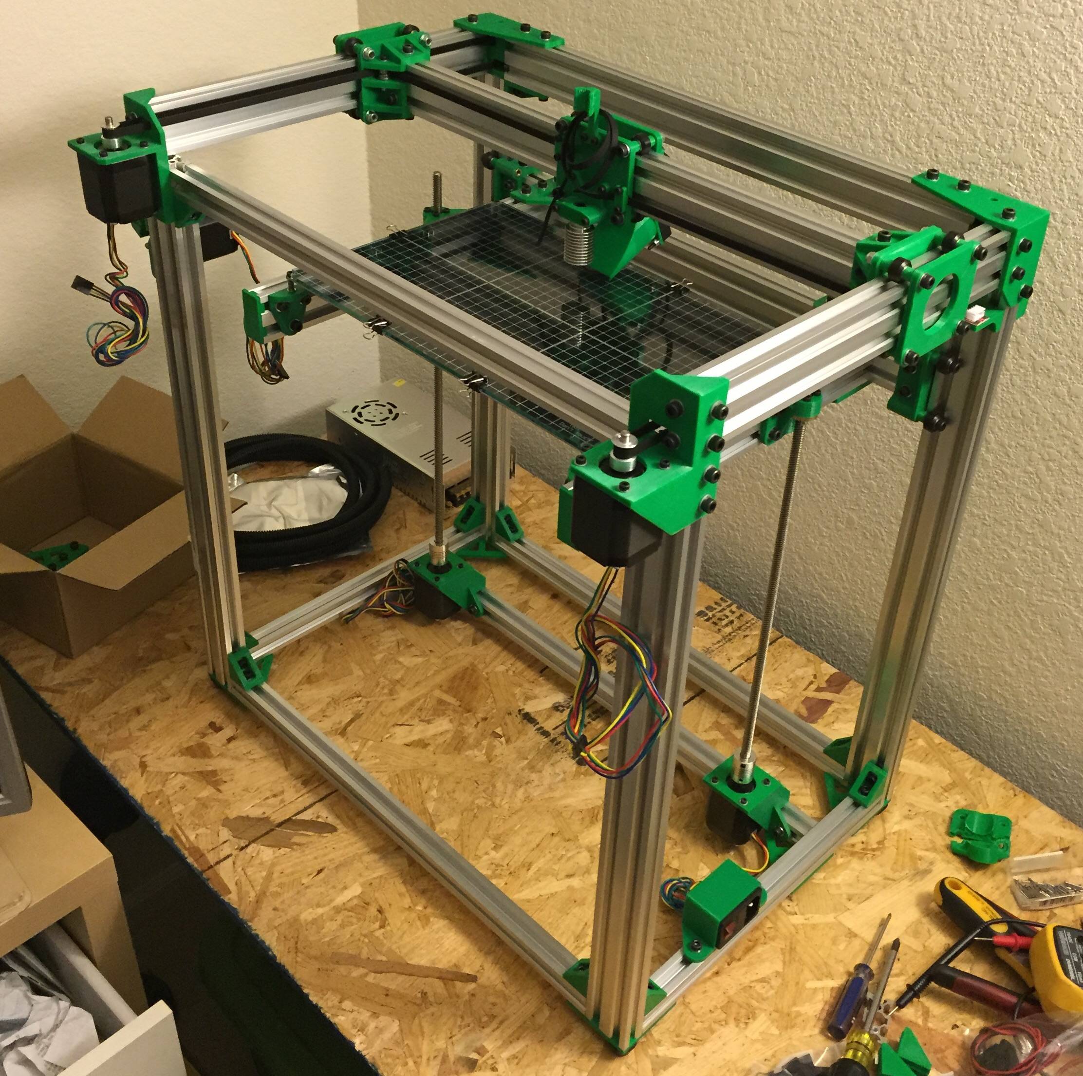

    Hi,
    First I want to thank Carl for a great design and all the other people for great ideas in this comment section!
    So far I've just ordered all the parts (300x300x390) and am eager to start building in a few weeks!
    Took a while to find a good heated bed and by reading the comments it seems like I'm not the only one trying to find a 300x300 mm 24V bed.
    At the end I went for a silicone heated bed:
    http://www.aliexpress.com/item/3D-P...e-Heater-300-x-300MM-24V-300W/1879743629.html
    But from the start I wanted to get a kapton heated bed due to its light weight. Did contact a seller about this and figured I might copy/paste his reply in case anyone wants to get one:
    I have checked with our engineer of factory.
    We just have the Kapton Heater at 300mm x300 mm, we just have 12V 400W, the unit price is USD48.80 including China Post shipping that will take around 15-20 days to arrive.
    If your prefer 300mmX 300mm 24V 300W, we have to open a new mould for you and the tooling fee will be USD85.00. It will be not cost effective.
    Any questions, please do not hesitate to contact us.
    Thanks and best regards
    Julie
    JSR Industries
    Link to kapton heatbed shop: http://www.aliexpress.com/store/613950

    Interesting, never came across the kapton heaters before. I guess you could slap four of these on!
    http://www.ebay.ca/itm/120mm-X-150m...-thermistor-Kapton-Heater-3-PCs-/131606554073
    ... except they are sold in a 3 pack.

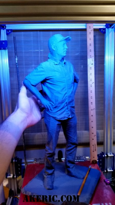

    using ur 0.12 settings I got this Benchy
    I'm still working on 3D Hacker - it keeps coming loose, I need to add a brim to it
    #1008 ruggb, Oct 12, 2015

    That's pretty sweet.
  21. trublu832
    trublu832 Well-Known
    Jun 10, 2015
    127
    65
    That print looks amazing Eric, now we can see why you went with such a tall printer height!

    Great print @AK Eric and very nice blog on your taller C-Bot build. Did you do any anything different (mods) with your Build to Carl's posted build that could be helpful, you maybe willing to share?

    That is awesome, looks amazing.
    No issues printing such low layer with such a big nozzle? <-- doesn't appear so
    You struck a good pose so that no support was needed to print. Fluke or did you have that in consideration? Did they clean up the scanned file for you?

    Thanks everyone :)
    @Mark Carew : Other than some mods made to the z-stepper brackets (done by @sheffdog , and I believe posted in this thread), its all the same hardware, other than longer extrusions.
    @Carl Feniak : No problems printing that res: I did some simple maths: If a .4mm nozzle will do .1 layer heights (high-res for it), then a .6mm nozzle should do .15 layer heights. No issues. I did that pose on purpose at time of scan, thinking I may print it in the future. They did do some cleanup, but the mesh they provided had weird anomonilies sticking off it in places I had to cleanup in meshmixer.
