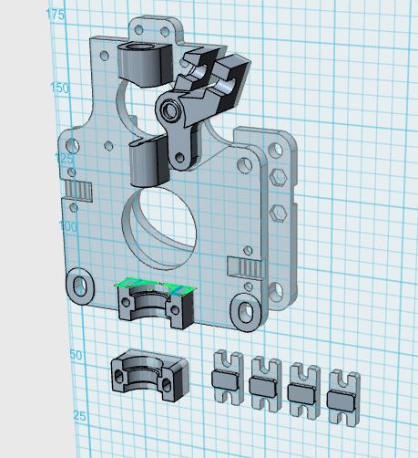

    Alright, who wants to design a light single nozzle direct drive extruder carriage?

    I am concerned about the moving mass of two stepper motors. Sharp corners and other large acceleration/decelerations will create a lot of vibration and cause ghosting. You'd really have to clamp down on those limits.

    Here ya go. Beta version, please provide recommendations on changes and note any fitment issues. I have not used or even printed this.
    It is meant to be used with a bowden tube to guide the filament to the carriage and a short length of tube to guide it down to the nozzle from the direct drive extruder.

    Awesome. I'll get this on the todo. Since I have a spare stepper laying around this should be pretty plug-n-play...

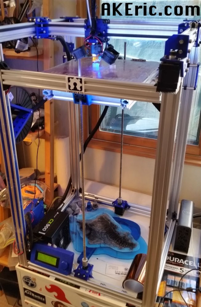

    Hey C-Bot community: This afternoon I decided to rearrange my dual-rear-leadscrews into a front\rear leadscrew setup. I've been thinking about going triple-leadscrew, but that would require the purchasing of more\new hardware. Figured I'd give this a shot since it really doesn't take anything extra, than a spare cutoff piece of v-slot I ran across the front of the build platform.
    I've just started using it, it seems super stable compared to the regular (front unsupported) cantilevered bed. Can anyone come up with why this would be a bad idea? In my head this is a 'good thing' since the bed now has stability on two perpendicular axes. But I welcome any comments.
  26. trublu832
    trublu832 Well-Known
    Jun 10, 2015
    127
    65
    This is essentially what I did but I set up a lead screw on either side, takes all of the torque off of the wheel assemblies and avoids the diving board effect.
    Carl Feniak likes this.

    @AK Eric Have you given it a try yet? The only issue I see is a risk of left/right stability. The V wheels may be enough though. I like that you added a cross piece on the bed frame, I actually had that my original design (though at the midpoint), but forgot to actually install it.
    I like the way @trublu832 modified it slightly better as it reduces the canteliver but still stabilizes left/right. It costs a piece of extrusion, but it also allows easy adjustment on that bar to align with the bed frame.
