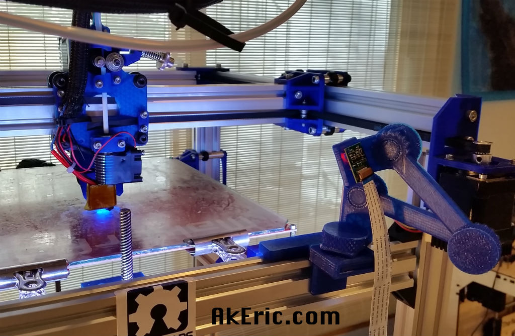

    Just an "fyi" : Got Octoprint up and running on my cbot. Not necessarily cbot directly related, but I did do a slight mod to the camera mount to make it work with the 20x40 extrusions. Anyway, if you've been looking into Octoprint, I have a couple blog posts talking about it, and link to the prints needed to pull it off:
    Setting up OctoPrint
    Building the C-Bot 3D printer: Part 31 : Setting up Octoprint

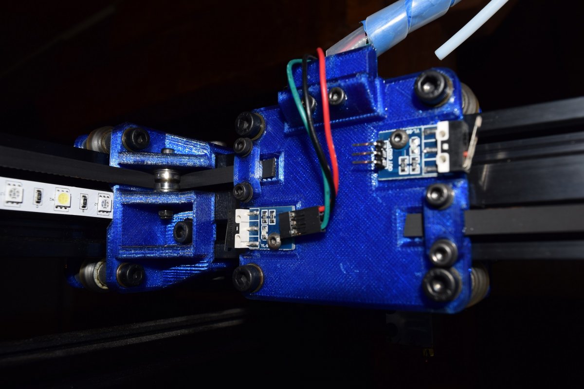

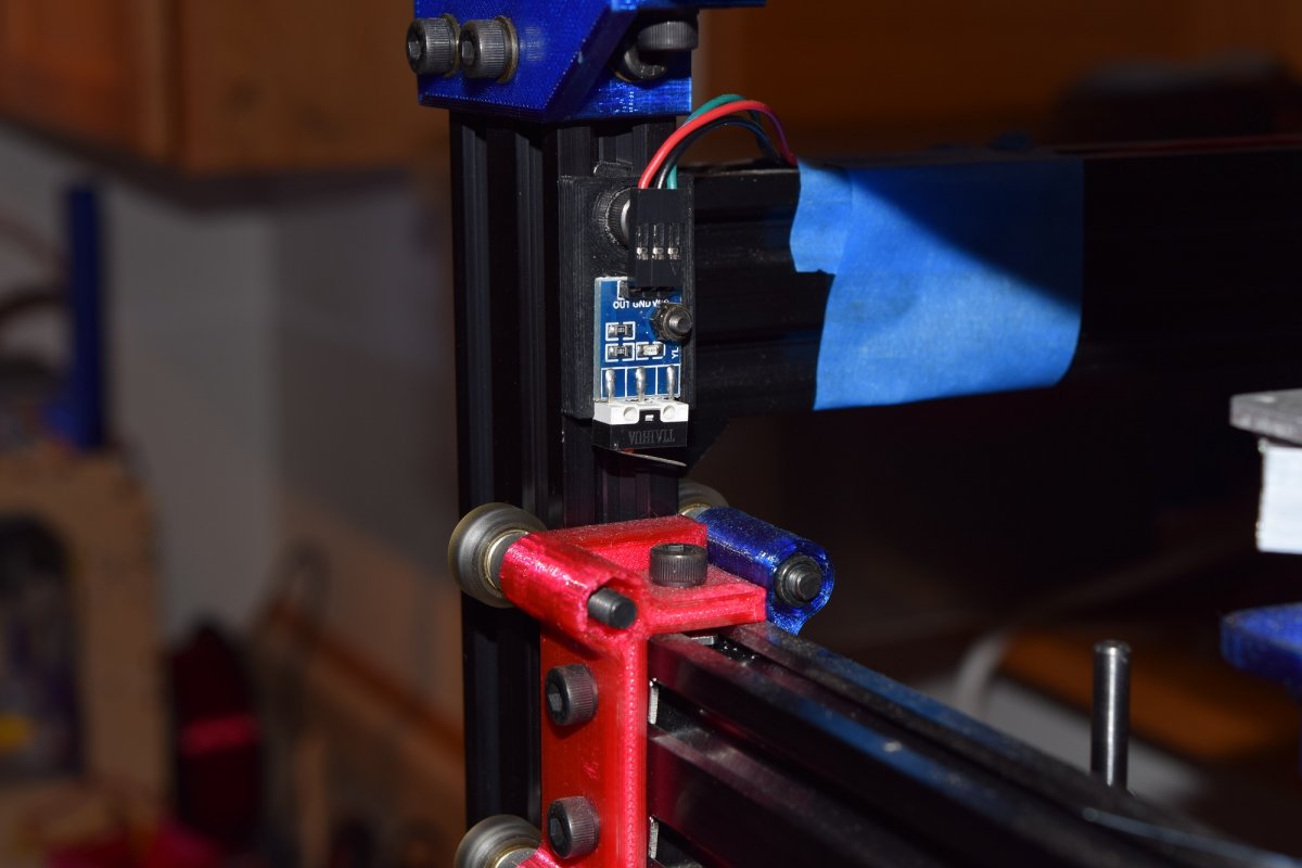

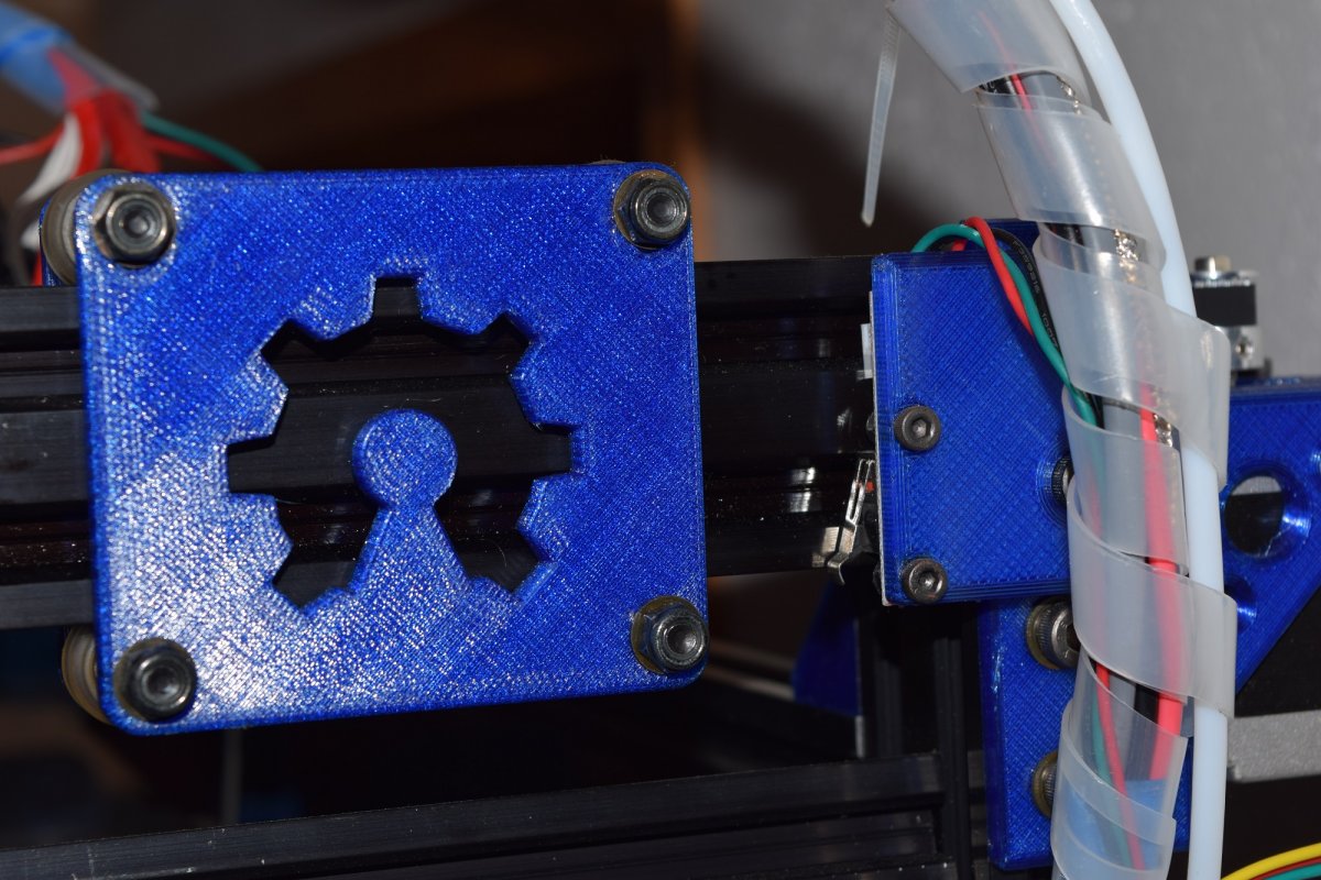

    I will add my endstops in the mix, Carl and I share the Y axis stops. I chose the other orientation switch for my X and Z stops. The Second endstop on my extruder carriage is for future use. After clearing the build plate and cooling down to ambient temp the gantry will cycle to Xmin, I home to Xmax, and shut the power off.

    Could you provide a link to those endstop switches? I like the smaller form factor.

    My coworker has octoprint setup and it is pretty cool. Would definitely provided some piece of mind for letting a print run while I am at work. Remote visibility and termination would be excellent.

    That sucks, at least nothing else burnt up!
    How are you tightening the derlin wheels? I see you got rid of the slotted holes.
    I like your endstop setup on the rear plate, what is top bolted piece for?

    @trublu832 here's the link. was posted just a page back also, its a nice tidy switch. I will dig out the cad model of it and post it, makes modeling easy.
    @Carl Feniak The slots are still there, but I have a washer over them. Hasn't been an issue yet, but adding eccentrics has been on my long term radar. The bolted on part for the top is a strain relief, my umbilical is supported by two 3mm filament pieces inside the spiral wrap.
