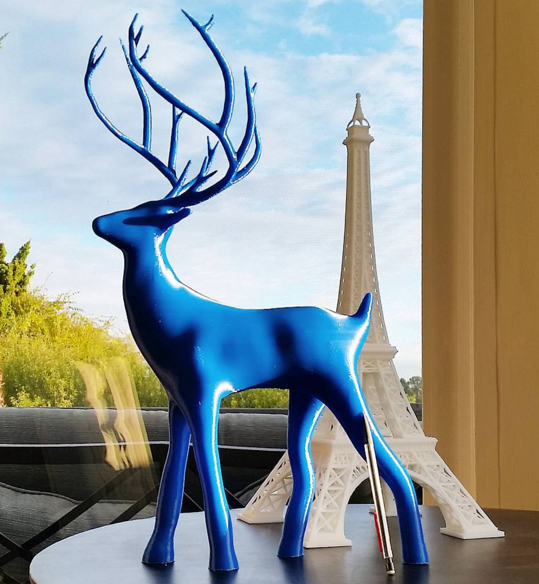

    Have I mentioned how much I love this printer? 9 hour, 20" tall reindeer last night, plus a timelapse:
    300 micron, 90mm\sec, .6mm volcano
    Surface quality is really nice.

    Wowie Eric. That might just be the coolest thing printed yet.

    That's so awesome.. :) I really like your "manual support" action when the belly bridge printed.. lol

    ;) That manual support system has got a lot of comments on the interwebs. I should try and patent it...
    No wait, I think I'll go open source... :p

    Ditto on the support assist. Here's my go at this Eric's model.
    I'm just at the tricky part (head and antlers). We'll see how it goes.
    Carl, I'm one of the guys who've missed the spacers inside the wheels. I'm glad you mentioned that.
    I couldn't for the life of me figure why I couldn't get the wheels to spin freely without leaving the bolts just loose enough.
    I've ordered a boatload of the 1x5x8 shims and can't wait to see if it smooths out some of my ringing.
