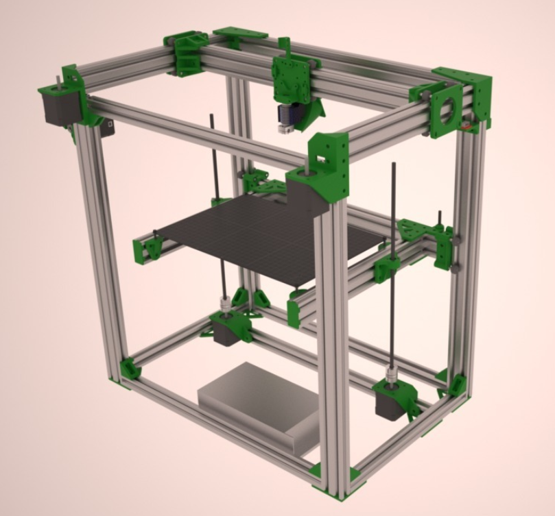

    Two motors on a cross beam is what I went for, Carl mentioned the front back motor arrangement which is what Eric did. They seem to have about the same mechanical stability, both require an extra piece of extrusion. Either way, I think 3 lead screws is only necessary with a very large or very heavy bed.

    Thanks, that is the kind of info I need.
    It was a toss up between the 3 different Z axis mods as they are all good and seem to be working well (2 front back, 2 offset, 3 with one driver). If I get a bunch of feedback to go otherwise then I am still open to changing it.
    Why the 2 front/back then?
    -avoids cantilever altogether (seems to be a point of concern for many even though @trublu832 just posted a beauty of a print)
    -simple to implement, one small piece of extrusion needed, which can be adjusted slightly for alignment purposes
    -less parts and complication than 3 lead screw, cost also down
    -two screws can still be linked with a belt and idler if desired for sync (not to drive, just to prevent them becoming out of step)

    I wanted to choose one Z axis modification as then the BOM, extrusion calculator, and 3D rendering will all be simpler (less work for me).
    Here is another option:
    I don't restrict the user from using any of these three Z axis options with the modifications and instead include selection options in the BOM and extrusion calculator for the different Z setups.
    Obviously more work, but then the builder can still go with their choice of Z setups all they all have pros and cons.
    This may impact my ability to implement the side corner brace I mentioned, but I can see if I can't make a work around. Or perhaps with all the other bracket enhancements it really won't be needed?

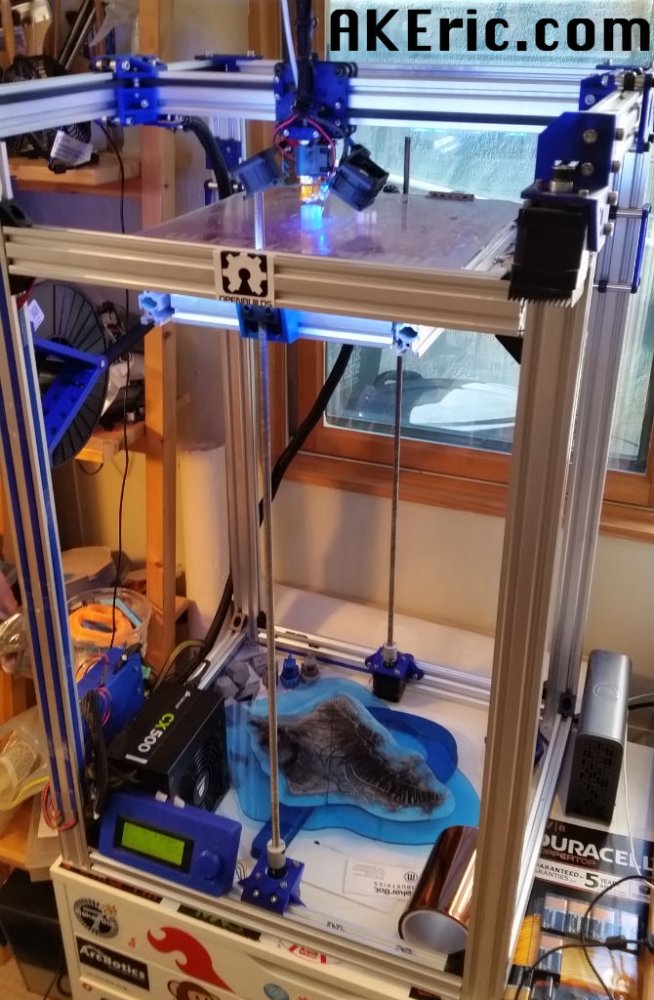

    @Carl Feniak : I've found one specific 'issue' of the front\back leadscrew\stepper arrangement, really just realized last night: I turned on the 'lower platform on retraction' option, and... it did a lot of 'squeaking' during the retractions as it lowered and raised the bed (specifically on the 'raise' part): Previous, with both leadscrews in the back and I enabled this option, there was really no noticeable sound. But on the front leadscrew, where it goes through the acme block, it 'squeaks' now: If I shove a bunch of grease in there it cuts down on the sound.
    I've not noticed anything bad happen because of this, print quality doesn't suffer (and again, the build platform is far more stable overall), stepper temp seems normal. Note that when the bed lowers between layers, there is no noticeable sound. Even when the bed raises after a print it doesn't sound out of the ordinary either, until it gets to the veeery top, and it squeaks a bit. Which now makes me wonder if my squeaking is isolated to the first few inches of print, (and my print last night was only a few inches tall...).
    Just tossin' it out there. This isn't to discourage anyone from trying, and I have a feeling if anyone went the ballscrew rout this sound would probably just 'go away'. I'm thinking it's the added friction of that front leadscrew on the acme block lifting the weight of the platform, since grease seems to help.

    Yeah, could be just a bit of increased friction from minor binding or accumulated debris. Hopefully nothing much to worry about. Still a bit odd since you have the derlin blocks.
