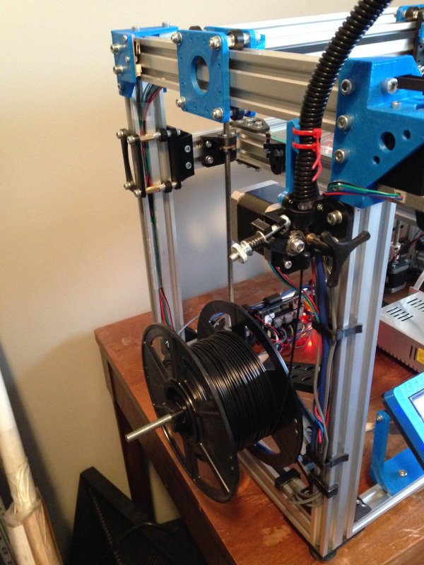

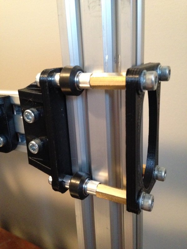

    I've added an "Assembly" doc to the files section. More work then I figured. I skipped the wiring/programming/tuning sections but if you have questions just ask.
    Also, inspired by JCPhlux I installed this mod just today. Goal was to use the same concept as I used on the CoreXY portion for the Z axis. Since the 20x40 extrusion is oriented in the opposite direction I had to come up with a modification. I used 20mm M5 stand off to resolve this (25mm stands would of saved me a 1/4" spacer but I couldn't source any). What do you think? I had to move the extruder to the front to accommodate.

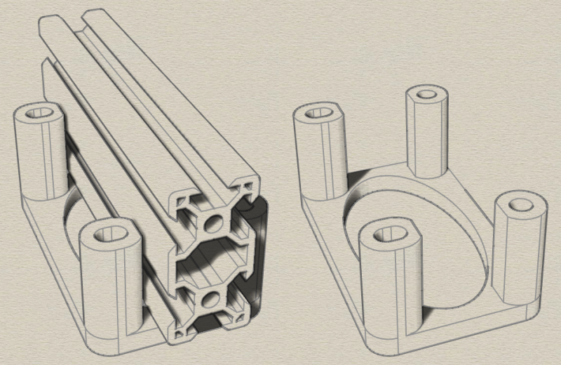

    you could do this to save the spacer.

    Openbuilds sells aluminum spacers and low profile bolts of varying lengths that would reach out past the 40x20 extrusion with a nut on the outside of the outer bracket. Wouldn't a solid axle bolt for that entire length provide better accuracy and strength?

    The printed extension would work, but they require using 55-60mm bolts, right? Sourcing metric is surprising hard in Canada which is on the metric system!
    I think I could get them on Element 14 but would have to order 50, if not 100, of them. It would definitely be a better way to go then what I've done with the standoffs.
    It was mainly about symmetry and consistency with my CoreXY design as the cantilevered design was a carry over from my H-Bot. Also, there were some concerns mentioned about the Z setup so I wanted to present an alternate. This mod can be extended to work with 20x60 extrusion as well (I had created it to share but somehow deleted the files).
    The cantilevered design does work and I had my extruder mounted and wired to that leg so I didn't want to move anything. Then JCPluux got me thinking more on this when he started planning a shift to 20x20mm extrusion. This is what I came up with that enabled me to use my current 20x40 leg design. Did a test print yesterday and all is running well. I'd say either design is fine.

    I used a long spacer instead of adding another 8 v-wheels for a cost savings. I knew from my previous design that they could handle the loading of my build plate. It would work though and would increase the rigidity as Derlin has some give to it.
