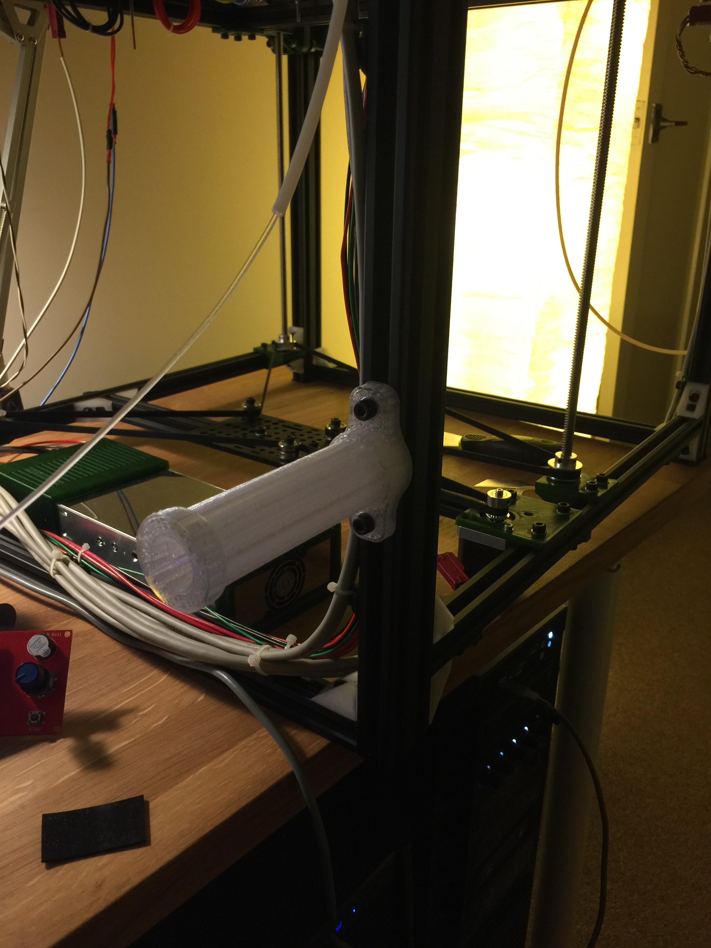

    Hi All,
    Quick update on my c-bot build.
    Extruder 0 is allocated as the volcano with 1.2mm nozzle. Very different to set-up in comparison to a 0.4mm nozzle with regular size melt-zone. Thanks @AKEric for the simplify3D settings on your blog. Your retraction, speed, and layer first layer settings saved me a lot of headache!
    My max volumetric extrude is coming out at about 17 to 23mm3 / sec before my extruder starts skipping. Might have to investigate why that is a bit lower than some figures mentioned in this thread.
    First print was a spool holder (pictured) for the side of my enclosure. Done at 0.6mm layer height in clear eSun PETG. Super, super strong print. Absolutely no way i'd be able to bend it by hand. Excuse the lighting. The print is shown without any finishing. Retraction still needs fiddling with to completely remove the small blobs at layer transitions.
    As for extruder 1, I'm short on PTFE tubing, and the only length i have left is slightly too short to reach to the (rear left) home position.
    Next up is a longer bowden, calibration of the e3D 0.4mm nozzle, electronics enclosures, and some sort of stationary wipe surface to the left and right side of the print bed, attached to the X gantry mounts.
    Tool changes, and the volcano nozzle being stationary is going to be a nightmare with ooze. The 1.2mm nozzle oozes about 15mm of excess filament before it goes below the glass temp of PTFE, Better i have a solid tool change procedure with a fixed wipe surface than 1.44mm width ooze walls around each part I print.
    Finally, thanks again Carl, and everyone in this thread for their input. Very, very happy with the printer so far!

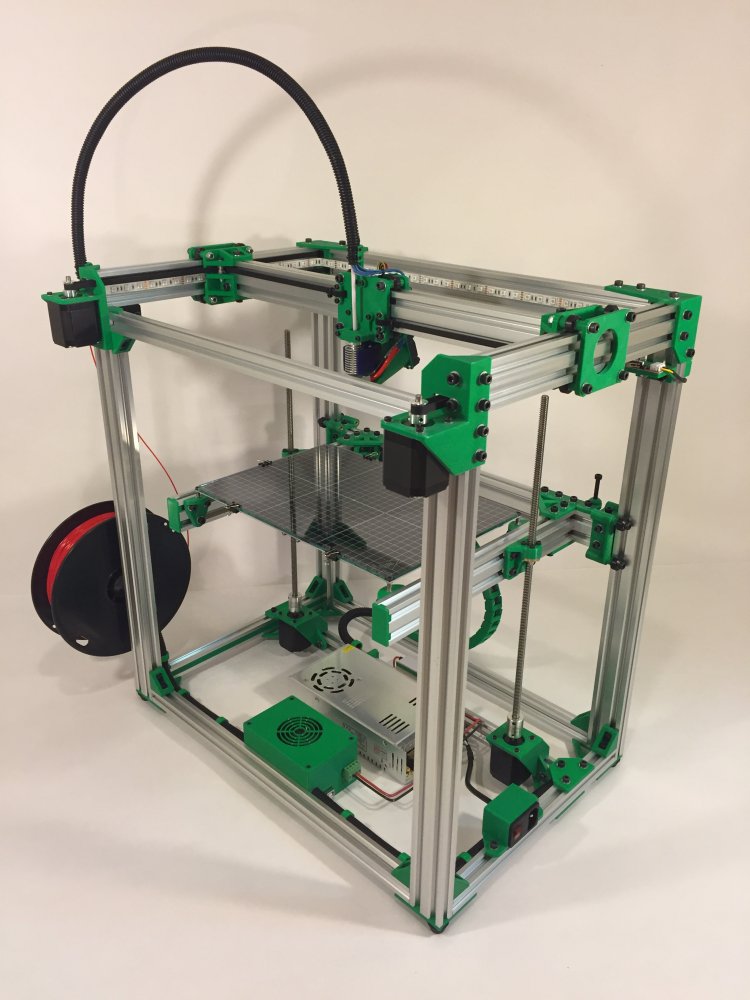

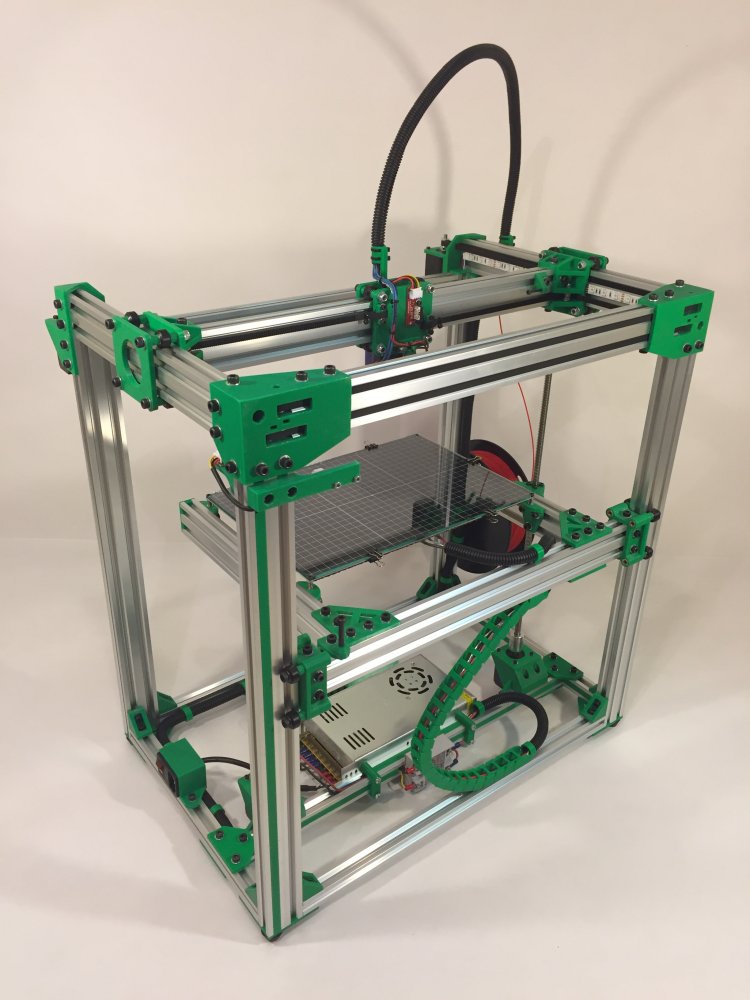

    trublu832 Well-Known
    Jun 10, 2015
    127
    65
    #1646 trublu832, Feb 1, 2016
  27. Austin Seagers
    Austin Seagers Well-Known
    Oct 13, 2015
    88
    48
    That really is one of the cleanest builds I've ever seen. She's a beaut!
