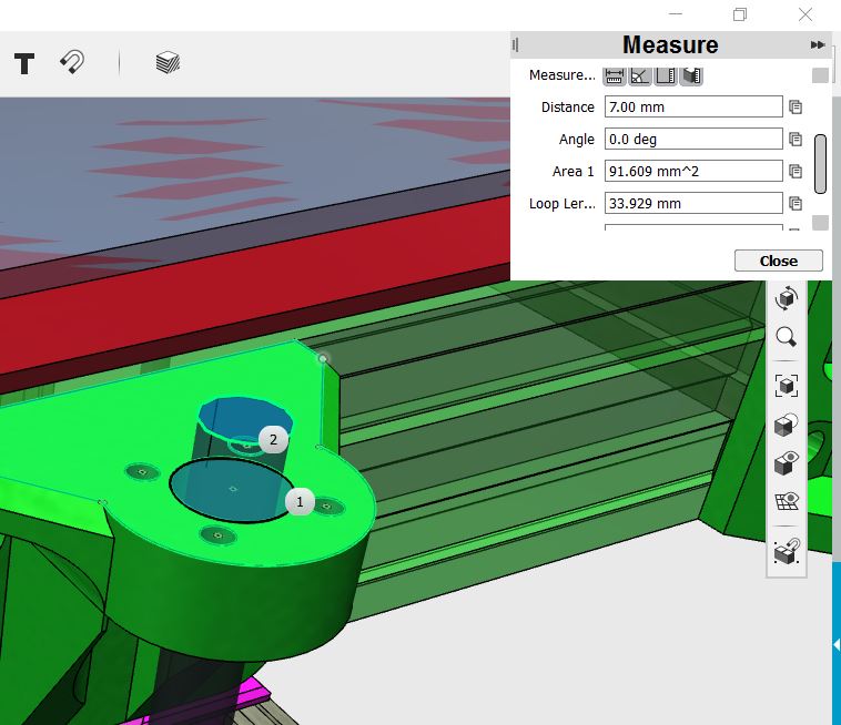

    That's a good one as long as you are happy with the height. Obviously you will need a 5mm to 5mm coupler instead of a 5mm to 8mm. You can see how much "extra" length I left sticking out the top in the rework assembly file.
    I went and did that for ya:
    Less conservative, but less wastage then the original C-Bot. I roughly modelled an E3D v6 in there so if you are using a shorter hotend will need to adjust as it looks like the top of your lead screw is turned down for a bearing.
    As for the number of starts you are fine. You have more torque due to the better mechanical advantage and will be more resistant to self turning when off and under weight. The only sacrifice you are making is speed, which isn't really important for the Z axis.
