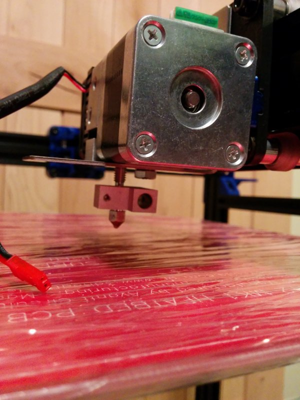

    I will set up X and Y to home to min, the back right corner. The XY steppers will be the rear of the bot, due to the single centered lead screw. 0,0,0 for me will be the center of the build plate. I believe that using ramps put the origin in a corner?
    That switch looks perfect, it should fit nicely between the belt clamp and the nut for the mini-v. I may just mount the switch on the gantry plate, and cable it to the rest of the board elsewhere, I will also order one or two of those arduino switches to play around with. Adding a striker plate to the XY bar end was not too difficult, I am pretty happy with it.

    I finally moved the end switch onto the carriage.
    Here is my modified carriage back plate but I doubt it will be much use to anyone as my carriage is longer than normal to support by heads. Like Adamcoooks I had to add a flange to the XY Bar end, my one is on the other side, and I think I have the mount upside down, so it may need mirroring.

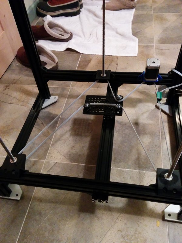

    IMG_20150210_211718.jpg IMG_20150210_212005.jpg IMG_20150210_212037.jpg Last part just ordered from sdp-si. Just a mock up, i need to rent a miter saw and a weekend with no snow to use it.

    Is that GT2 belt? Did you order a loop belt or are you going to splice it somehow? Coming together nicely.

    Gt2 belt, pictured is the open ended belt for the core xy I used to measure. Came out to 1870mm which of course sdp-di was out of stock. Two, closed loop, coming 1820mm and 1910mm I should be able to make either work by moving some idles around

    I did shank the measurement though. Looks like if I want dual extrusion I will have to go bowden. I not completely sure I will acually be able to hit 100% of the HBP. I may loose 5-10mm of Y travel. My nozzle is further from the ganrty plate with the direct drive

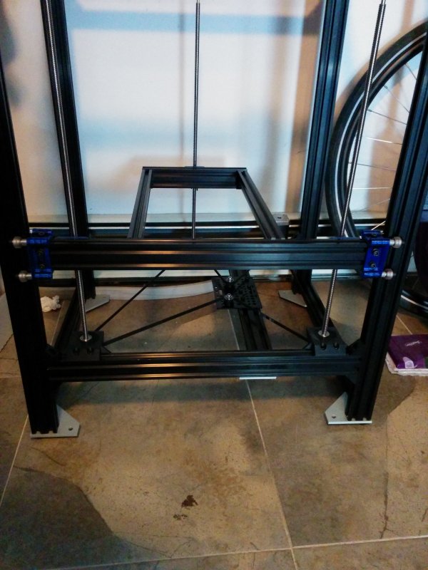

    IMG_20150216_112822.jpg I have a question, more on the Vrail side, I think you might have some insight on it. I am trying to figure out what cut vrail with. I am on the fence whether to buy a miter / chop saw or a tabletop band saw.
    I used a 12" miter saw to cut the bulk of the frame, which i rented from Home D. It was a 700$ makita, and it was quite nice. I have an upcoming decking project, so I was able to slip a 12" miter saw from harbor freight past the wifecountant,. I did make a few cuts with it, to finish up my Z stage and crossmember for belt idlers, and I am not sure I want to keep it.

    I used a mitre saw on my extrusion as well. Even used a wood blade and it cut no problem. Of course a great choice for a deck project too. Better than a band saw as with a band saw you have to move the material, which can be heavy, long pieces for a deck, and for a mitre saw you move the blade.
    A chop saw or a band saw are perhaps better choices for cutting extrusion, but less versatile tools for what I think an average person would use in other home projects and hobbies.

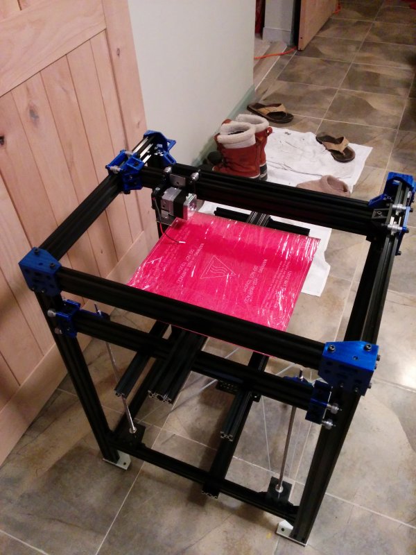

    @Nick How tall is your Z axis? How much twist do you get?
    I have some concerns with the amount of twisting I am getting with mine. Granted it is mostly only "mock up" straight, but it is firmly screwed together. My veritcal legs are 700mm. I am using the original Z ends with 1 row of wheels, I am thinking of adding a 20x20 cross member in between the steppers and the idler corners, mounted on the outboard track. Made me some 100mm corner brackets. I have been messing around with Fusion 360 90degreerender.jpg
    @carl Do you remember the dimensions of the grooves you designed into most of your parts? the ones that fit into the vrail. I extruded the 10mm rectangle 1.5mm, then applied a 1mm fillet. It looks like it should fit nicely, but I wont have time to print anything for testing until next week.

    My machine is 650mm from base to top. I've set the print area to 350mm, it seemed like a nice safe value to start with, and I haven't been bothered to adjust it.
    There is absolutely no flex in the frame from top to bottom (left to right, or front to back).
    Whenever I move my PursaI3 around it goes out of alignment and needs readjusting. I didn't what a repeat of this on this machine, so I went overboard with the corner bracing. Everywhere I can put a 5 hole-90 degree bracket has one, everywhere that can have a corner piece also has one, and if I can get both in it's even better.
    I used the aluminium corners until we ran out of stock in Australia, and then switched to the printed ones. The printed ones worked as well as the aluminium for holding the corner, but give no sideways support but two together fixes this.
    My build platform has a bit of flex in it, it seems that no matter how hard I try to get the play out of z axis wheel, when the have to take the weight of the build platform it compresses the wheels and flexes the wheel mounting bolts a little. It isn't much but with the leverage thing it becomes apparent when levelling the platform.
    Another problem with the build area is it bounces, a tap on the front will cause it to bounce up and down a few times, this causes it to need re-leveling. I replaced the plastic mounts on the bar with aluminium ones, which reduced the bounce problem a lot, but hasn't eliminated it. It doesn't effect the print, unless I drop something on the front of the build platform.
    You shouldn't have these issues because of your lead screw at the front of your built platform. This is something I'll have to look at doing in the future, I'm just monitoring your build to decide if I should use a belt like yours, or 4 stepper motors.

    You could move two of the BP mounts to the sliding bar, it would move some of the weight off the cantilever. Have you considered a counter weight?
    If I stand over my bot and grab it like a steering wheel, I can get a few degrees of deflection. I just ordered another stick of 20x20.

    This would be more noticable on your 12" bed versus my 8" (front/back). Why would you have to re-level your bed though? Why doesn't it bounce back to where it was?
    Switching to the aluminum brackets would help keep the frame more rigid. It looks like your bed springs are well compressed so you probably don't get too much bounce from those. One factor I've noticed is that the flexible couplings act a bit like springs at the bottom of the lead screws. Some of the travel you are noticing might be the whole assembly moving up and down.

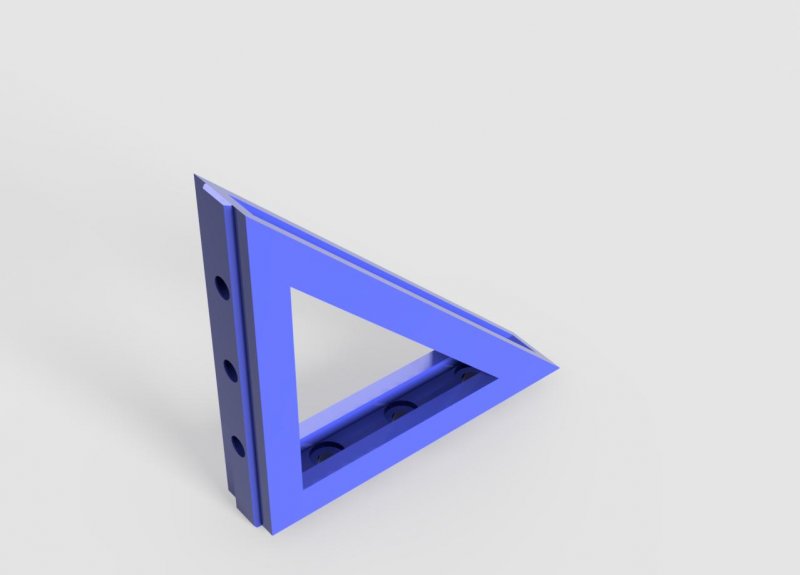

    Are you using the original L brackets? These were specifically designed to mount in a pair around a 20mm side of extrusion. As Adam noted, they have just a bit of comperssion built into the dimensions so that they clamp as you tighten them. If you are not using them in a pair over a 20mm exturision, but rather across the span of your printer, then you would need to have the dimensions of your frame just right for this to work.
    The newer brackets have build in adjustment to them, still designed to work over a 20mm span, but will also give you 1mm of adjustment with the slotted holes.
