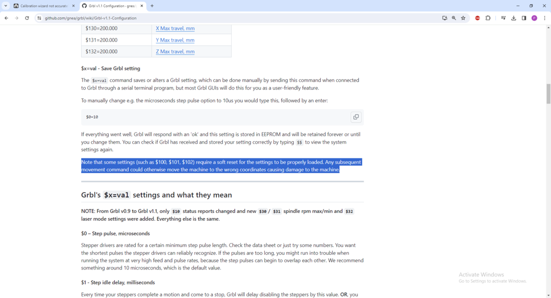

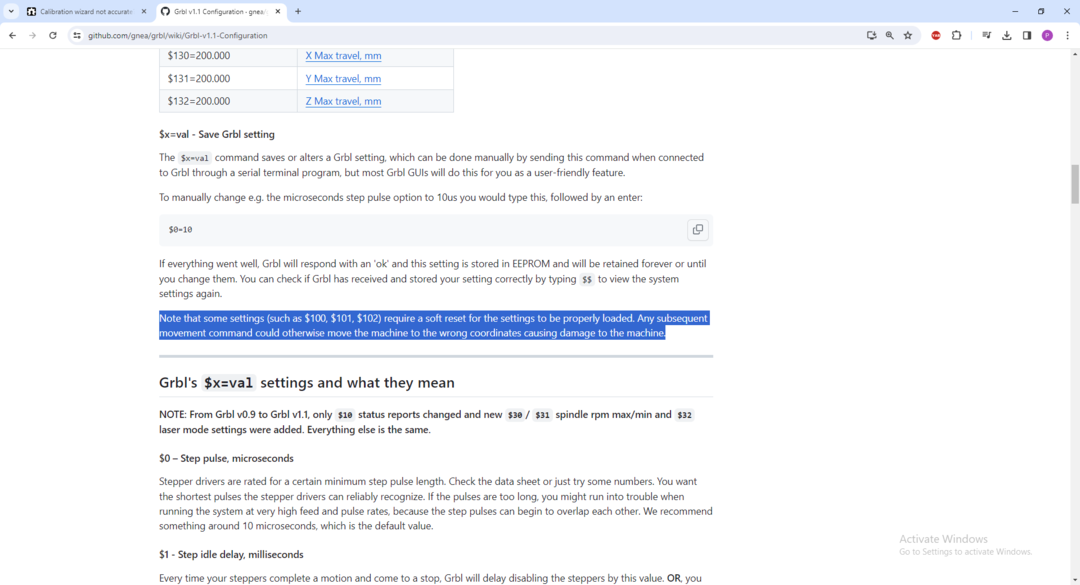

    Last minute thought: You are remembering to RESET (reboots the BlackBox) after applying a calibration change. Before testing and retrying calibration? You need to give the controller a chance to boot up fresh with the changed settings first?
  20. Darklink594
    Jan 30, 2022
    20
    I did not know that!!!!!
  21. Peter Van Der Walt
    Builder Resident Builder
    15,700
    4,508
    That Grbl Wiki is sometimes a good read - not be skipped Grbl v1.1 Configuration and all other pages of the same Wiki
  22. Darklink594
    Jan 30, 2022
    20
    Well you'll never guess what happened, it works! I'll definitely give it a read and thanks another for you patience
