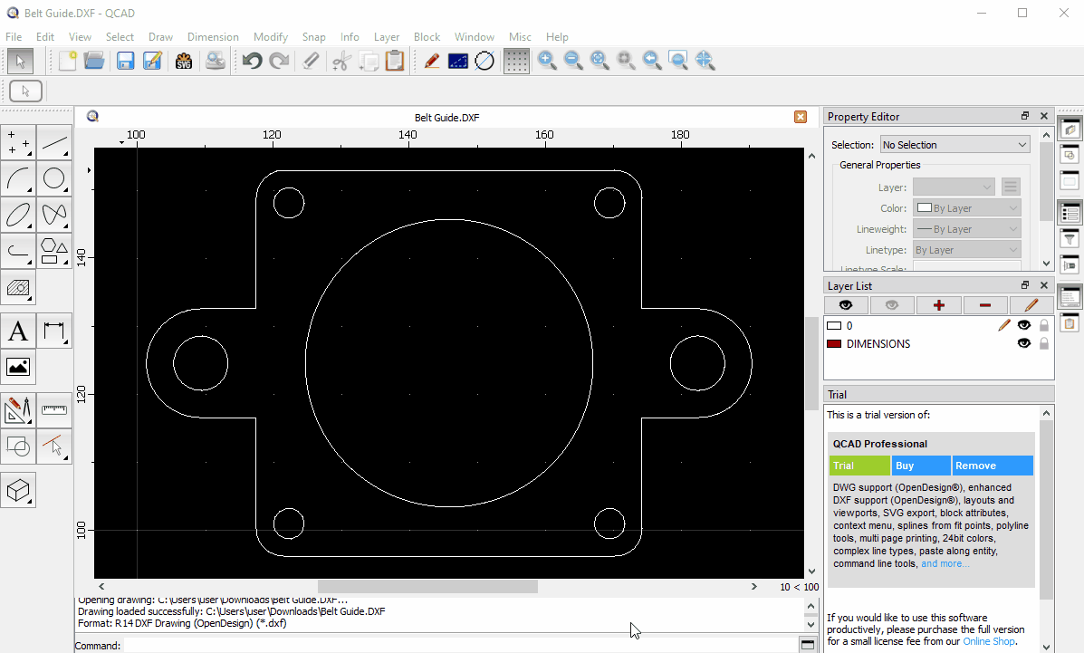

    I have finally finished the compact CNC Plasma build and after a load of faffing around, got the axes working perfectly.
    My test profile is a Solidworks drawing of one of the stepper mount plates. Bringing in a dxf resulted in some odd inverted curves and the main hole in the centre had a gap in it (which is not on the model) so I brought in a jpg and created the toolpath in one operation.
    transferring the G code to the machine results in a correct geometric cut pattern - but it does it twice. Eh?
    There are no chamfered edges and the drawing and jpg are 'clean' ie no double edges/lines.

    Did you convert the lines in your design to polylines and export it as an R14 version of dxf?

    Bitmap tracing is completely the wrong method for CAD drawings. But even so, that image is incorrect too, for a trace to work you want a sillouette not a line drawing : Potrace
    The dark line is a "shape" it has both an inside and outside edge.
    Either way, again, more suited to tracing art. Jpgs doesn't carry dimensions, etc
    If you already have CAD just use DXF. But make sure its all Polyline and exported as DXF R14. Simplest :)
    An Inverted arc means you still have an Arc (not a polyline). Convert it to Polyline

    Hi Peter. Well the outside shapes and arc converted to polylines but the circles won'r - I selected a circle and went to draw/polylines./ make polyline from selection and it does not change from circle. Hmm?

    Opened file in QCAD, used Mouse to drag over everything to select it, went to Draw, Polyline, Polyline from Selection
    I also moved it to proper origin - it was spaced infield a little, would be easier with bottom left origin. Converted file attached, but next time, just give QCAD a go, cleaning up DXFs is simple, and a valuable skill (especially when you start using others' artwork)

    No - not working. i imported this dxf into Qcad, dragged over everything and converted to polyline and it does everything but the circles!
    What am I missing - your dxf shows all as polylines

    Well this is what I get!

    I am a little ahead of you. V3.22 (You) vs V3.27 (Me)
    But we are both behind current, yours from 2019 (going on 4 years without an update :eek:, actually saturday's its birthday! good excuse from some grilling?), mine from 2022 (Birthday tomorrow lol sucks its a weekday, but hey - crazy we both installed the May version of some year), we should both try the latest though Version 3.28.1

    Also works fine in the latest, you should be fine after updating
  21. Richard9591
    May 6, 2023
    17
    Ta Daah. Fixed!
    Thanks Peter
