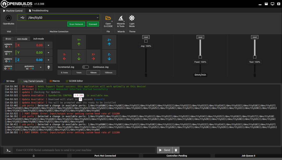

    I was calibrating my Z steps using the wizard and after saving all I get is an error about baud rate.
    I have shut the machine down, closed OB Control restarted and the error persists.
    15,698
    4,499
    ttyS0 in the dropdown you selected is probably a onboard serial port on motherboard. Pick the right port: i see ttyUSB in the list. Its a USB device
