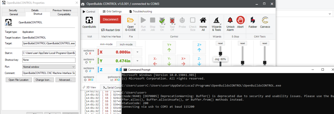

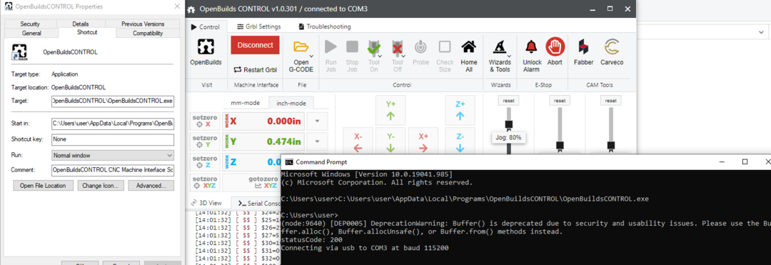

Not from event viewer. But you can run OpenBuildsCONTROL.exe in a command prompt to get some logging. Exe path is in the event above, or find it in the Target field of the desktop/start menu shortcut
Thats all good, its running. It didnt quit after or you'd be back at the prompt. It sits in the system tray on intial start:

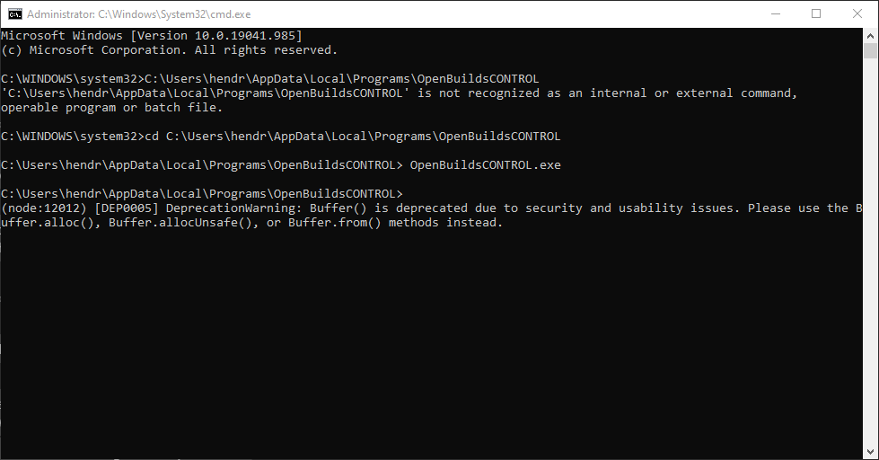

Sadly its not running. its not in the system tray or in the task manager. The event viewer also says that the program is terminated for an access violation.

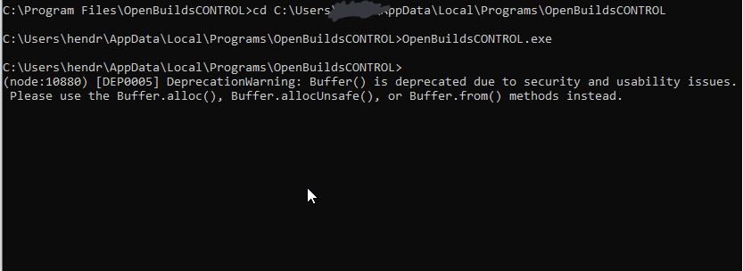

I could only assume from the cropped screenshot which does not show a prompt. Please include fuller screenshots to avoid the need to guess What happens after (in the log) If it was a port conflict, you'd see an error stating so

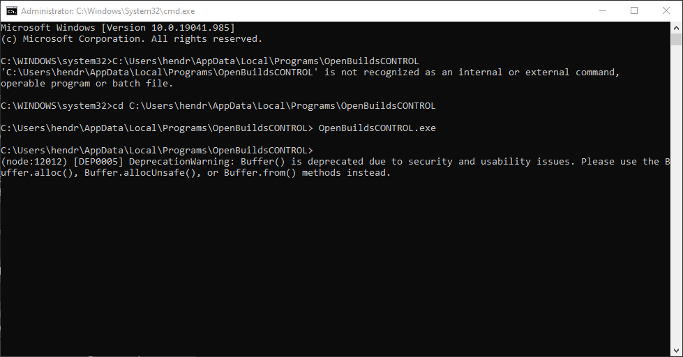

Sorry about that. That is the entire thing though. I will be more clear now to show that: The terminal does not go back to accepting prompts even after a while when windows has already logged the error. This is all that is seen and there is no additional text. when I hit enter then command prompt allows me to enter a new command.
Much better. Lack of stuff in a log (compared to a known good start on my log) also tells a story here... So, you are missing the statusCode 200 message that comes after succesfully downloading latest firmware images. So, either CONTROL is unable to download from the internet (firewall, etc) or has a problem with permissions on that PC and not allowed to write to disc. Uninstall, reinstall, but try the "for me only" install type - as you may not have write permissions globally on the user account you login with
