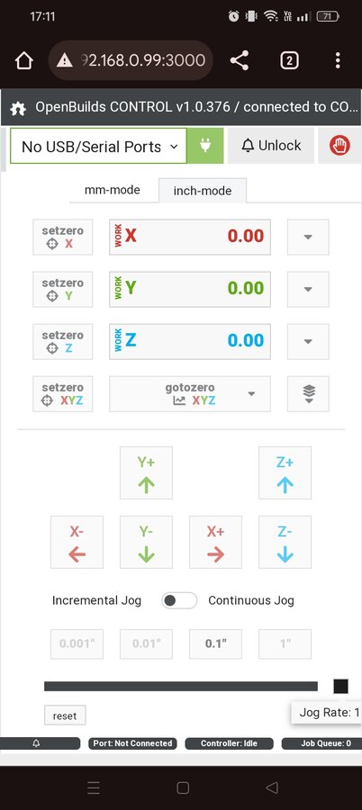

    Still works fine on CONTROL v1.0.376 on a healthy computer/network:

    Thanks Peter for the quick response. Typing IP didn't help.. Restated PC and scanned QR and worked. Guess port was not working..
