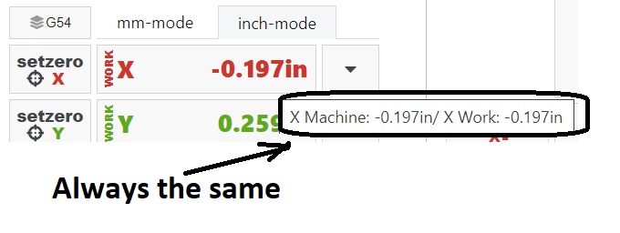

Hi All. I'm struggling with Control software not updating the work coordinates. When I press set zero on any coordinate, I think that's supposed to reset the work coordinate. However, after doing that, upon hovering the mouse over the axis coordinate, both the work and the machine coordinate remain the same. But, when I tell the machine to go to the axis 0 work coordinate, it actually does it correctly. So the machine will correctly drive to the new work coordinate origin but it doesn't display it correctly. I re-flashed the blackbox 32 with the ability to auto home the gantry axis independently using the grbl hal web builder from http://svn.io-engineering.com/. Could this have something to do with it? Perhaps the black box is not updating to the new work coordinates?
Did you use CONTROL to load a machine profile, or setup all manually? Our profiles sets reporting, if its been done manually check your $10=511 setting
