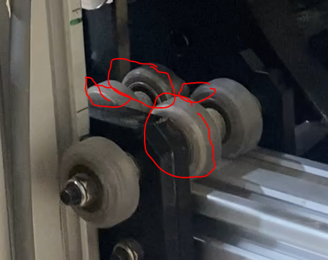

    I tried to cut a circul with my cnc and every cuts not perffect I caleprate the machine every thing fine all circular cut not fine. My controllar is blackbox X32

    This is the photo of cuts and x y directions. I use fusion 360 as cam post. I tried openbuild cam to cut it cut good. So maybe the problem in fusion 360 posts?

    Was the good cut and bad cut in the same place on the spoilboard? If not, could be a section of damaged belt in the section where the pulley was working for the faulty piece
    Also check grubscrews on pulleys and belt tension. From the image it looks mechanical

    looks like backlash in X

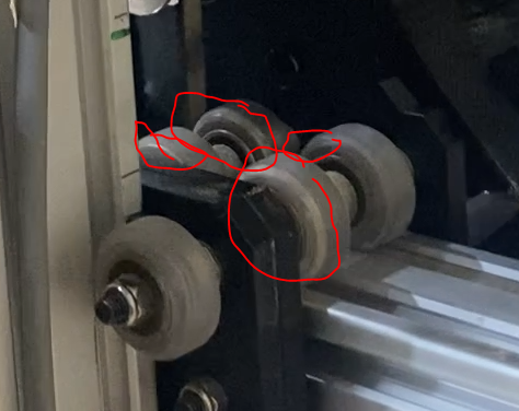

    Noises are incredibly hard to pinpoint via video. Up close your ears can zoom in on the precise point, and fingertips can find vibrations. I suspect belt over back of wheel, or similar.
    From the video those V-Wheels are shot - they were overtightened at some point and cracked, needs to be replaced.

    I will check them

    I did what you suggested. The vibration gone. But still same issue tha circle cuts same. Every cut it perfect I tried to cut 150 mm square It cut perfectly fine square corner and the size perfect.

    The shift is along the X axis - ie as mentioned before
    Disassemble the X-axis and investigate - something is definately moving that shouldn't - in an unexpected way - damaged belt needs belt off the machine in your hand - stretching to see where teeth pulls apart (damaged tensile backing). Feeling for axis play involves pushing and poking on the frame to see where it moves where it shouldn't etc.
