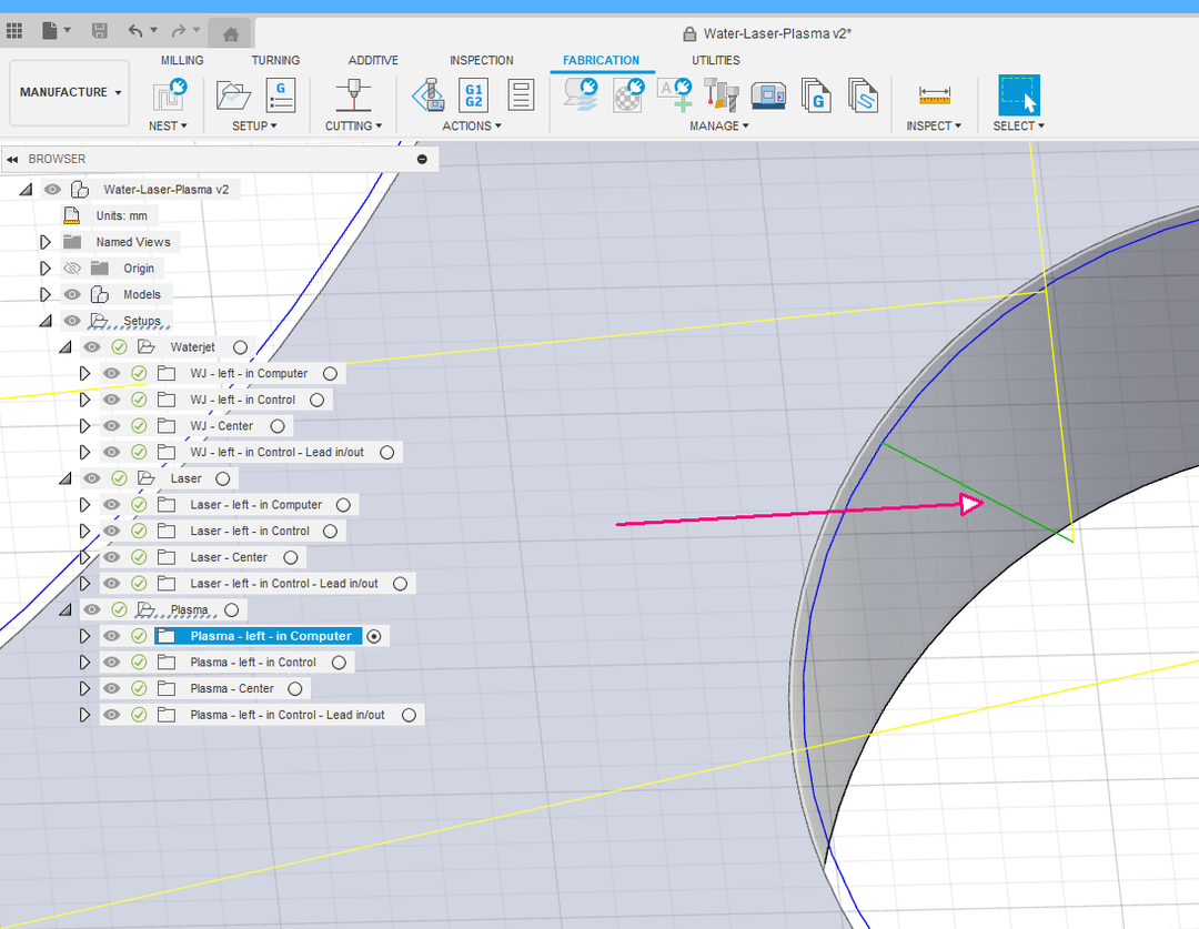

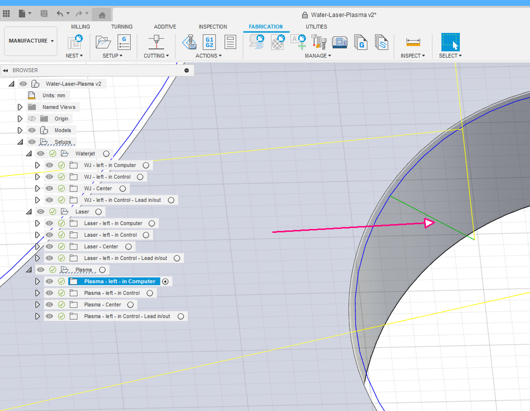

    on the linking tab is 'Pierce Clearance'. This is the HORIZONTAL distance from pierce point to start of cut.
    Pierce Height can be set in either of 2 places.
    a) as part of the tool setttings (best place)
    b) as a pierce height override in the postprocessor options
    this is preferred
    in the image below the 'pierce clearance' green line is pointed at by the purple arrow.
    Pierce Clearance sets the length of that move, which is primarily set the leadin/leadout distances

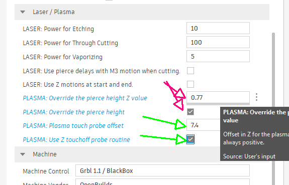

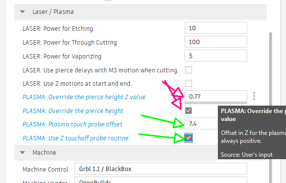

    the primary setting for pierce Height is in the tool library.
    With the OB post you can override it in the post settings as indicated by the purple arrows.
    The green arrows reflect your settings for your probe offset
    T-rav and Peter Van Der Walt like this.

    (Plasma pierce height 0.77) as overridden in the post settings
    (Plasma topHeight 0.1) this is the cutting height set as 0.1mm from stock top in the 'top height' settign in the 'heights' tab
