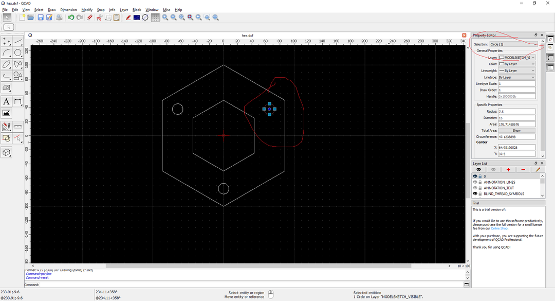

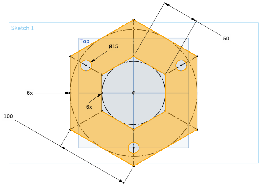

    I am trying to do the CAM for the following onshape sketch using OpenBuilds CAM:

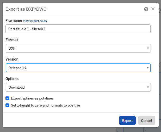

    I export the sketch as a .dxf file with the following settings:

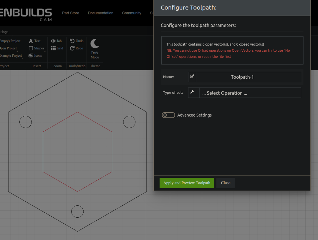

    I open the .dxf file in OpenBuilds CAM and select the interior hexagon (the error is thrown by both hexagons), when I try to create a tool path for this, it says that the selected toolpath contains open vectors:
    According to my design in onshape, these shapes are definitely closed. As shown by the yellow highlight in the first picture, selections of areas in sketches are only yellow if the area is closed in onshape.

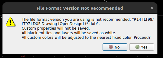

    I tried googling around and tried to fix the problem by opening the .dxf in qcad and selecting all the geometry > draw > polyline > polyline from selection. Then I saved the file as a .dxf:
    While I'm saving the file in qcad, this warning pops up:
    After clicking 'yes' (no file is saved if I click on 'no') and saving the file, I open it in OpenBuilds CAM which fails to open the file with this error message at the bottom of the window:
    I have tried to 'assign' colours in qcad, and from whatever I can glean from the info displayed on screen there's no issue of 'unassigned'/'undefined' colours in the .dxf. I tried my best to reproduce the steps I took in qcad in librecad, and that too results in OpenBuilds CAM throwing the same error.

    Hi, I've managed to fix my problem.
    Solution: Export R14 DXF from Onshape > Open it in Inkscape > Select all entities by pressing Ctrl + A > Ungroup all selections by repeatedly pressing Ctrl + Shift + G > Select the Node Tool (with all entities still selected) > Press Ctrl + A again to select all nodes > Click on 'Join selected nodes' > Save the file as (Ctrl + Shift + S) an R14 DXF

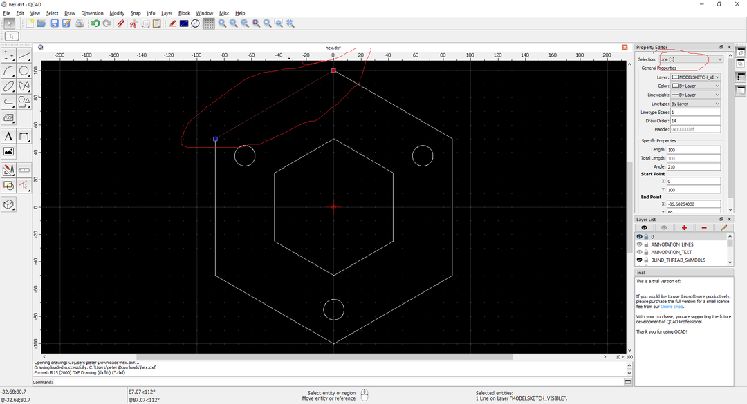

    OpenBuilds CAM is not wrong, those aren't joined up closed shapes
    You can see its all seperate LINE segments, they aren't joined together into a closed path/polyline at all
    Same for the Circles
    You can see, they are still of type Circle not Polyline...
    Got to join (weld) those loose segments into Polylines, and convert all non-polyline entities to polylines
