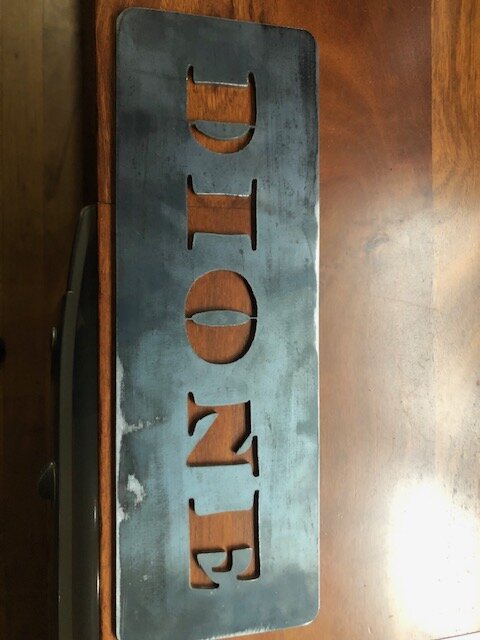

    Hello All
    I have built a JD Garage plasma table which has gone quite smoothly. I have had some issues with electronics and software which i managed to resolve where everything seems to work as it should. The issue im having is the little glitches in the cut. I have supplied a pic with some arrows where the issues are.
    The gcode file for trial is supplied with the instructions from JD and is known as good.
    Im not quite sure where to start looking for the solution here.
    Hopefully someone here can point me in the right correction
    Mick

    that is backlash, either X or Y is flexing for a bit until it 'catches up'.

    Hello David. Excuse my ignorance, but the comment "backlash and flexing" are you describing issues in the belt drive system.

    something is loose such that when pushing against the cutting forces it flexes one way then after a bit it overcomes the cutting forces and cuts whee it is supposed to, thus the wobble.
    which way round was it cutting? if we know that we can know which axis is flexing.
    the flex can be: (but not limited to)
    loose belts
    loose wheels
    set screws on pulleys, one must be on the flat on the shaft, both tight
    axis not attached to end plates properly
    grab the bit and try to move it by hand (spindle off of course), you should be able to feel which way to can move a bit and then go stiff again.
    also, search these forums for 'backlash' and such words, there have been many discussions

    Looking at the picture the letters start at the pierce point and run clockwise.The outer oval cut starts on the right and runs clockwise as well.
    Will check all the hardware again but this was my first thought of where the problem was.
    Will also search the forum as well

    Mick, did you ever figure it out? I just got done with my plasma cutter build and I'm having problems too. My issues look exactly like yours. I know my wheels are loose on my Y gantry so I'm hoping that's just my issue.

    thanks, ,.looking at the J we can see that the head is cutting left to right and moving bottom to top to do the curve, then X stops moving and Y continues until force builds up and X 'catches up' leaving that kink.
    the same , in the same place on the D and G. This points to something stuck to a wheel or blockikng a hweel, on the X axis.

    I had checked all the gear screws at the time and all were tight. As I was pulling the machine down to paint, fix some issues i didn't like i thought i would double check everything with final assembly. Only finished this machine off last week. With no issues. But everything i was told and read said drive issue. I made a big point of belt alignment.

    Mick, I pulled my machine apart and discovered my X axis pulley had slipped on the shaft. Went ahead and applied red loctite to it and all other pulleys, then cranked down the set screws. Going to do another test cut and will let you know if my problems are fixed.

    Yes, I too had that exact problem on my table (which only started out as a JD's Garage build -- ended up a whole lot larger & more complicated.) -- and that was also my fix. Worked like a charm -- it seems that small steel set-screws in small aluminum gears just won't stay tight without Loctite Red.
